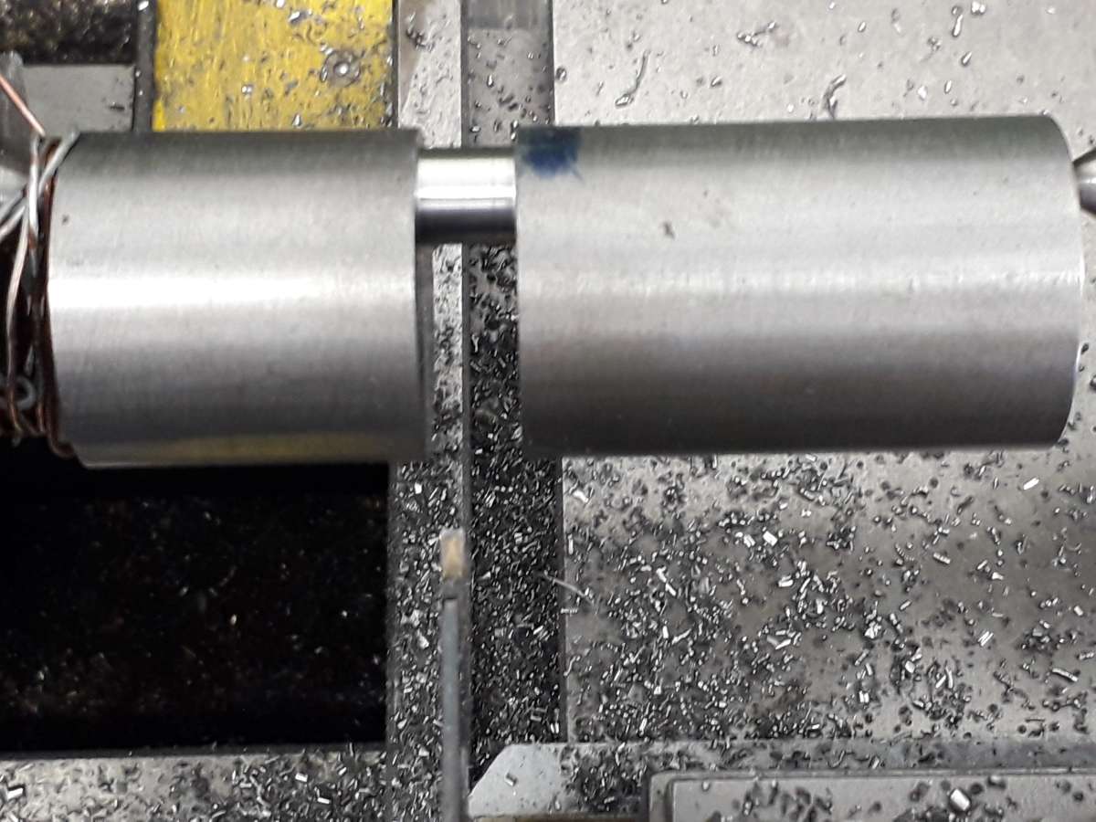

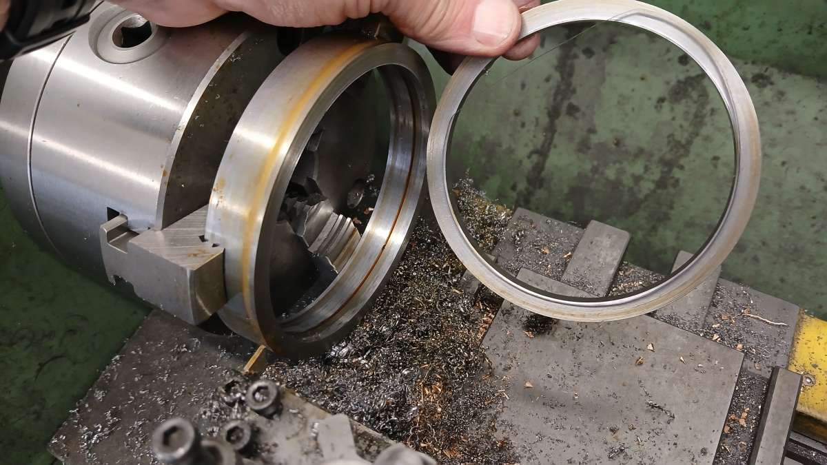

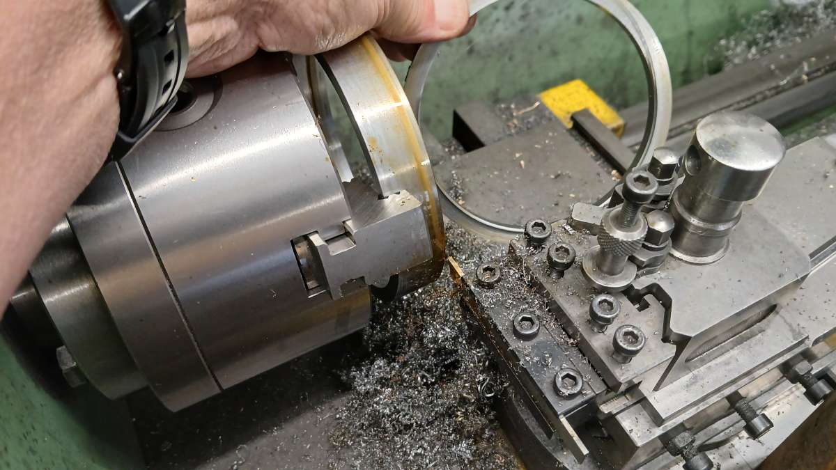

                    I find the GTN-2 work OK on my lightweight Chinese machine on steel and cast iron. I don’t bother with a rear toolpost and even hang it off the side of my QCTP.
                    Did part of some 115mm thick wall tube today but just went with a cheap import 1.5mm HSS tool as it saved a bit more material that I may have a use for. Quite happy at 200rpm.
