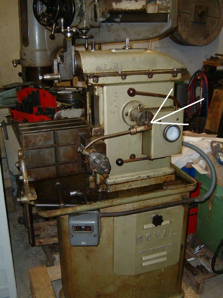

      Has anyone got any dating information on Royal shapers ?
      I have just aquired a 10" shaper serial No.R857,
      It's an interesting machine with power feed to the table, in both right and left , and also up and down directions.
      Richard.

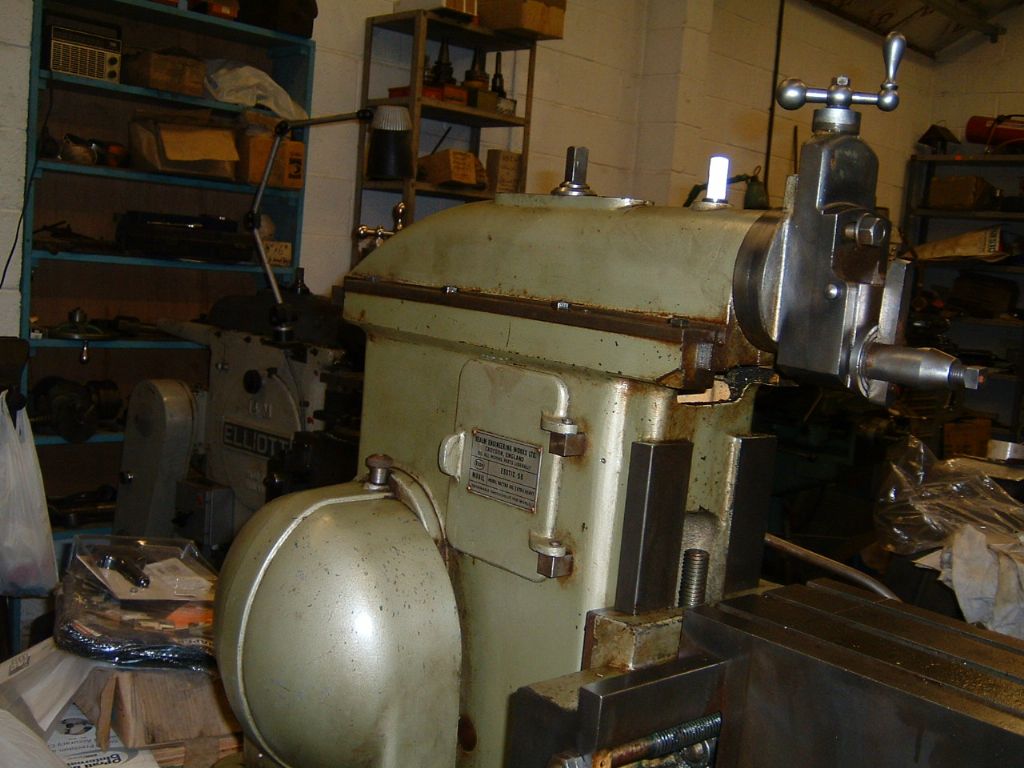

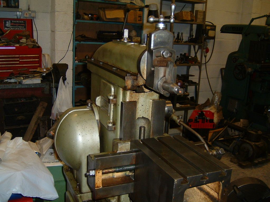

        #183466
        RICHARD GREEN 2
          @richardgreen2
          Here are some pictures of it.

          #183470
            Richard,
            That does look a useful machine.
            Sorry, I have no info. but you may find it worth a look at this previous thread.

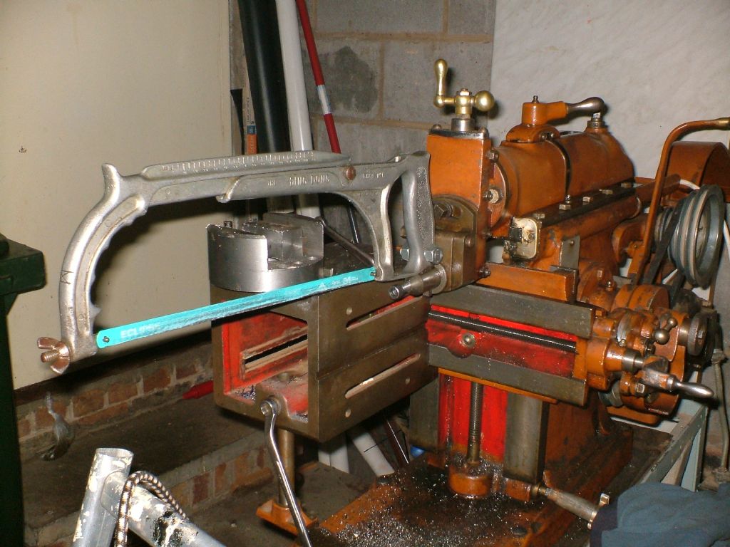

              I'm currently putting a scratch built hacksaw machine together but needed something for chopping up metal in the meantime, I'm fed up of chopping metal by hand so…
              It only took an hour to put together this lashup, the bungee cord at the bottom of the pic provides downward force
              Shapers are brill

                  #183486
                  thaiguzzi
                    @thaiguzzi
                    # The 10" Royal is a very good shaper, especially with the front table support.
                    # I believe the Alba 1A, Royal and Elliot 10M are basically all the same, and from the same family of shapers, just updated. Probably similar maintanence and lube points. Plenty of 10M literature available free on the net.
                    #The vertical power feed for the table is rare, and to be honest, not that useful, certainly not as useful as power down for the tool slide.
                    # My 8" Boxford has the rare vertical table feed and after having a play when i first got it, have never used the feature since.

                      #183516
                      IanT
                        @iant
                        Well I guess you would know that the table feed was always truly vertical Thai.
                        You could then have the top-slide set over to some other known angle (and leave it there) and still cut vertically using the table feed (probably have to move the tool/clapper though) – so it might be useful on some production runs. You can do this manually too of course.
                        But I agree a top-slide power feed would generally be more useful although I'd have to stand and watch it (which I don't always do on normal traversing cuts) – so I may as well also 'twitch' the down feed whilst I'm doing so… I think I'd prefer a tilting table on balance – but again it's not something that I can't live without.

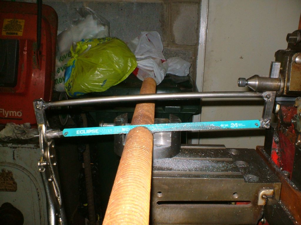

                                  So impressed was I with that lashup I've knocked up a dedicated hacksaw
                                  It needed to be narrower to fit into the work envelope of the machine but the duty cycle of a small shaper is 24/7 and you can simply walk away and do summat else, returning every 5-10 mins
                                  A 10 mm roundbar has a 12mm squarebar at each end. On the end on the squarebar is the gubbins for the blade which is simply me copying a proper hacksaw, everything has been welded together
                                  I broke 2 new blades testing for the best cutting direction, 2 beautiful eclipse blades! I thought that the draw stroke would be better than the push stroke but no, the push stroke worked best, the CRITICAL bit is that the blade just lifts at the end of the push stroke (via the clapper) and lifts the blade slightly for the backstroke. You can see how the saw hangs downwards from right to left
                                  You can watch this "lift" increase as the blade cuts through the workpiece and you screw down the topslide to work your way through a bigger job
                                  Eclipse blades are incredibly strong and durable, you can see how the 10mm roundbar has become bowed by the amount of pressure one can handle as I tightened the blade up
                                  Only a light weight is needed, as can be seen from the molegrips hanging from the end. The shaper is on the next speed up from "slowest" which is plenty fast enough for my liking, a wee dod of oil on the cut at the start keeps things smoother for the session
                                  Cut accuracy is only medium, I would say that you would need a system of enclosing and gripping the blade in a vice type cover at each end to stop it flexing while it works, mounting pins alone are not sufficient
                                  Does a great job of cutting stuff up tho
