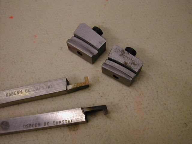

                Hi Pete,
                I don’t know if his will be of help but I modified my MES rotary table for stops some time ago
                I cut a tee slot into the edge with two slotting lathe tools and made curved stops.
                The stop block is a piece of cast let in to the base. Work very well indeed and solves the problem of counting turns, marking with felt pen, and of course the coolant problem but like KWIL  I usually cut dry or use coolant applied with a brush – depends of course on what you are cutting and at what rate. Whatever these couple of pics may be of help …….
                Hope they are of use – good luck

                  Thanks for those ideas Ramon. That’s a proper job!
                  I’m a little apprehensive about mounting the 10″ table on the lathe to cut the grooves. It sounds very scary to me. Radially drilling on the mill does not seem quite so onerous.
                  Those pictures show me what I ought to do.

                    Ah Pete you have a point but I did remove the table first and it is only 6″ dia!
                    I would have thought that drilling and tapping a series of holes in the periphery for two screw in pegs which could then have a fixed bar with adjustable stops either side between them would do the same thing. The mods above slowly ‘evolved’ – the fixed bar was fitted first and for some time the ‘stops’ were a pair of toolmakers clamps ‘strategically’ placed. A pain at times but it worked for quite a while before finally a job arrived that needed proper stops.

                          Hi Pete just seen this – been and measured it …
                          The slot is 8.1  deep from the outer face. The width is 5.8.
                          The ‘tee’ width is approx 11 and the top flange (?) is 4 thick.
                          The tee nut is 10.7 wide by 20 long with the upstand 5.7 wide and 3.9 high. the base (tee width) is 3.3 at it’s widest part
                          The inner most part of the tee nut is flat but the outer and bearing  faces are curved to match the radii of the slot and outer diameter.
                          The stop blocks are just machined to the same radius as the outer diameter but will twist when slack which can be a bit awkward when setting up. If I made some more they would have a register to fit the slot to prevent this.
                          The tools by the way were gashed on a surface grinder but then ground free hand and have a cutting face of 2.6 wide by 3.1 deep
                          I made the table about 1980 – the table slots were cast in originally and were rather large and a bit rough so were machined out at a later date at work when a suitable tee slot cutter materialised
                          Hope this helps  bit more
                          Regards – Ramon

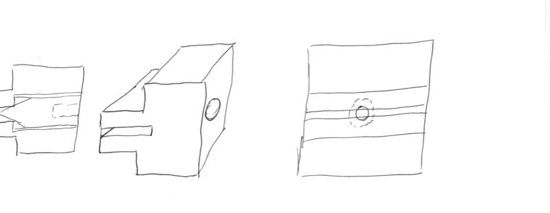

                              Pete,
                              May I offer this highly detailed CAD drawing of a stop that utilises only the parallel sided slot you already have ?
                              Basically it’s a tee shaped tenon that fits your slot in the side, the tenon has a saw cut and a hole drilled thru it then opened out and tapped.
                              A tapered grub screw is then inserted and this will force the tenon apart and so grip the sides of the  original slot.
                              John S.

                                Thanks for the idea John.
                                That could be a short term solution, whilst I gather some courage (and tools) to machine the table.
                                My first thought would be to use an M5/M6 caphead with a turned taper, or have you deliberately used a grub screw to restrict the amount of sideways pressure that could be exerted on the casting?
                                Thanks again
