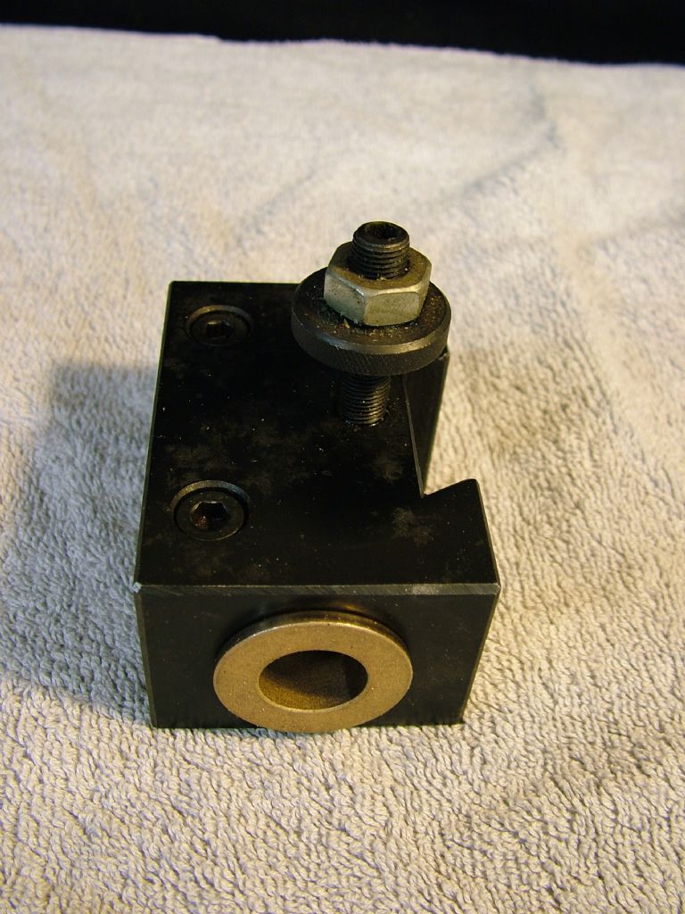

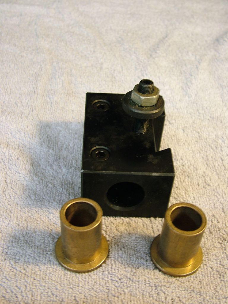

                                      By a complete coincidence I ordered a couple of phosphor bronze bushes (which came yesterday) to make my version.
                                      Owners of the T2 style toolpost set will recognise this item
                                      and with bush fitted.
                                      It hardly counts as a build smile p
                                      David.
