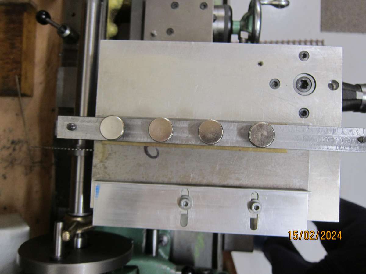

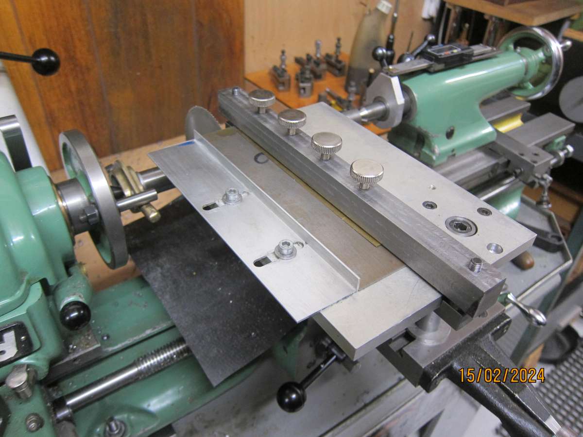

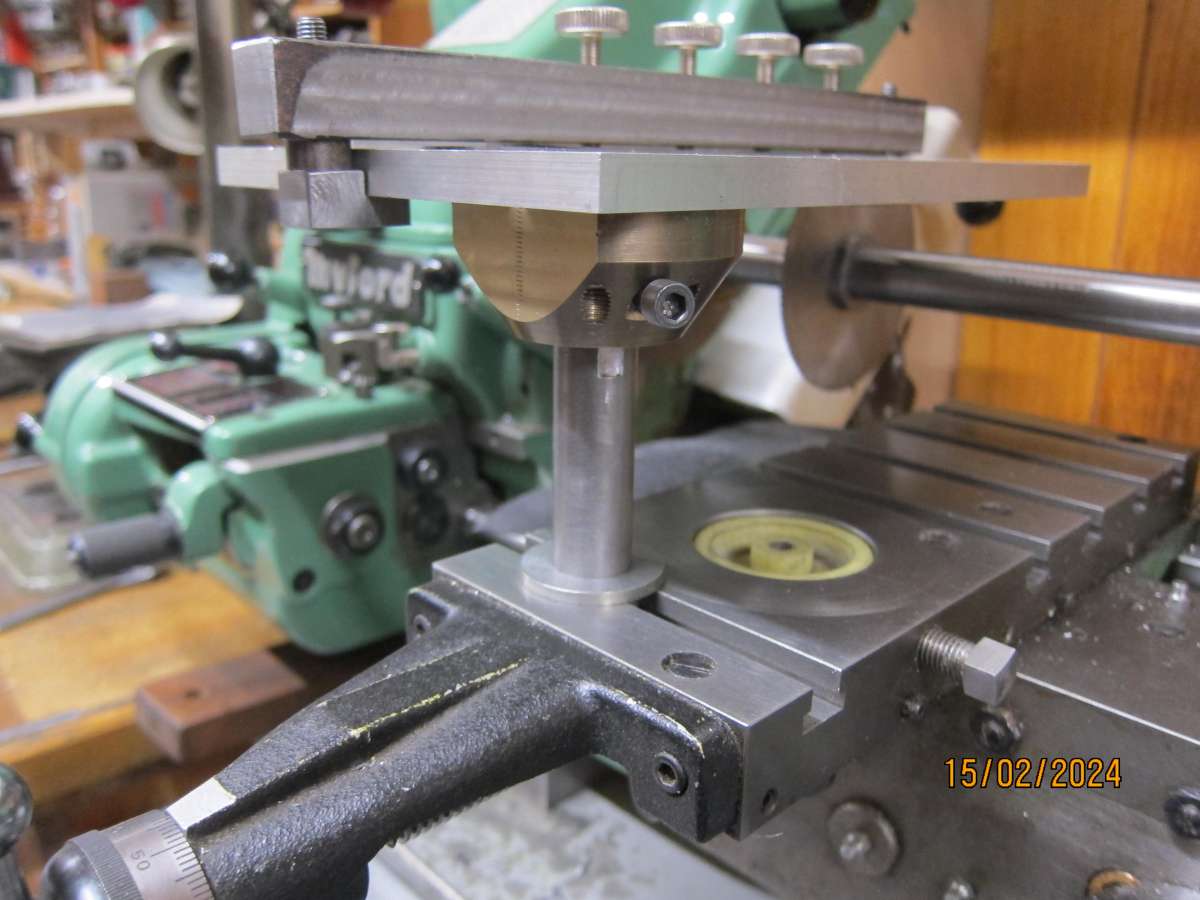

      Hi – I have made up a saw table for use on my Myford S7 lathe but in its current configuration it is failing to provide the rigidity required for the sawing thin strips of BMS sheet stock. The photos hopefully show the current set up which can be summarised as follows:
      1) Saw Table: Aluminium plate measuring 8.5”x6”x 3/8” thk.
      2) Single support pillar: 3/4” dia BMS rod clamped to the front cross slide slot using a 3/8” dia socket headed screw backed up by a 1/8″ plate washer to help distribute the load.
      3) The table is clamped to the pillar by two ¼” BSF screws located on flats milled on to the pillar.
      4) Saw Blade: 4” dia x 1/32 x 1” bore fine tooth saw
      5) Cutting speed: Lowest back speed
      Twin Vice MachiningJPG (2)Twin Vice MachiningJPG (3)Twin Vice MachiningJPG (4)Twin Vice MachiningJPG (5)Washers
      6) Test piece: 1/32” thk BMS clamped to the table by 4off 6mm thumb screws
      My initial thoughts suggests that the problem must lay with the use of a single support column space too from back from the cutting action but then from inspection of some photos of the pucker Myford unit would indicate that although the clamping arrangement is a much more massive affair, the table is still being supported by a single column.
      I would welcome any suggestions and guidance from others who have made up their own saw table for use on the Myford together with any recommendations for a suitable type of slitting saw.

          I have not made such a thing, but please let me comment anyway:
          Your support pillar looks much too lightweight and has several points of likely flexure, or even potential looseness.
          A single small diameter flange on one Myford tee-slot seems to be asking for trouble.
          Think bigger and beefier … think Gibraltar !
          P.S. __ apart from that aspect, it looks very nicely done

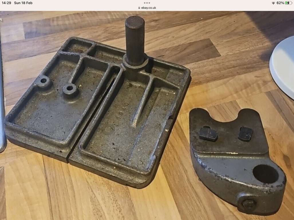

            There is some discussion of the Myford one here:
            Help with Myford Saw Table?
            Comparing the two, yours looks like it is ambitious on the length of cut it can accommmodate.
            You can see the length of the gash in the Myford table. Presumably that is made so that the pillar would hit the arbor once that length is reached. Having a shorter length of cut means less cantilever and more ridgidity. The Myford table is ribbed, increasing its depth and stiffening it.
            Maybe consider some stiffeners bolted to your table, with 1/16″ clearance to the top of the arbor.
            With a good, repeatable fence on the attachment, you could halve the overhang (length of cut), cut halfway through, reverse the piece and cut the other half.
            The Myford one does have a single column but it is (a) steel; (b) greater diameter than yours; (c) shorter than yours.
            The quickest and easiest win would be to replace the column with something bigger and move it closer to the arbor.
            You could try boring a rectangular piece of something the diameter of the arbor and then machining its base to sit (and slide) on the cross slide and its top top to sit (and slide) on the underside of the saw table. The best I can describe its operation is like a cross head bearing.

            Howard Lewis
              @howardlewis46836
              Can only agree with the comments re the small single pillar support.  Bound to wave in the breeze!
              As an absolute minimum install a second one in the slot at bthe other end.
              Preferably, replace the single pillar by a solid support, secured at both ends, to maximise rigidity, or location and support for the table.
              The “Gibraltar” toolpost is a good example of how it should be done.
              Definitely brick mausoleum territory!

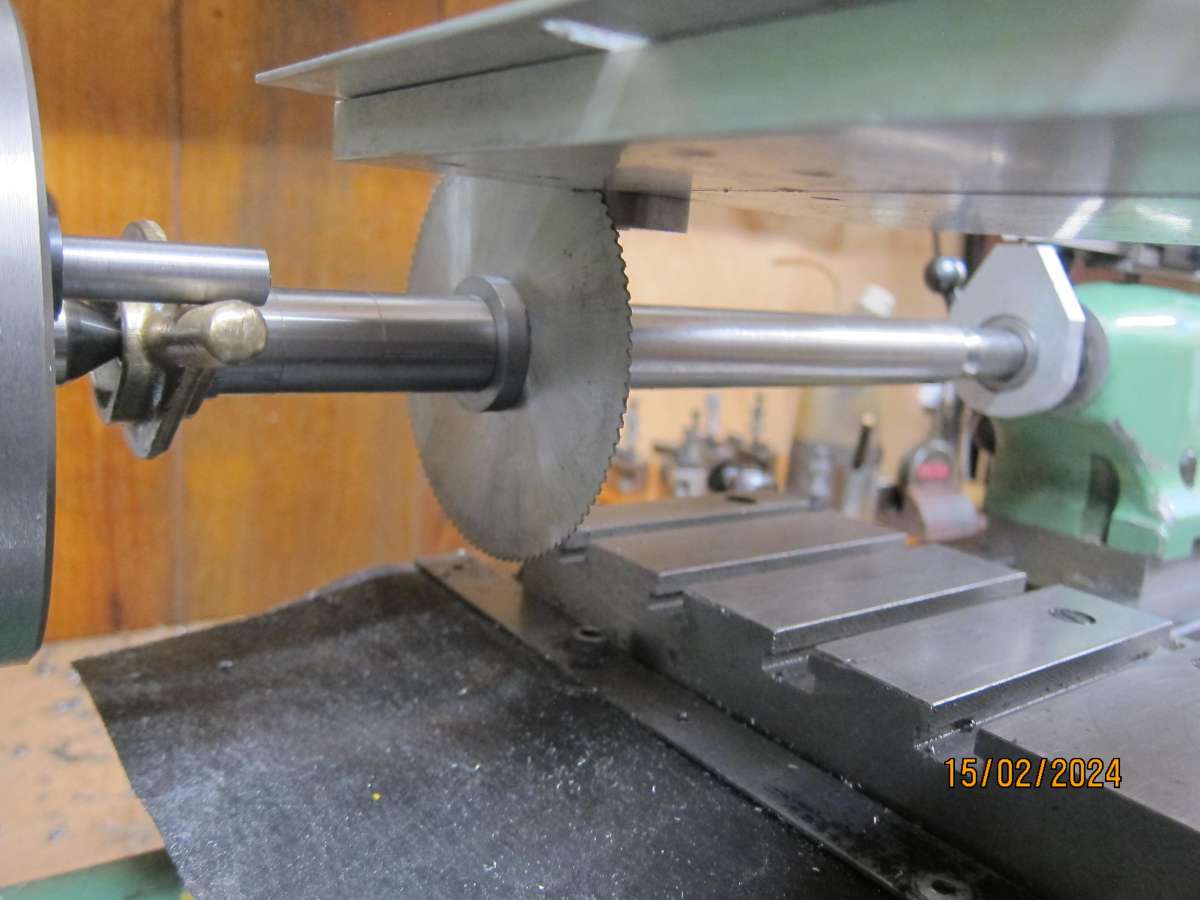

                        Make a “C” shaped support for the rear of the table that passes around the back of the arbour so you can get the full length cut, lower the table so it just clears the arbour and Like Andrew says check the blade is sharp as it looks well worn in the photo.
                        Bolting the table straight onto the cross slide would also be an option and feed from back towards you to avoid climb cutting.

                            You could increase the rigidity of the table itself by screwing two pieces of angle to its underside, to reduce the plate flexing, and extended back to pick up pillars in the rear T-slot.
                            Also modify the pillars, or replace them with blocks, so the table goes below the arbor; and turn the blade round so the feed is against its rotation.

                                        A rear support on the other side of the shaft should sort out most of your problems. As for speeds you really have to see what works. Max speeds are the same as for other machining, but chances are you need to run it fairly slow to avoid chatter. That’s OK, at least with HSS.

                                          In theory I think deflection of a cantilever beam for a given force is proportional to the length cubed. The vertical post can be approximated as a cantilever, as well as the table. As has been suggested, easiest way to stiffen them is to minimise the lengths…. or don’t use a cantilever and support at other end. Support at other end would change the table to a simple supported beam at both ends, and almost remove the vertical post from the equation.
                                          Support at both ends moves the point of max defelction to middle of beam, at 1/4 the deflection of the cantilever.
                                          In practice, make it massive everywhere, supported everywhere. I’m amazed how floppy my S7 and my desktop mill are.

                                                Original must have had the same problems as yours doesn’t look too different to one being advertised on the bay and there are no comments from actual users!!!!
                                                #715102
                                                  I have to say, Bernard … it looks substantially different to me: in several areas, most notably the broad-based attachment to the cross-slide.
                                                  IMG_9342
                                                  Compare fixing arrangement with second photo in the opening post.
                                                      ..also worth noting how little of the ‘shank’ must remain unsupported once it’s home in the lower bracket..
