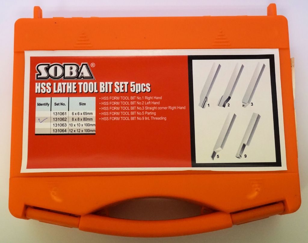

      I bought a R/H HSS tool from Chronos for my new to me Hobbymat just to get me started, or at least I thought I bought a R/H tool.
      Link
      It came through and looking at it in my hand, it's what I would call a L/H tool. A Soba diagram online supports this.
      Chronos has said it cuts from L-R (but are calling it a R/H tool) when I got in touch but have gone quiet when I've asked if they've sent me the wrong one as the description in the link above says Right Hand in it (all their adverts for different sizes are saying this). If I'm honest I've not been impressed with their communications and think I'll put them to the bottom of the list when buying the rest of the tooling I need.
      Is this something stupid like they are know differently between the UK and USA and I've picked up on the American way?

          it's about direction of cut, it can't produce a finished shoulder on the left hand side. So it's for working to the right.

              I used to puzzle over this until someone suggested I should think of having a job to do directly in front of me. If I pick up a tool in my right hand and attack the job from the right hand side and the tool cuts cuts then it's a right hand tool.
              The tool pictured in the link seems to me to be on it's side. If I mentally turn it so that the chip-breaker is on the top where it should be, then the tool will cut from left to right, so it's a left hand tool.
              Anyone else see it differently?

                  This was the Soba picture I found.

                      I would say the one in your link is a Left Hand, compare with any similar insert holder and they will be L/H
                      Other suppliers have the names the right way round

                        The way to look at the tool is as if you were standing behind the late, all will become clear.

                            Jason I agree. It’s a left hand tool because it cuts a shoulder on the left of the workpiece ie working towards the tailstock

                                  If the tool cuts towards the Headstock, it is known as a Right Hand Tool.
                                  If it cuts towards the Tailstock, it is known as a Left Hand Tool.

                                            Incidentally, the ones shown in the picture earlier, although described as "Form Tool", are not really.
                                            Something got lost in translation.
                                            A Form tool would leave it's shape (Form ) in the work, in the way in which a screwcutting, radius, chamfer, or a parting tool does.
                                            A knife tool GENERATES a cylindrical surface as a result of the combined rotary motion of the work, and the linear motion of the tool, or a flat surface by the same process when facing.
