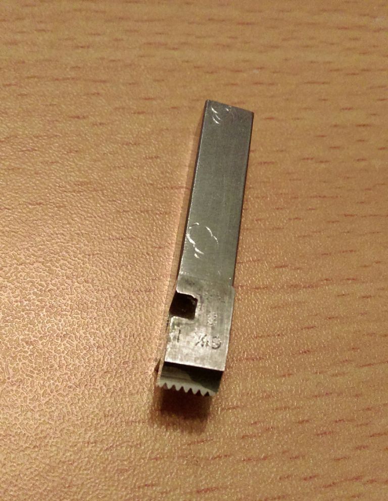

            Get a 6mm bolt, preferably not zinc plated, saw lengthways, weld onto handle, grind and polish.
            #394848
            Chris Trice
              @christrice43267
              Or source a set of HSS die head cutters and silver solder one to the end of a piece of steel. This will cut and "chase" at the same time, handy for cutting other diameters with a 1mm pitch.

                #394851
                Chris Trice
                  @christrice43267
                  It may not look it in the photo but the end is square to the shank.
                  #394854
                    1.0mm full form insert will cut and do the rounding in one setup.

                      Ray I have a lot of thread chasers that I aquired of various pitches,if I have a 1mm pitch you can have one.I will look tomorrow and inform you if I have one.I have used them with all but one of the teeth ground off for thread cutting ,it saves grinding a tool to shape and is bound to be right.
