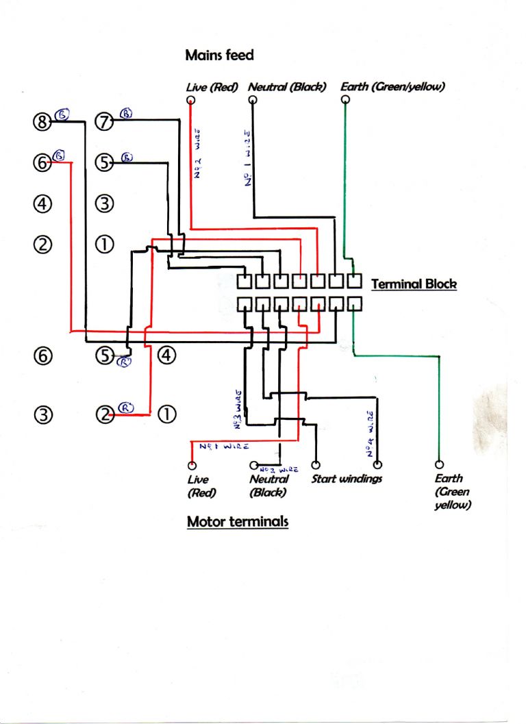

                              I've replaced two Dewhurst switches on my lathe and my mill with this item on ebay. 292412206423.
                              This is a replacement switch sold by Chester.
                              It has stop and start switches and a reversing switch and includes an NVR function.
                              I did these changes several years ago and they have worked with no trouble. I bought them from Chester as they were the only supplier with a switch that did all the functions I wanted.
                              The only thing was they didn't come with a wiring diagram so caused a bit of head scratching. I still have my wiring diagram, somewhere, if it is needed.
                              For your safety it is certainly worth putting an NVR switch in even if you keep the Dewhurst.

                                Thanks for all the responses, especially JonBerk. I have decided to go for the Chester switch as it is a pretty compact unit that I can put where the Dewhurst switch is now.
                                Thanks also for all the offers of Dewhurst spares but I feel that a modern alternative is the way to go.

                                      Here is my wiring diagram. It is a long time since I looked at it, so first of all is a warning, check out your switch with a meter before using this diagram.
                                      Without the switch in front of me I'm going by my, unreliable, memory.
                                      First off you need a box to put the switch in – Maplins do a range of plastic boxes which can be modified to suit. Get one that is deep enough to take the switch and the Terminal Block. The Terminal Block is just a piece of chocolate block connector. You will need some four wire cable going to the motor, preferably armoured if the motor is exposed.
                                      If I remember, the switch came with wires connected, but all the wires were coloured black! The numbers in circles are the numbers on the terminals on the back of the switch. There seems to be some duplicates but why I can't tell you.
                                      I've written in Biro on the diagram but I can't remember why, it looks like they may be wires from the NVR.
                                      Good luck!

                                      Ian Childs
                                        @ianchilds37813
                                        Thanks Jon,
                                        Just received my switch and will definitely need that diagram!

                                          I'm just wiring up one of those Chester switches. The wiring as supplied is as shown in Jon's pic, (minus the terminal block) but in the latest iteration the wires are not all black. The mains input wires are the short black pair attached to terminals 6 and 8.
                                          Be aware that throughout this switch, contrary to domestic wiring convention a red wire does not indicate "live" nor does black indicate "neutral".
                                          The pair of red wires coming from the centre terminals of the rocker switch are one set (i.e. one is live and one is neutral) and are used on one of the two windings on the motor. Similarly the black wires coming out of terminals 7 and 5 are another set for the second winding.
                                          I've used coloured tape to identify the various polarities as in the pic below.
                                          This is the rear of the rocker switch showing the pair of red leads that feed one of the windings on the motor.
                                          To check which of these is the live or neutral, I first wired terminals 5 and 7 (the black pair) to a lamp. With your live mains input attached to terminal 8, terminal 7 is your live to the lamp. The lamp lit when I switched on. Then I removed the neutral and substituted on of the red leads. It didn't light up, so it must have been another live feed. Changed it for the other red, the lamp lit so I'd positively identified the neutral.
                                          It all sounds complicated but when you study the switch unit it's pretty simple.
