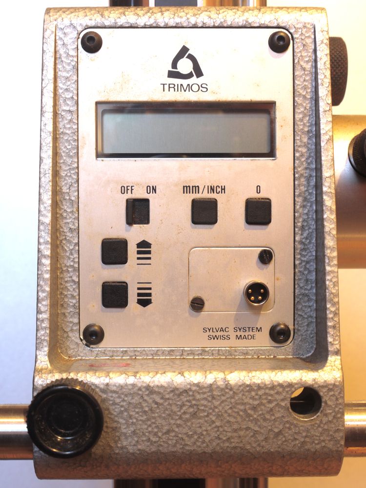

      Posted by Michael Gilligan on 04/12/2013 12:43:09:
      This is a desperate plea …
      < etc. >
      Anyone ?

        Do you have an oscilloscope? On X10 it should be impossible to damage anything. Compare the output waveforms with those HERE.
        You don't need a Tek DSO, my ancient Hameg did the job just fine.
        >edit< This is useful as well, and there is Yuriy's site as well.
        Edited By Stub Mandrel on 04/12/2013 20:51:45
        #137049
          Posted by Stub Mandrel on 04/12/2013 20:42:43:
          Michael,
          Neil,
          1. Yes
          2. TDS200C
          … But I would still like to know the Spec. of what is supposed to be there.
          Edit:
          P.S.  I know what the Sylvac protocol was [please see my earlier posts] but I don't know what the electrical interface characteristics are … and nor, apparently, does Trimos.  They have already told me that if the circuit board gets blown, there are no replacements; and "repair" would involve upgrading to the new electronics [which is almost the same price as buying a new instrument].   I feel the need to tread very carefully! … I suspect that they deleted the connector because the interface was fragile [although no-one has actually said so].
          Edited By Michael Gilligan on 04/12/2013 21:13:47
          Edited By Michael Gilligan on 04/12/2013 21:16:22
          #137055
            Picture of TVM 300 panel, for reference
            #137065

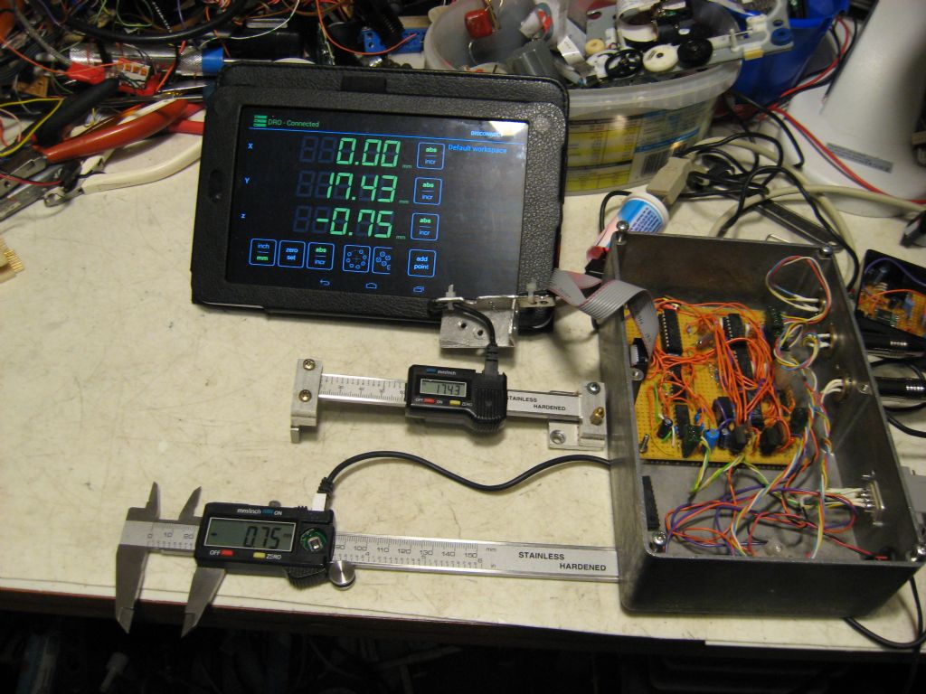

                  #137963
                  Les Jones 1
                    @lesjones1
                    Update on my scale interface to use with Yuriy's Android DRO.
                    I now have it working with BIN 6 protocol scales as well as 2 * 24 bit and 7 BCD
                    Note this picture was taken last week before I added the code to support BIN 6 protocol
                    Les.
                    Edited By Les Jones 1 on 16/12/2013 10:39:18

                                Les Jones 1
                                  @lesjones1
                                  If anyone is interested in Yuriy's Android DRO then I have put details of my interface in my website.
                                  It supports 2 * 24 bit, 7 BCD and BIN6 (HF) type scales directly. It also supports iGaging scales and quadrature scales (Glass scales etc) by using external protocol converters or internal converters built on 8 pin headers which plug in in place of the LM393 comparators.
                                  Les.
                                  #138950
