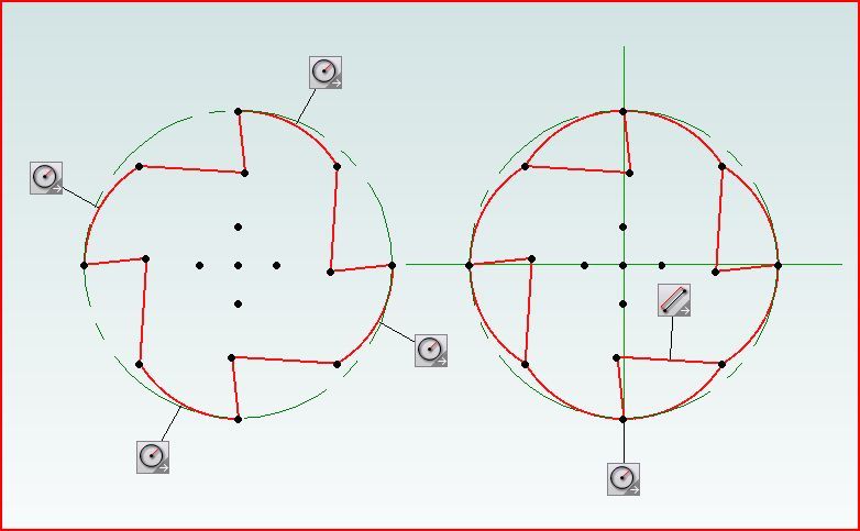

      I have seen a few videos on youtube of relieving attachments in use for cutting gear hobbers. Some lathes come with a relieving attachment. Can anyone describe in a few well chosen sentences what the relieving attachment does and other uses ?.

        #192885
          I think it moves the cutting tool in and out, you gear it to the spindle so it moves to suit the number of teeth per rev. This would be for a 4 tooth cutter, the red outer path is shown on the right and what it looks like with the teeth cut on the left so you get clearance behind each tooth
          #192889
          capnahab
            @capnahab
            If I think very hard I can sort of see what you mean , very nice diagrams , but how do you wind the cut in ?. It must ? come back to the same starting point.
