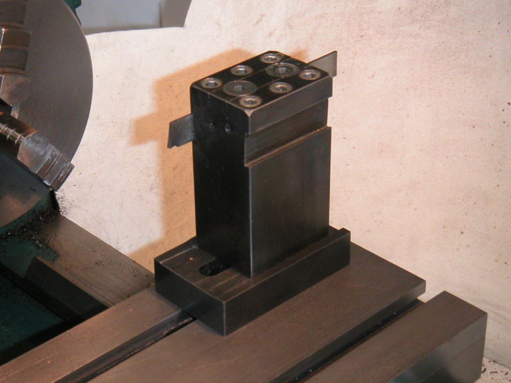

        Trying to make one for my lathe to use hss blades.question is whether to angle the slot for holding the tool ( 7 degrees seems to be the appropriate angle ) to give back rake, or no back rake at all and machine the tool slot horizontal?
        Thanks
        Mick

                    On reflection the type in my photo is the one to make, the centre height is easily adjusted and looking at various YT videos most use no back rake it would seem to me that back rake improves the chance of a dig in and can lead to excessive grinding of tool to maintain thickness of taper as Duncan points out, will post a photo of my effort when completed
                    With thanks
                    Mick

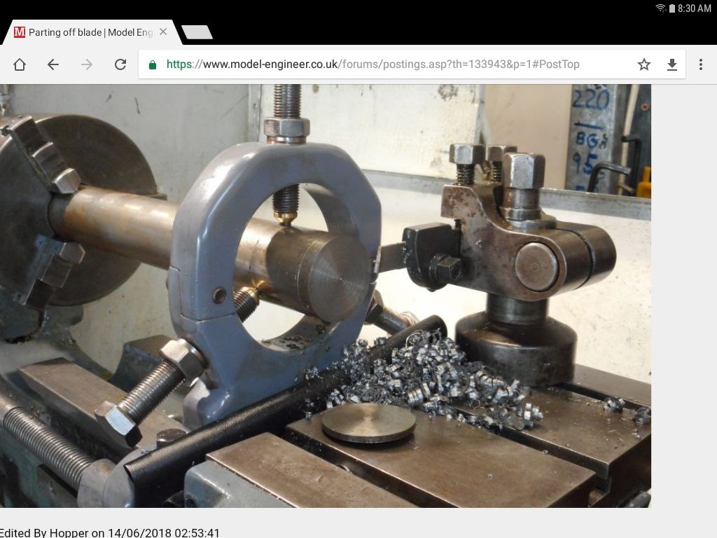

                      Posted by Mick Henshall on 15/07/2018 21:10:07:
                      Thanks Larry,I saw this on a recent thread recently and like the design does allow easy adjustment fo centre height, trying to find more info on itscreenshot_20180614-083012.jpg
                      That's my rear toolpost. Glad you like it! But sadly I can't tell you much about it. It was apparently made by a previous owner of my Dad's old Drummond M-type. Looks to have been well made, possibly on a larger milling machine (foreign order at work maybe?).
                      It is based on the concept of the patented Norman tool post that came standard on the M-type, with the large diameter upright post and the toolholder that slides up and down it and clamps in position. I also have a Duplex/GHT-style rear toolpost topped with a fourway toolholder that holds the same parting tool and it works just as well.
                      But the old one does work very well, as the pic shows. I don't grind any back rake on parting tools, ever. Just use them flat. I do very lightly grind the top (er, bottom in this case) of the parting blade nice and flat as they sometimes come with a slight angle on that edge. That way, the tip is the same width as the rest of the blade. I do this with all of my several parting tools, all of which are mounted level with no back rake. They all work well.
                      I am currently (slowly) making a Duplex/GHT-style rear toolpost for our Myford that will have the parting blade held directly in the toolpost, just to simplify things. Using a T section blade from Eccentric Engineering. That will also be mounted level.
                      The search for the ultimate parting tool continues…

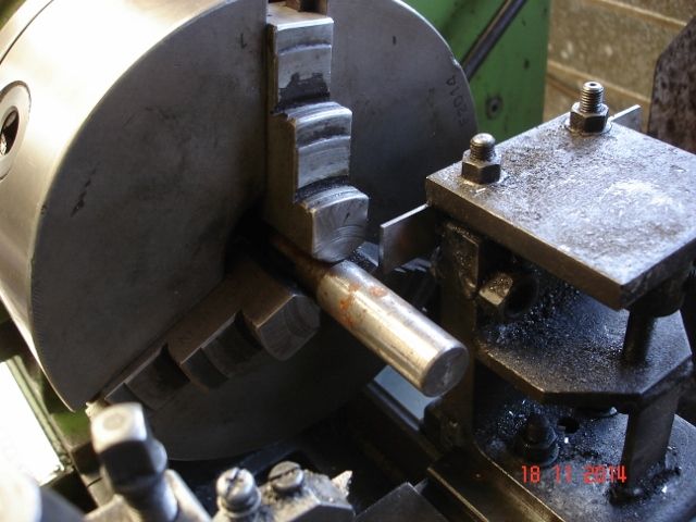

                          My rear tool post is a stretched version of one in an old ME, its welded up from scrap steel.

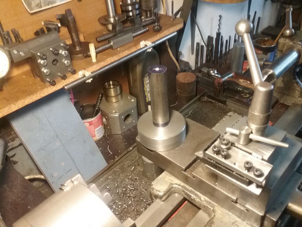

                                  Thanks for comments thus far,all very interesting. Started my own version,base is 3" diam x 1" thick, pillar is 1" dia with end let into 3/4" hole in base. The base will be secured with two cap heads situated each side of pillar which in turn will be held with an M8 through stud to another t nut, the toolholder probably 2" x 2" square of bms, still to design. I have made as chunky as I can Mick
