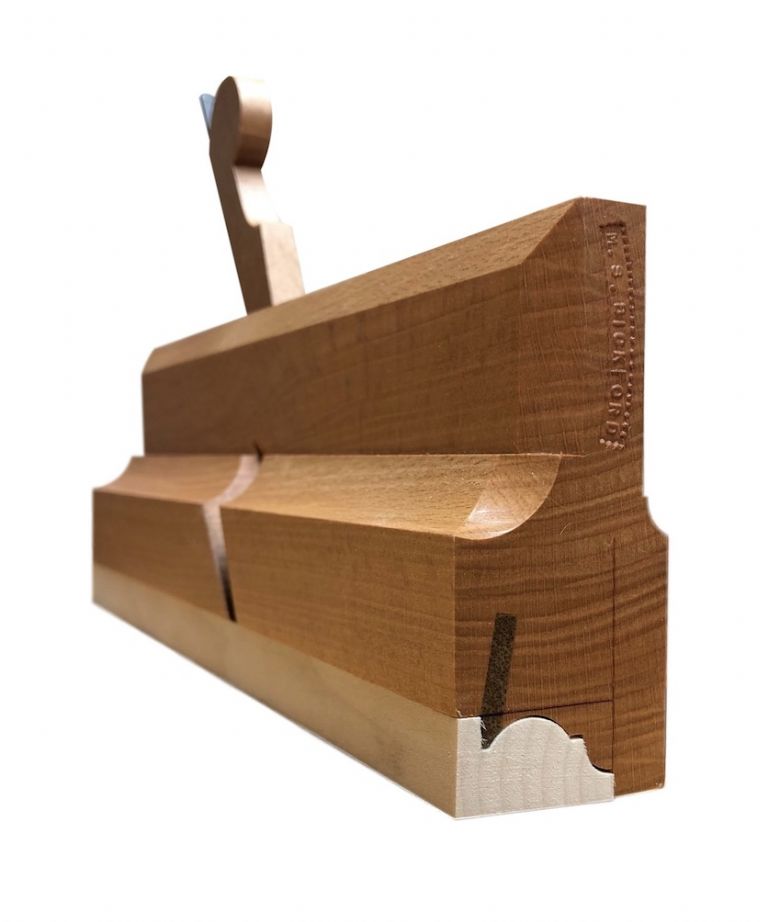

      I have recently been trying to make a set of radius sanding blocks (for woodwork), in fact the subject of a recent post I did on casting. I’m stuck in a hotel for the weekend, so I’m busy drawing up the 3-D printing designs for all 16 sanding blocks I need.
      I have a question that I think probably only a moron would ask, but I’ve been thinking about it too long and I’m going around in circles (no pun intended).

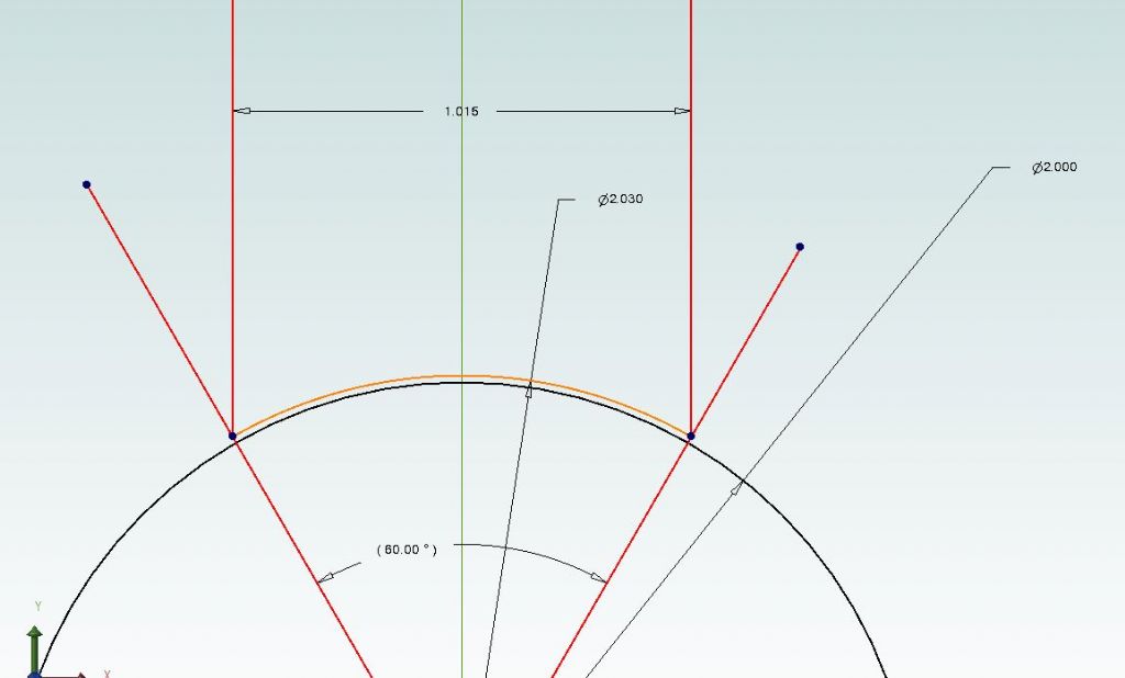

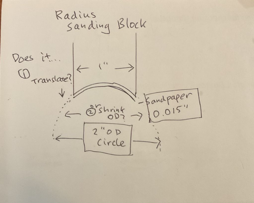

      For example, a particular sanding block needs to precisely sand a 60 degree radius of a 2 inch circle – which happens to make the block exactly an inch wide. But I need to take account of the sandpaper, which is 0.015” thick.
      The question is, does the addition of the sandpaper to the block:
      1) simply “translate” the 2” radius on the sanding block by 0.015” or
      2) create the next 0.015” ring of a concentric circle, meaning that to create a sanding surface of exactly 2” od , I need the sanding block to have radius 2”+0.015”.
      it seemed obvious to me that the answer was (2) but the more I think about it I’m not sure!
      Pic below hopefully explains. Feel free to tell me I’m a moron.
      Steve

          IF it is imperative that the radius of the wood is EXACTLY 2", the the block needs to be machined to 2.015" concave radius, (4.030" Diameter )  so that when the sandpaper is attached, the surface of the sandpaper that touches the wood will then be 2".
          If the object is to produce a convex radius the block needs to be machined to 1.985" radius, so that when the sandpaper is attached the surface touching the wood will be 2" radius.
          In practical terms, how long it will stay 2" radius may be a moot point, if we are chasing thousandths of an inch.

            Thanks Howard, I’m not going mad, that’s what I thought.
            I know it may seem obtuse to be chasing thousandths of an inch in woodworking, but it is for sanding a plane sole. The thickness of the shaving it can take (needs to be 0.001 ish) is defined by the flatness of the sole If I’m going to make a sanding block that is that accurate longitudinally, I may as well make sure the radius is as accurate as possible too, so the plane is an accurate tool.
            my original idea was to cast these blocks in brass for stability, I still haven’t completely given up on that!

                  Simple answer … Your instinct was right
                  BUT, as Howard has observed, you are confusing Radius and Diameter

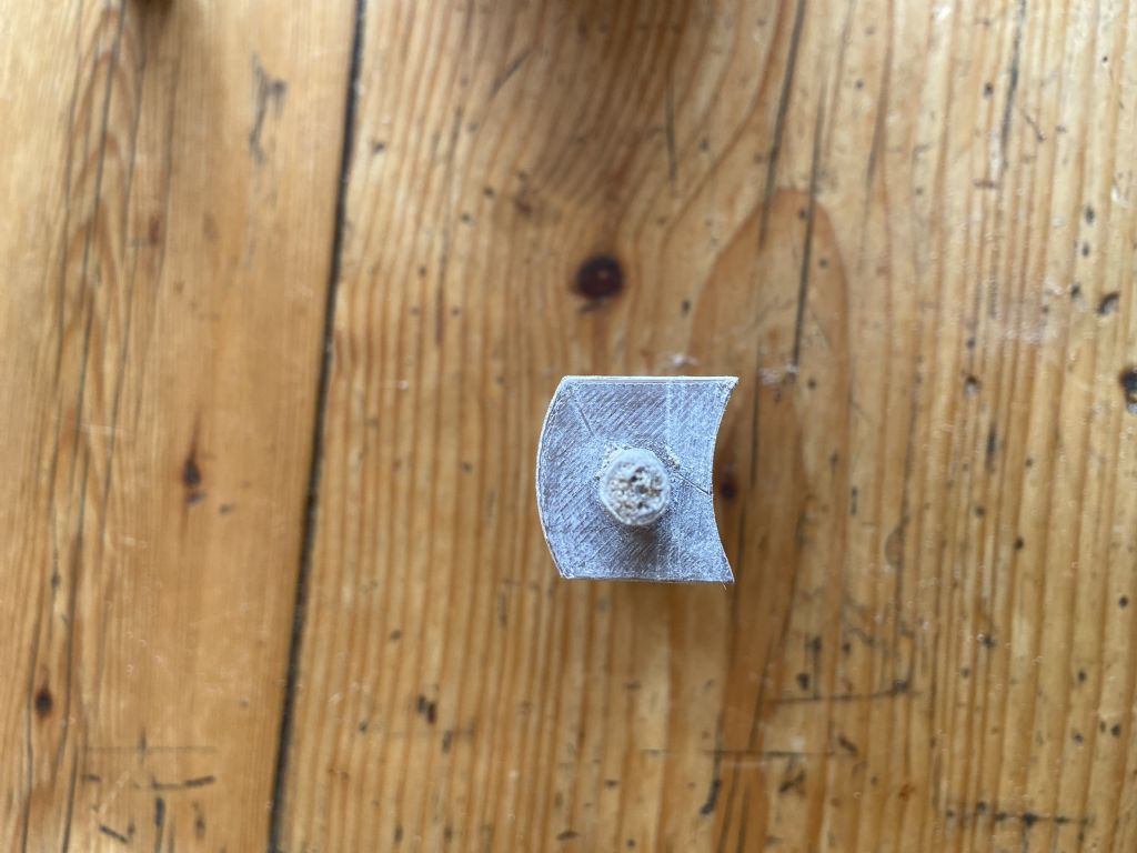

                      #605196
                        Also if working to thous then you will also need to increase the width of your block to fully support the abrasive as the larger radius ark will mean the block width increases.

                          Just pointing out that if you have trouble imagining the change in radius again think about what would happen if you added a layer of sandpaper to the inside of a pipe with a 2" bore. You would not expect the bore inside the sandpaper to still be 2" would you?
                          Martin C

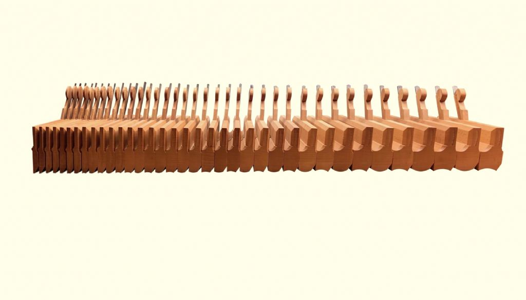

                                  With 16 plane to make I'd be looking a knocking something up to rotate the roughed out wooden blocks against moving abrasive, with a movable pivot so you can do different radii.
                                  If you have a lathe I would cut the concave face of the sanding block with that, more likely to give the numbers you want without having to allow for under/over size prints, casting shrinkage, surface finish on print or casting, etc
                                  It’s 32 planes…
                                  I have already made 11 of them but stopped at the point of profiling the soles for 10 of them, as 3d printing a sanding block massively helped getting the first one to work properly.
                                  You are right that it would be useful to make them oversize. But I want to use them to make other planes, and certainly for the concave blocks, I wouldn’t be able to get into gaps – see pic.
                                  On the casting, it didn’t go well, but I learnt a lot. You are right about the surface finish and shrinkage. If anyone has any practical ways of milling or turning these shapes, I’m all ears. I think in the end I might just use 3d printed blocks. They are accurate and stable enough. I’d love to have them in brass, but unless I stop somewhere with “making the tools to make the tools to make the tools” my wife will never get her greenhouse and my son will never get his sash window, which in the end is what all this is for, in the end.
                                    The width is set by the sole of the plane. Interesting point though, I will bear that in mind today when doing the drawings.

                                      That’s a very useful way to visualise it, thanks.
