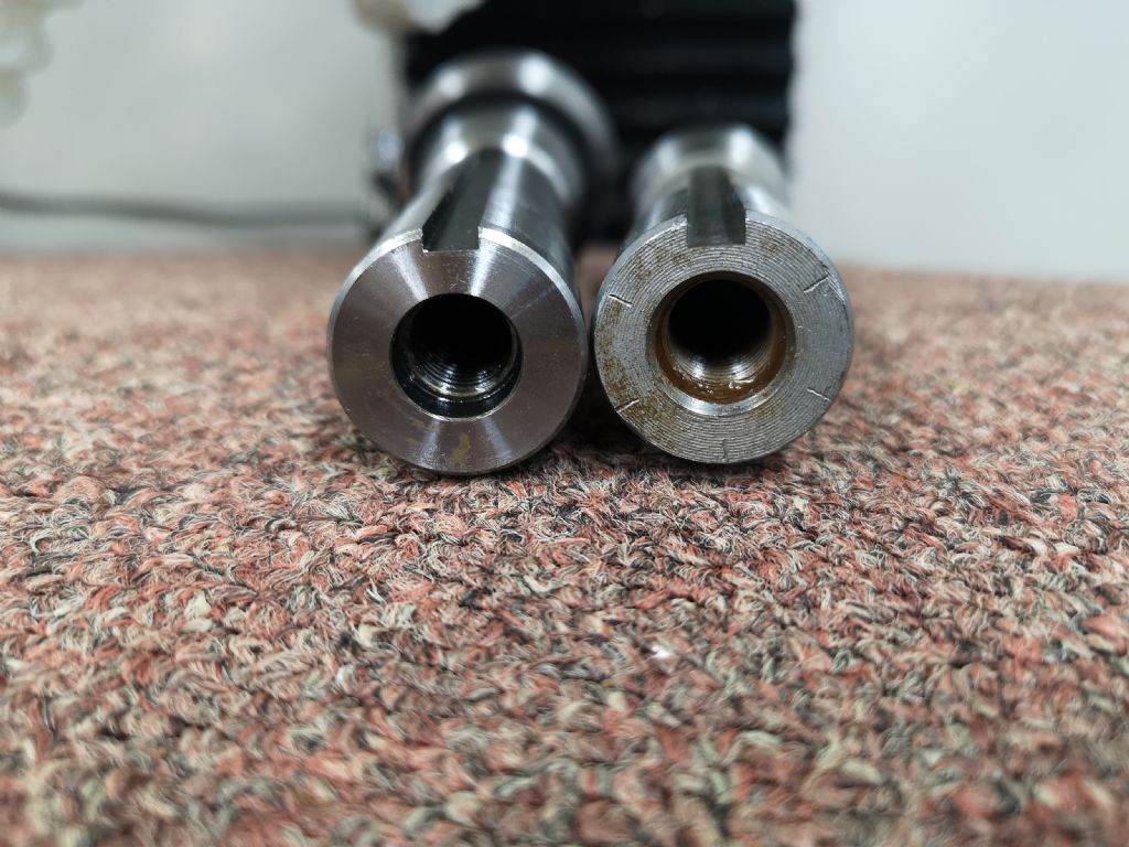

        Anyway, I've just tried to get my R8 ER32 collet chuck mounted and it won't! Pretty pleez take a look at this pic and tell me which keyway is correct, new chuck on the left or Warco supplied arbour on the right (which does go in the quill). There's a good old difference in depth there. All I can feel about 60mm up inside the quill is a single pip, not a key as such. I suppose I could get a file up there but should I?

          Pip is the end of a grub screw, try unscrewing it slightly as your ER32 shank looks to have a shallower slot.
          #547210
          Anonymous
            The "pip" is a dog point screw; it isn't a key. It's purpose is to stop the R8 taper turning while the drawbar is tightened. It's more trouble than it's worth. If possible take the screw out and recycle it. In my experience import R8 tapers often have problems with the keyway not being correct.
            Andrew
            #547212
            Emgee
              @emgee
              Terry
              I believe the R8 groove spec calls for .094" depth, but isn't it possible to unscrew the peg to allow the shallower groove depth tooling to be used. ?

                Keyway depths appear different, if the ER32 was same depth I doubt there would be a problem. Dave W

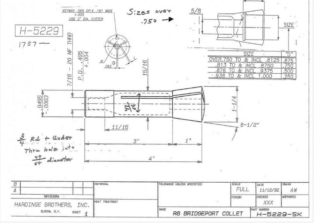

                  Hardinge have the groove at 0.065" to 0.070" deep
                  Edited By JasonB on 26/05/2021 14:12:49

                    Wow, thank you All gentlemen for the very prompt responses. I didn't have a clue what was up the spout, so I'll go and see if I can unscrew it now. Once again I am deeply impressed by the help available on here.

                        +1 for Andrew. I took the grub screw out of my mill a few years ago. Never had a problem.

                          Since reaching the screw to adjust the stickout could entail removing the spindle, it might be easier to carefully reach it from inside the spindle and file it shorter. A Dremel might take a little off the end, say 0.004", 0.1mm at a time until the new tool fits. Make sure any filings are cleaned out very well afterwards.
                          I purposly left the R8 conversion for the Tom Senior light vertical unfinished, the hole for the pin/screw was not drilled right through into the bore. This is better and the only time it can cause problems is when an R8 collet is used, because there is nothing to get hold of. As long as the threads for the drawbar and all the threads in tooling are free running and lubricated, there is no problem. Without the pin, you can clean the taper section of the spindle with a BT30 cleaning wand.

                            Also check the diameter of the plain section at the top of the R8 (0.9495" in drawing above ) . I have bought a few R8 collets that would not go in my mill because that part was just a tad oversize for my machine (although still within the R8 spec ). Removing about 0.0005" from the diameter cured the problem.
                            Doug

                                  It would also be possible to hold the tool shank in a vise, with some shim to make up for the middle section being slightly smaller and take a small cut along the slot to deepen it slightly.

                                    Thank you all again! The grub screw is easily reached through the vertical slot in the quill. I've left it in but withdrawn enough to get it out of the way.
                                    However, at first I still couldn't get the final 12mm or so of the R8 chuck pushed up to its seat!
                                    Douglas Johnston, spot on my friend, I had to do exactly the same, the top of it was slightly oversized!
