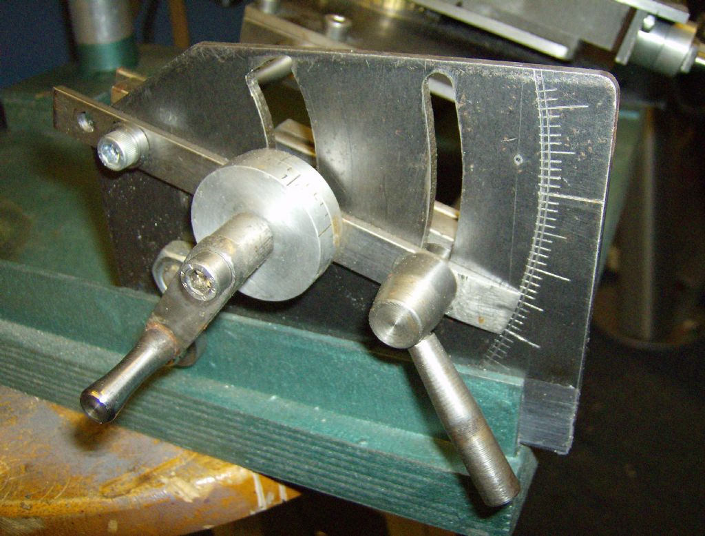

                    G H Thomas' Model Engineer's Workshop Manual says a lot about making the ball handles.
                    I'd make ones to match mini-lathe handles, much simpler but look almost as good. This one at bottom right on my grinder gives the general idea.
                    Table feed and angle adjustment
