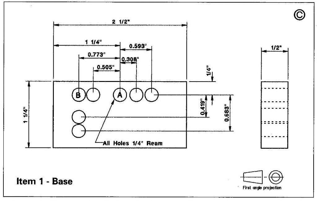

      Hopefully that's of use. I'll upload any others that have incorrect dimensions later.
      Regards
      Andy
      #497200
        Posted by Andy Rodgers 1 on 22/09/2020 11:17:26:
        Regards
        Andy
        That's great Andy,
        I'll link to this thread when I print the corrections as your drawings will be a big help.

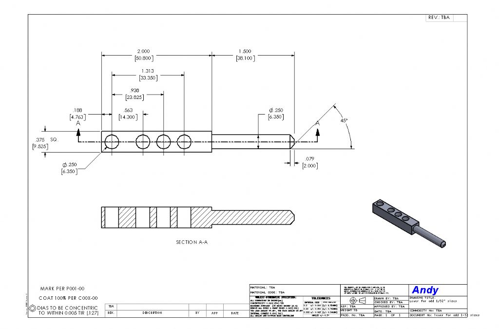

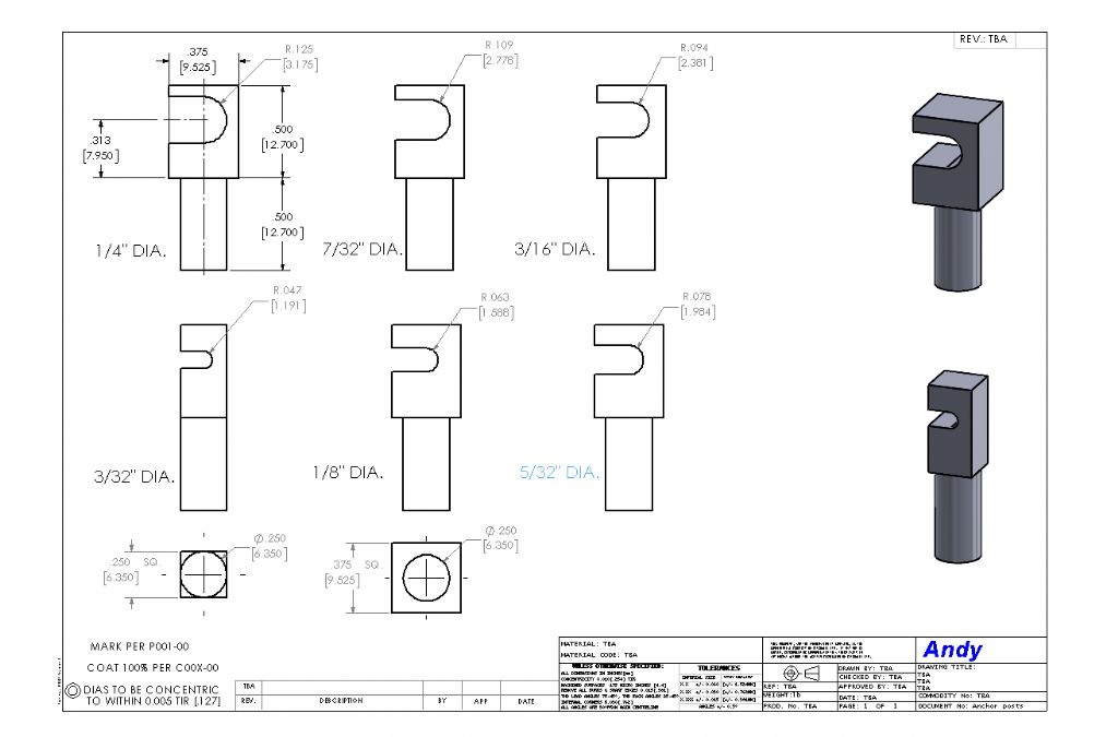

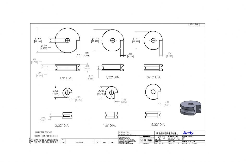

                  Remainder of corrections added thanks to Nick's notes.
                  Regards
                  Andy

                                        The dimension on base in Andy Rodgers drawing shown as 0.413 is definitely shown as 0.419 in original drawing exploded which I have a copy of. Only 6 thou difference but do we know which is correct?

                                            Hi, yes I agree with Andy_C, 0.419" on the original.

                                              Dimension modified as per Nick & Andy_C. Note added per reamed holes.
                                              Regards
                                              Andy
