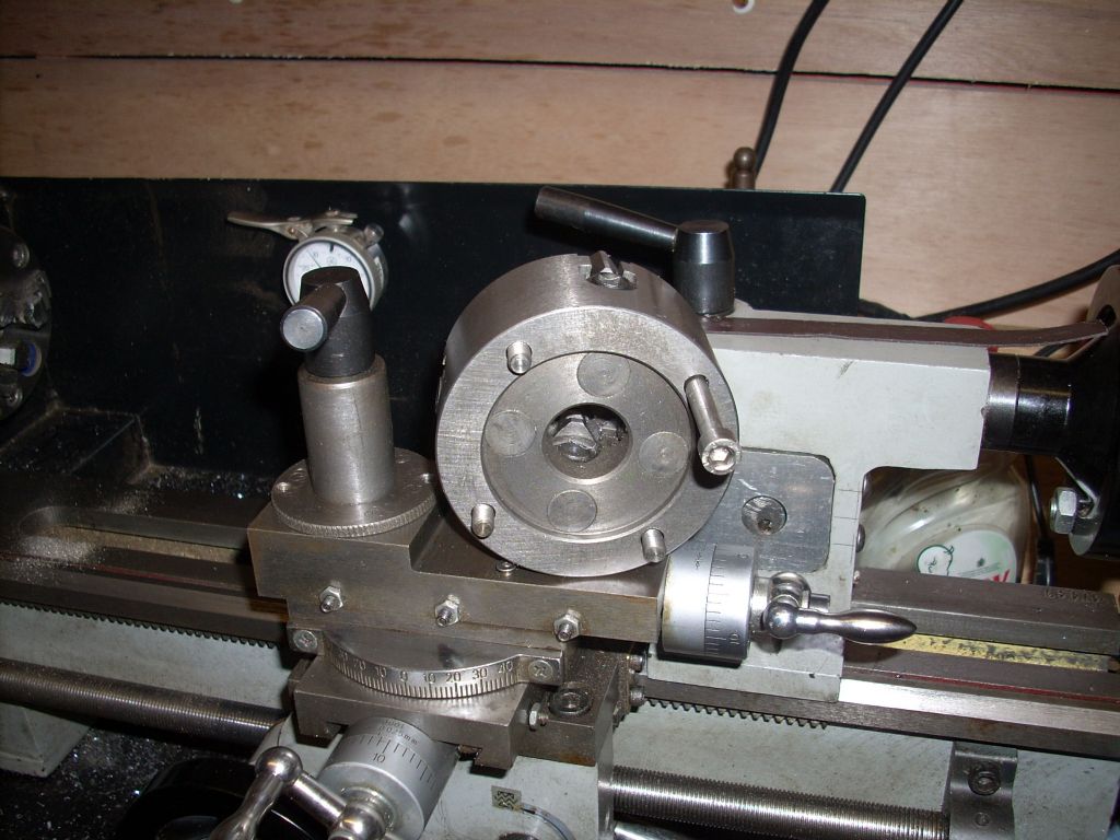

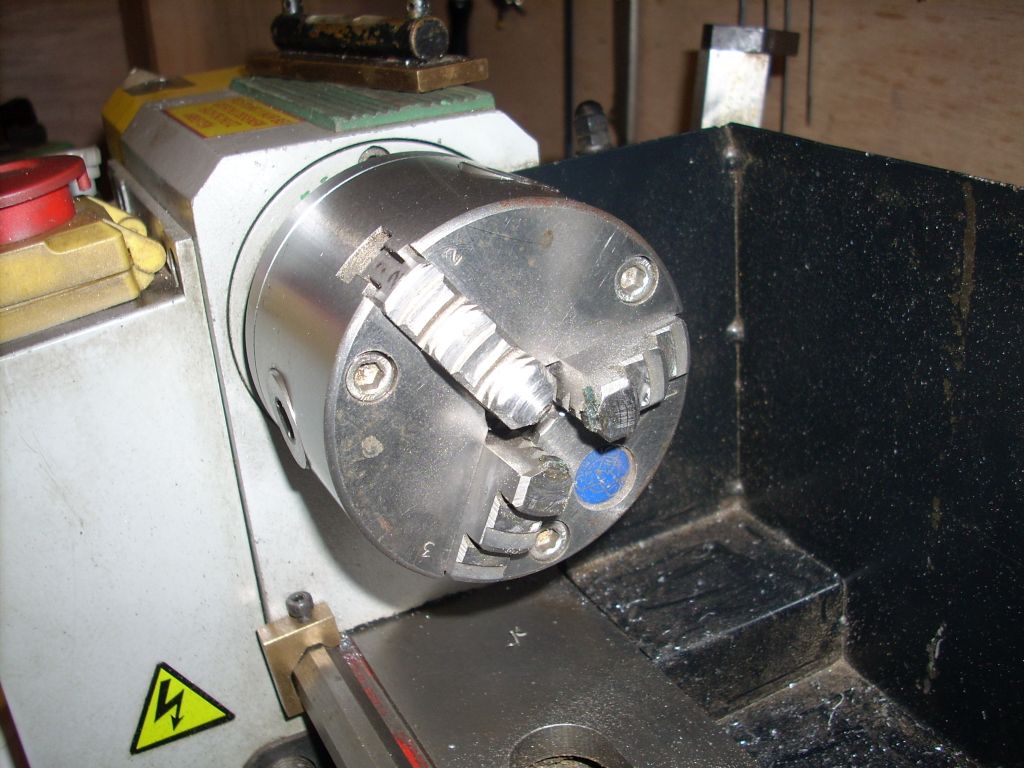

        Bernard Laycock 1
          @bernardlaycock1
          I may be thick, but I don't understand what you've done. In the photos, I can't see that anything has changed. Could you help with a bit more detail?

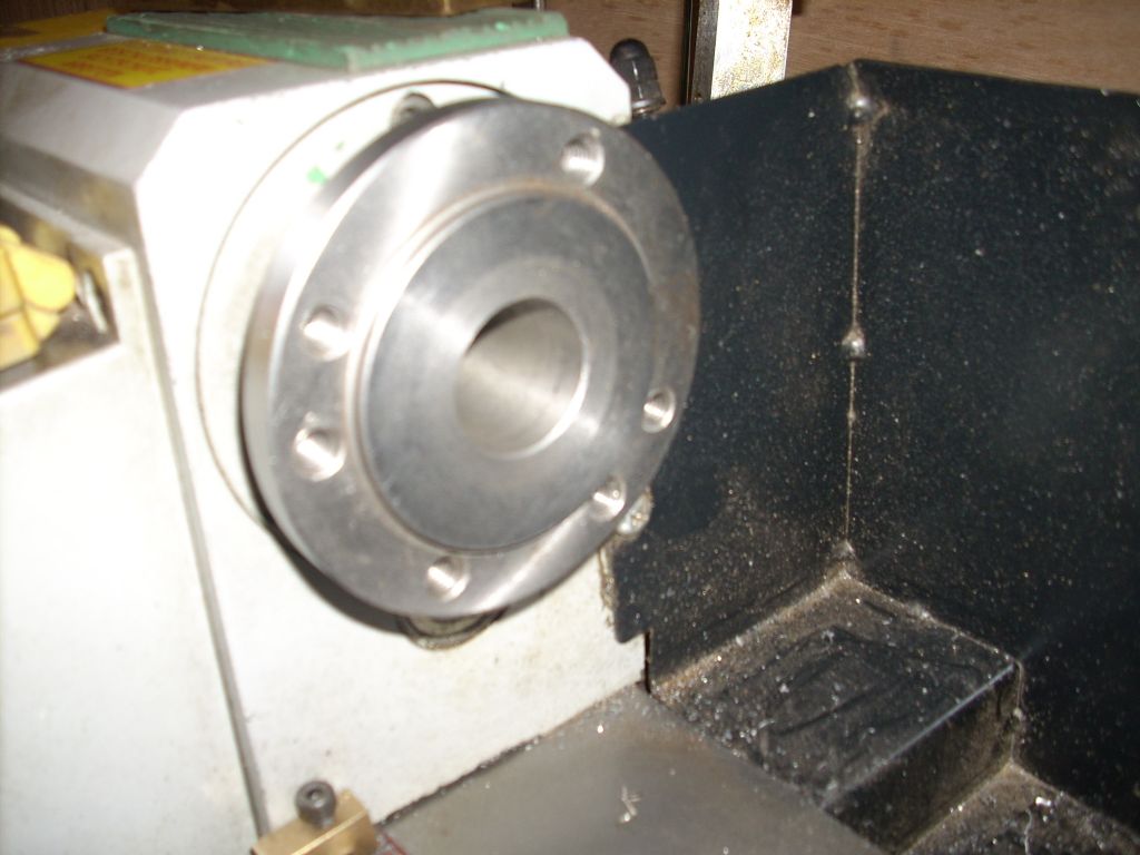

              I assume he's replaced the usual stud/nut arrangement on these chucks by drilling through to the front of the chuck, counterboring on that side and using a SHCS from that side.
              Presumably the helicoils are used in the spindle flange holes (the picture isn't that clear).
              #85262
                Its likely to be a front mount chuck so no drilling required.
                Just tap the flange for the helicoils and fit same

                  Hi All
                  I did not explain that very well sorry..First prize must go to Mr Graham Meek.
                  Thats what I did
                  Thanks Graham

                    Alternatively – do the roller bearing modification, and get an extra 5mmm of space behind the mounting flange.
                    Simples!
