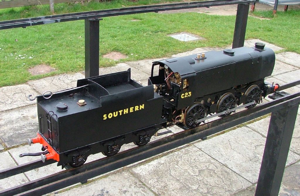

      The loco that I build alongside the recent ME series has now been completed and has been through a couple of months of track testing and the usual ongoing R&D that goes with every newly built steam loco. It is shown below in original Southern spec with none of the minor changes that were applied as the locos came into use. Also has displacement lubricator instead of mechanical pump, in line with the prototype C23.
      I hope to write up all the fine tuning over the next few months for the editor's consideration, but rest assured there were no significant deviations from the published drawings! The main change was getting a better reading on the water gauge glass.
      Fiddling with the blast nozzle size has resulted in a loco will make steam on a level track on light load, but will still pull like a demon when openend up! I have been very pleased with the self reguating character of this loco, so that once the train is under way ( weighted 7 1/4" gauge bogie trolley with driver plus one or two adults) the regulator and cutoff can be set, around 40% full movement in both cases, and the loco will merrily circulate the BDSME track of 1/3rd of a mile with the occasional shovel of coal and a bit of injector to back up the tender axle pump. Last years's IMLEC contestants will confirm it can be a tricky track. On several ocaisions I've done a full lap with arms folded, just to show off! You need to fill the firebox and boiler in the station first though!

            Another point I forgot to mention in the first post was the weight.
            The first loco clearly had a lot more power than it could use, so I felt more weight in thesecond loco would be good idea. It tipped the (bathroom) scales at 25KG.
            I added as much weight as I could in places it wouldn't show, e.g a solid steel block in place of the front mounted oil tank, thicker ashpan material, heavier cladding steel etc, and weighed the new engine in at……………24.5KG! The difference being a smaller firebox on the second engine, closer to scale. Forget lagging the boiler with lead, it's too high and will have the loco off the track on a bend. Working sanders anyone?
