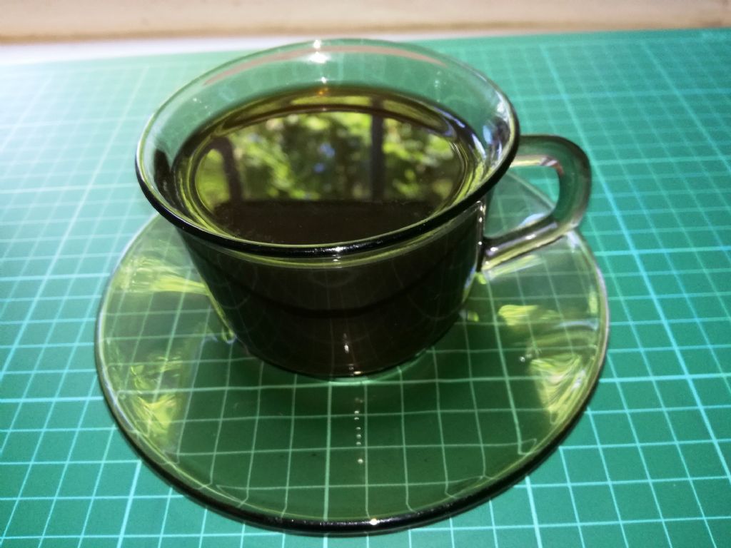

                                      Hi, the first I remember of PYREX was the craze for smoked mugs and cups, I had a mug back in the 70's but I still have two PYREX saucers and here's one with a Arcoroc cup with some morning coffee. Arcoroc France is tempered glass though.
                                      1919 was a good year for me (no I'm not that old) as it was the year my mother was born.
