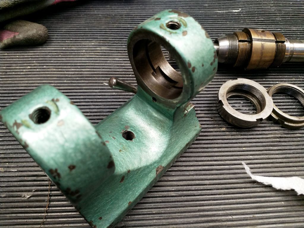

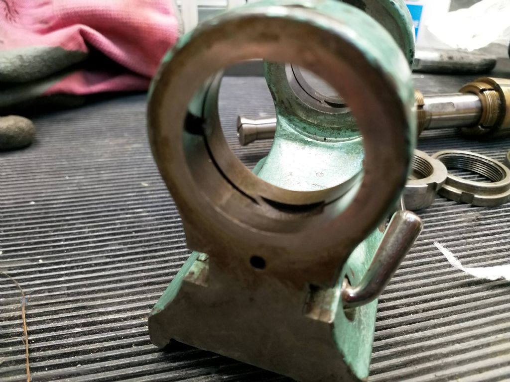

      I have a Pultra P-type lathe which I have bought to use with my clockmaking hobby.
      I looks like the bronze bearings have spun round so the oil holes do not match the holes in the headstock casting.
      Does anyone have any drawings of the headstock that would help me with dismantling this?
      Thanks
      Julia

          Hi Julia, cannot help with drawing, but your bearings have not spun. When you apply oil, it runs around a channel machined on the inside of the headstock and is drawn onto the spindle by a felt wick from the bottom. If you can find a drawing of a 1750/17770 headstock, dismantling is very similar (apart from thrust bearing)

                    Julia, the dismantling instructions of 17/50 and 17/70 models may help you, but the P type wick is simpler – it is just a short wick in the bearing leading down to a small cavity in the headstock casting, where a small block of felt will help oil retention. Your wicks may be ok, as the volume of retained oil is small.( the rest leaks out- it is not as sealed oil cavity.) Dismantling is fairly simple and obvious and would put your mind at ease.

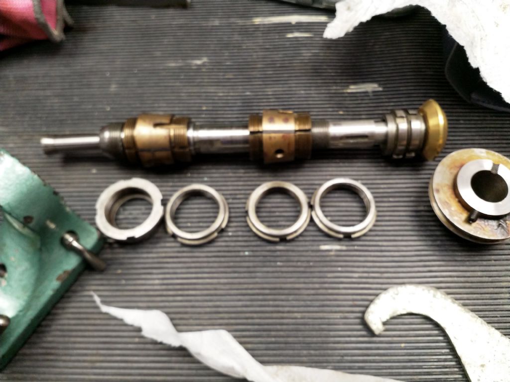

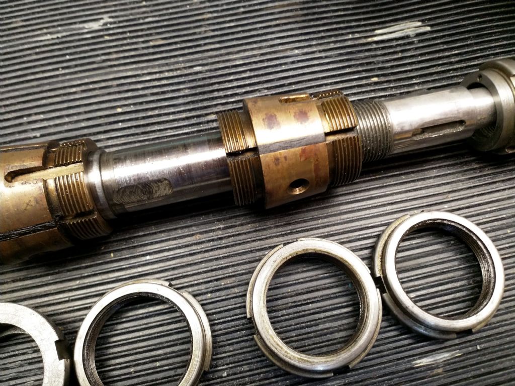

                      Julia Stephenson
                        @juliastephenson25406
                        Dave was spot-on with his description. Here is the oil-well :-
                        You can see the circular hole the felt should be in here, also note the notch which aligns the bearing.
                        Another view you can kind of see the pin that the bearing aligns with :-
                        Some of the spindle components – bits are missing from this photo :-
                        Thanks
                        Julia
