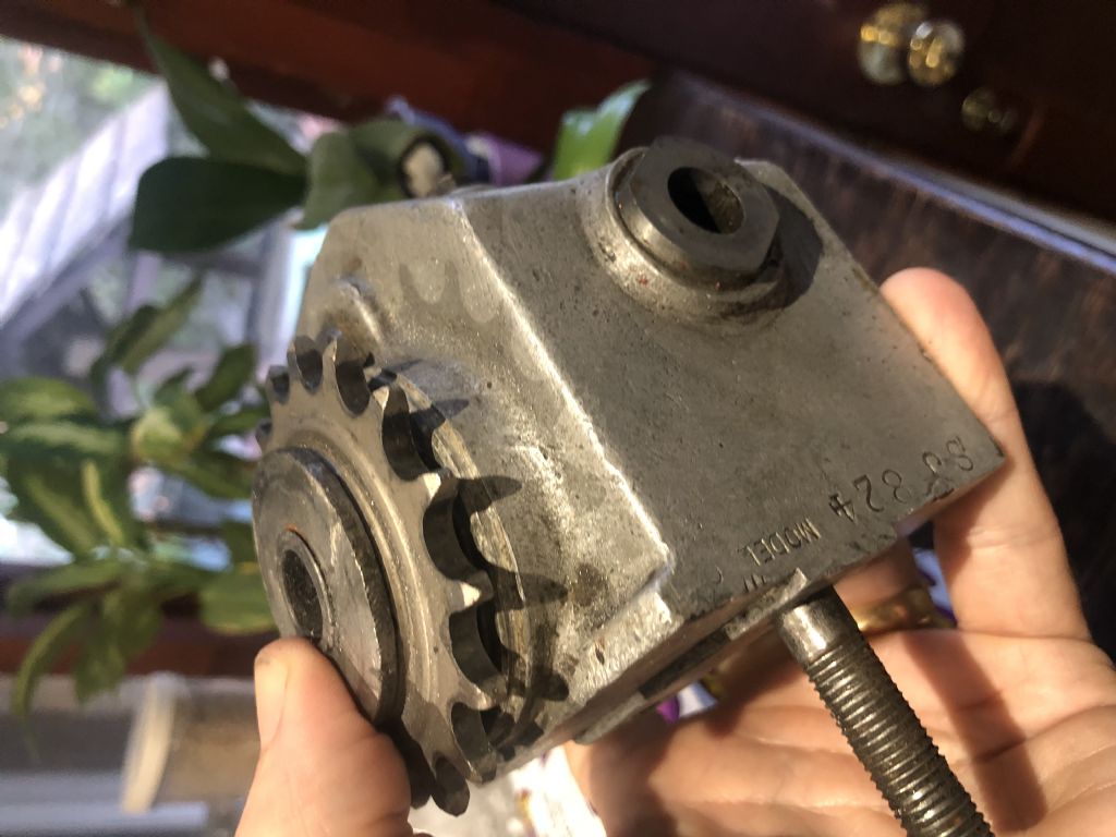

      Hi, I have an 1923 Albion gearbox and I am trying to remove the cog to replace it with a V pulley. Does anyone know how to remove it, as I am not sure if the metal ring which retains it is threaded or if it is held by a woodruff key?? Attached is an image of what I have. If it is threaded any practical tips on how to stop the cog rotating whilst I try to unscrew it, would also be appreciated.

          To hold the sprocket(cog ? ) can you wrap a length of old chain around it and secure in a vice. That will secure the cog (sprocket ) whilst you then drift, C spanner, or whatever is holding the cog. If its threaded there may be a visible sign of a thread at the ring shaft interface. Clean it up well and it should be obvious what the fixing system is.

            Thanks for the reply and info re using chain, never thought of that!! Here is a picture of my predicament, I can't tell if it's threaded, or held on by woodruff key etc and just need prising off the spline?? I have had a good look and can't see anything obvious such as a thread, or markings which gives us any clues!! I was hoping someone had had the same problem before and had the answer, or if not potentially a manual etc, to give us the answer that way.
            The gearbox is an Albion Model C FeatherWeight model 1920's, which has taken me a few months to track down, so obviously not resorting to a hacksaw at the moment!!

              Might just need a gear puller the sprocket is a serviceable part.

                This might be a case of the sprocket being face driven by pin or pins from a shoulder behind it and the ring is there to hold things in contact. I would expect the ring to be screwed on using a fine thread, perhaps appropriately handed if the sprocket is normally turning anticlockwise

                    Be wary of using a gear or bearing puller on the sprocket. It would be too easy to bend the teeth and ruin it!
                    You don't need to warned of the difficulty of finding a replacement.
                    A Woodruff key will only locate the sprocket in angular terms relative to the shaft, it is not a retaining device.
                    You need to decide how the disc at the front retains the sprocket. Look VERY carefully at the boundary between the disc and the shaft to see if there is a thread.
                    Then you have to try to work out whether the thread is right or left hand. Once you decide on that the problem is how to hold the disc to rotate it relative to the shaft.
                    As suggested using a chain around the sprocket can be used either to hold the sprocket stationary while the disc is slackened , or to rotate the sprocket and shaft around the disc while it is held by a strap wrench, or in the jaws of a vice.t
                    Once it apart, you may decide to depart from prototype, by making a pin spanner and drilling two holes in the disc to match the pin spanner.

                      This may sound daft – but is it retained internally? Being a small gearbox may be that you can get inside of it and find if there is an internal nut on the other end of the disc. Just a passing thought!!

                          Where are the holes for a pin spanner or flats for the spanner if the disc is threaded and intended to unscrew from outside there should be something.
                          Is the disc bruised by a hammer it looks a little battered.

                              Don't know if it will help, but there is a (slightly bizarre) video on YouTube at Manual – Albion Gearbox – YouTube which shows what looks like a similar box being reassembled.
                              The cog on that one is splined on, and seems to have a threaded retaining nut. Could the damage pointed out by Dave be the result of someone using something like gland nut pliers to get the nut on/off?
                              PS all the images I can see of Albion gearboxes seem to have the same or similar output shafts with splines for the cog and a retaining nut. So my money would be on that ring being threaded on.

                                It looks to me that the nut has been worn down or modified sometime ago. I would look closely at the marks on the side to see if any sign of a thread is present. There is a chance that it has a left hand thread.

                                      Drill two holes on the diameter and create a pin spanner to suit, or drill one hole on the perimeter for a C spanner.

                                        It certainly looks like a thread. Possible it is a left hand with what is just visible

                                          I doubt that Albion did anything radically different to any of their other gearboxes – or indeed other gearbox manufacturers. The sprocket will be on splines on the output shaft which is integral with the top gear – together known as a 'sleeve' gear. The sleeve gear will carry a normal RH thread, thus retaining the final drive sprocket. It is normal for there to be a locking washer that mates with the splines and allows a segment of the periphery to be turned and locked against the sprocket nut. The nut on your gearbox has been replaced with the battered ring but should still be threaded – unless something dire has occurred to the sleeve gear in which case this ring may be locked in place by deforming things or with some adhesive type locking compound. A ring without features to enable it to be 'spannered' does seem a bit strange though.

                                            The marks around the edge look like a large Stilson has been used to turn it.

                                                      SOLVED!! I took the step of drilling a slit in the metal disk, and locked the gear with my vice. Then with hammer and chisel tapped the disk (using the slit) in an anti clockwise direction, as this seemed to have more movement. As I tapped it became much easier and appeared to be threaded after all. Once it came off the cog underneath was Visible, but again it is threaded onto the shaft. It appears a small piece of square metal acts as a key to stop the thread from being turned, but once removed and the underneath cog is locked, to stop movement, this can also be tapped free, in an anti clockwise direction!! Once done the inner cog is released so I can clean it, and replace the outer cog with a new v pulley!! Thanks for the info, and if the above helps someone else out, then happy to have done so!!
