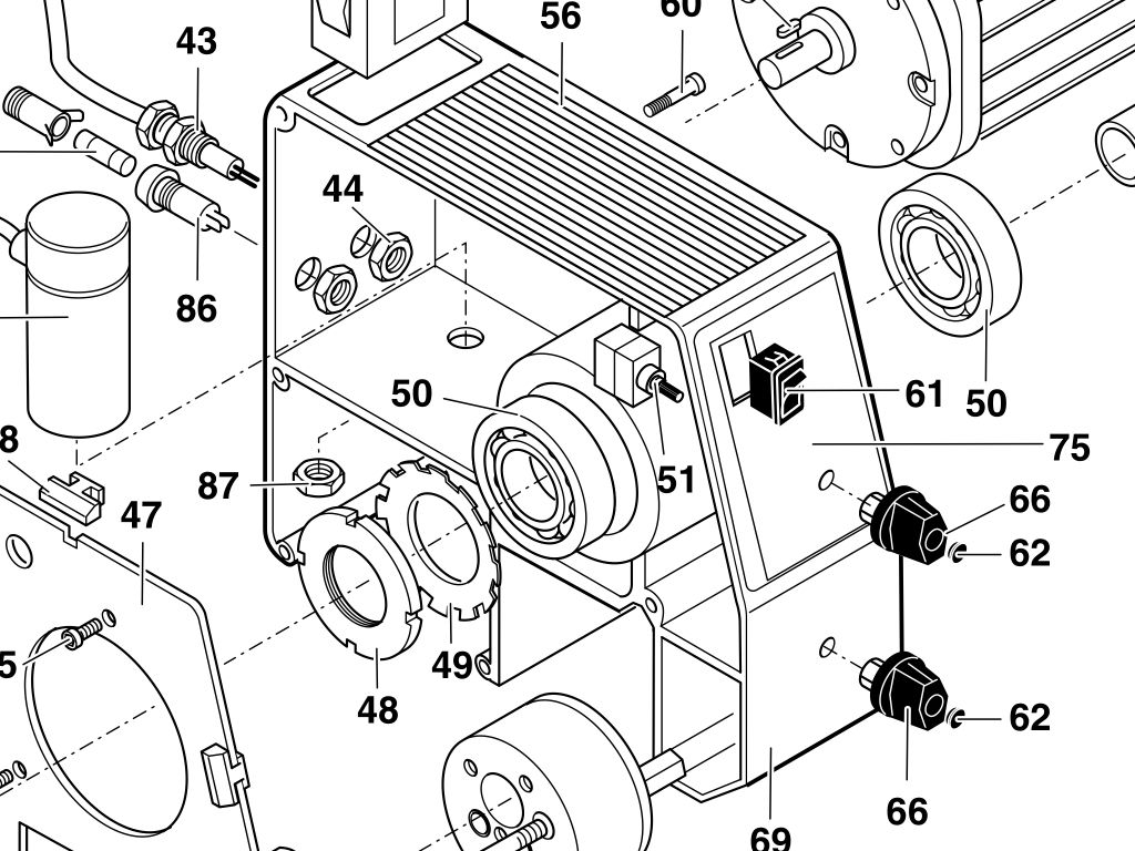

      My proxxon lathe is 14 years old … it has been very extensively used for a lot of work … now it needs the headstock lining back up with the bed and tailstock … the headstock assembly is clamped to the bed with 4 off long 8mm bolts … so far I have been unable to extract any of them … they are buried in the middle of the headstock casting … the only way to reach them is via an Allen key … please has anyone come across this before … I would like to find a non-destructive way to remove them … another thing that could be causing the taper problem are the 2 taper roller bearings … they look clean, shiny and smooth … can they wear on one side of the outer cup so the spindle is effectively pushed over sideways ?
      Anybody any offers of help please ?

            Posted by Michael Gilligan on 15/05/2018 22:12:03:
            …I've looked for an exploded view of the PD 400, but failed…
            Page 86 onward **LINK** Oddly, the four holes in the bed are shown but the screws themselves don't appear to be listed.
            Would it be practical to cut the "L" off of a long allen key and turn it with a socket?

                            Martin,
                            Knowing very little about the Proxxon lathes, I thought it best to step back … BUT given your update, I would like to offer my [now a little better informed] further comment:
                            It is clear from p88 of the document that Brian linked, that the 'die cast aluminium' headstock is potentially a fragile thing … I have no proof of this, but my "reverse engineering" of what I can see would be that the bed is probably machined, then the headstock attached [permanently] and the bearing housing bored in-situ [using the bed as its reference]. Consequently, I would be very wary about detaching it.
                            Edited By Michael Gilligan on 16/05/2018 13:30:35

                              As the headstock is aligned using the v-bed, it's unlikely to have shifted.
                              My worry is that the alloy headstock casting, which is very lightly built compared to most lathes, may have distorted over the years. This would be very difficult to fix, although a combination of local heating and application of controlled force might help..
                              Preload should be pretty minimal for a lathe.

                                    From p20 of the book:
                                    Main spindle
                                    The 2 taper roller bearings of the spindle are maintenance-free for at least 6000 hours at minimum speed and 1800 hours at maximum speed. If slight play is evident after this period, the bearings can be adjusted by a specialist.

                                              Ady,
                                              Please don't shoot the messenger … I was simply sharing what I had found in the book; not expressing an opinion.
                                              I have no idea who Proxxon would suggest as 'a specialist' but at least it gives us some comfort to see that the bearings are considered adjustable.
                                              I'm surprised that the exploded view does not seem to detail any spacer between the bearings; so perhaps only those 'specialists' are privy to the design details of the headstock arrangement.
                                              [my Pultra's bearings are fine, thank you … but the PD 400 is surely intended for a very different market]
