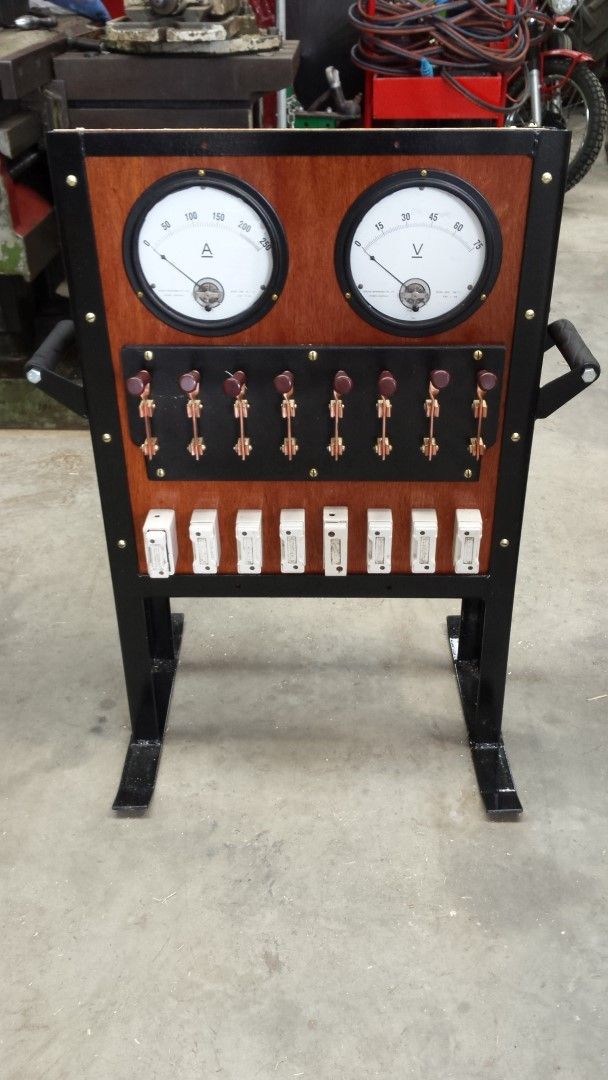

                                                    Paul Lousick
                                                      @paullousick59116
                                                      Thanks to everyone for their knowledge about preventing rust on steel.
                                                      I have another question.WeI have restored an old switchboard with knife switches made from copper. (It will be connected to a 32 volt generator, driven by one of our portable steam engines). What is the best way from stopping them from tarnishing and to keep their shine. Spraying with a laquer is no good as the switches have to make an electrical contact.
                                                      Paul.
