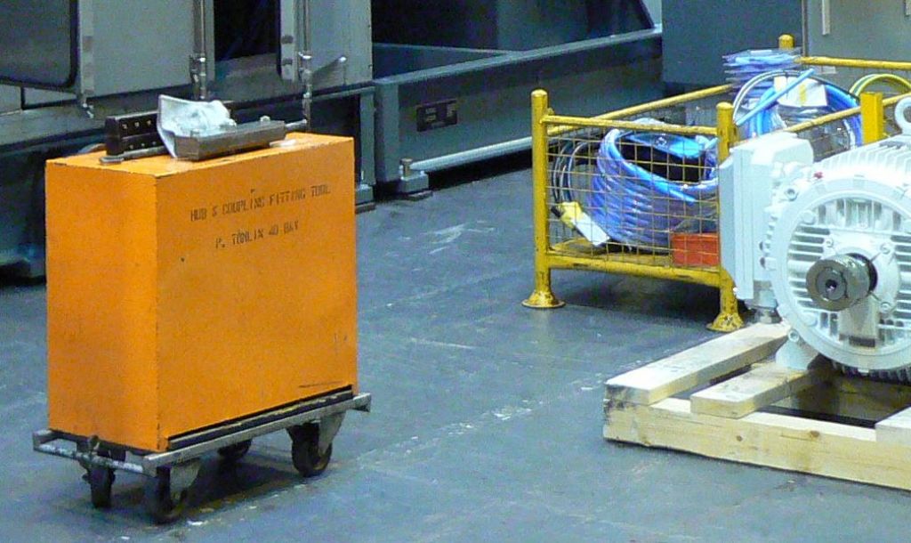

                          Bearing heaters are a thing you can buy. SKF make them as well as others. We used to use them where I worked, we used a contact thermocouple on the bearing to check when it was up to the required temperature. It worked by acting as a transformer using the bearing as the secondary winding. This induced a high current/low voltage in the bearing. The energy put into it was based on the current squared times the resistance, watts= I²R

                                      This is the bearing heater we had at work. Not much to see as the cover is on it but you can see a couple of laminated bridging pieces on the top. Inside there was a U shaped armature with a (hidden) coil around it. You put the bearing (or hub in our case) over the bridging piece and placed it onto the U shaped armature to complete the magnetic circuit. We did not use it for bearings, we used it to fit the coupling hub to large motors, an example of which can be seen in the photo. If it did not go on properly it had to be ground off and a new one put on so best do it right first time.
