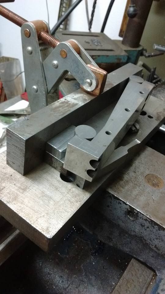

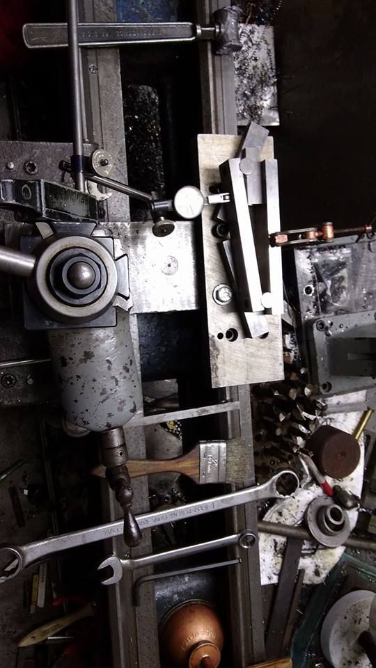

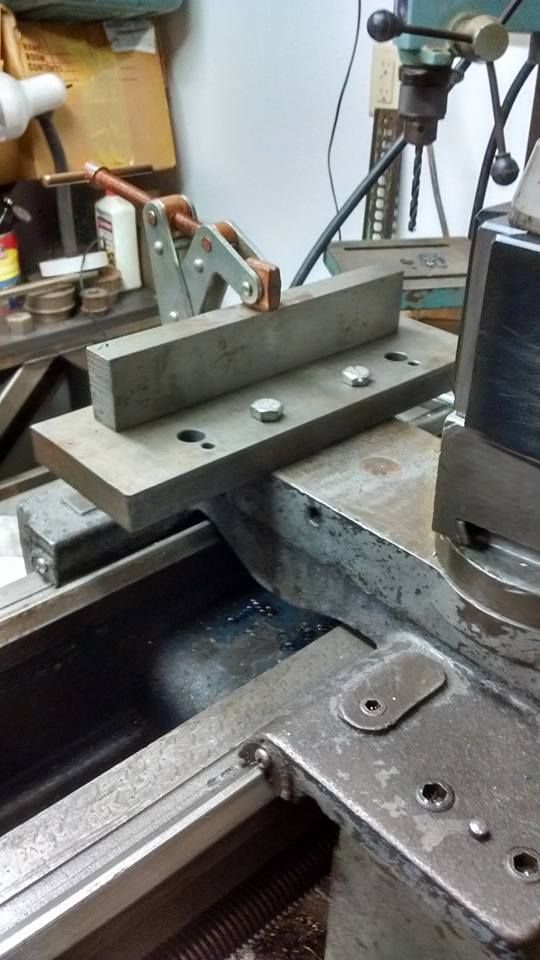

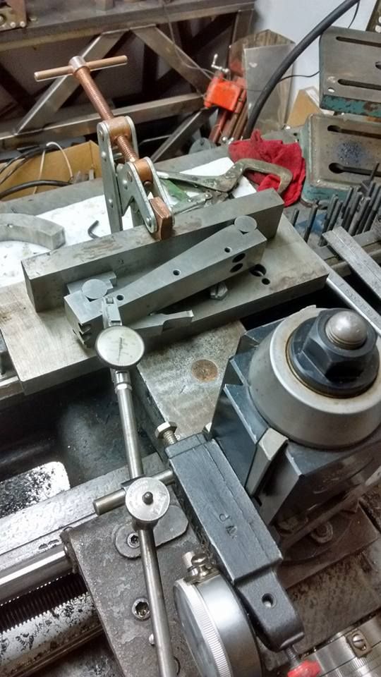

        I'm sure the photos will not be in the proper order.16195189_10207823110443534_5638245230362332824_n.jpg
        Dial in a parallel. I have a box cross slide with a pair of holes in it to mount a small platen. I just clamp a parallel on it.
        Set up the sine bar.
        Dial in the compound.
        #288343
        Chris Evans 6
          @chrisevans6
          Bit easier for me, my top/compound slide is ground all over (and again by me to ensure it is right) I just put the sine bar/slips or a ground angle wedge to the edge of slide and clock up. Nice way you achieve the same result.
