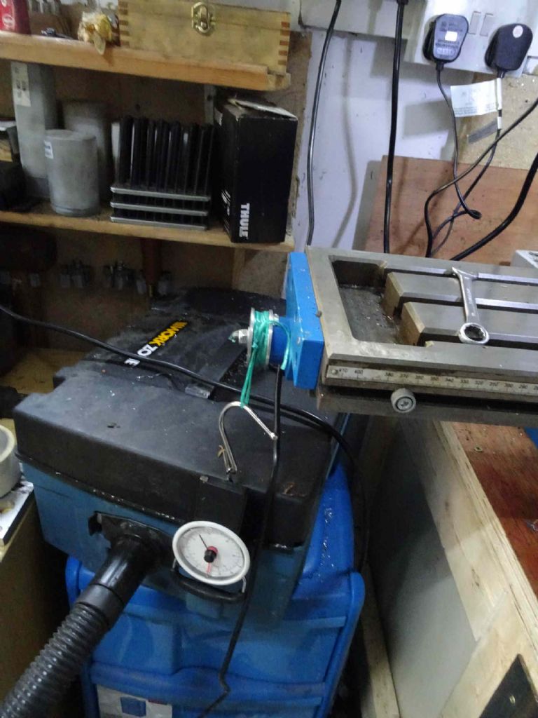

      However, I was still confused about how much power I actually needed, so I build myself a poor man's dynamometer (if that's the right word.
      This consists of a pulley on the X-Axis leadscrew, a bit of string and a luggage weigher.
      the pulley radius is about 20mm.
      I found I could move the table at milling speed with about 5kG force.
      I then took a 50mm facemill and cut a 1mm deep channel in some mild steel. the first time round I'd set the cutting speed too low (450rpm) and it needed 7/8 kg Force. The second time at 800 rpm it only took 5/6kg again.
      I think that's 50 Newtons at 2cm which is 1 N.m well shy of what the estimates worked out. Clearly a fast traverse would require more (I shall experiment).

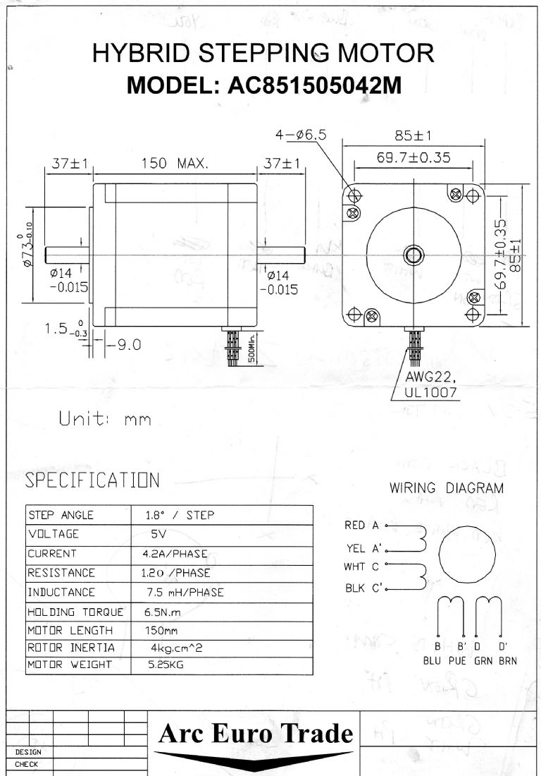

                        I use 2 of these stepper motors which came from Arc euro they are
                        rated at 6.5 Nm .This Warco mill table size is 30 by 8 inches (760 x 205 mm)
                        so a similar size to yours ,there is a slight reduction in the output of these
                        motors as the machine uses a unipolar system but it still moves the table as
                        fast as the Align power drive .
                        Here is a copy of the specification sheet as a guide.

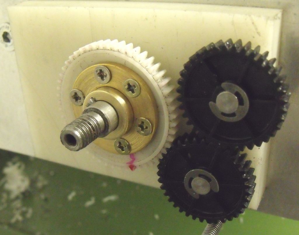

                                    Yes I agree with you, the motor does not stop dead like a stepper would ! I freely admit that the situation you describe of coming to a blind end had never occured to me. I'll have to check just how fast the traverse stops when it hits a limit switch.
                                    A far as car window screen wiper motors go, they are amazingly powerful things. Back in the early days I tested one using a pair of mole grips to try and stall it. I needed two hands and struggled to restrain it. The motor just laboured and carried on turning. It stripped the centre out of the worm wheel.
                                    As it happened I got several motors and found that some are left handed and some are right handed. All the ones that I got were dual speed bar one.
                                    If you have have a look at my album you will see the tumbler reverse mechanism copied from the Myford.

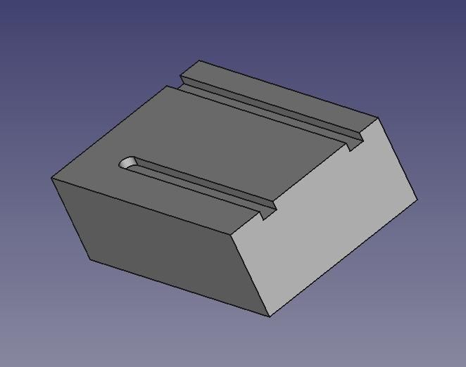

                                              Just a quick vaguely related question – I'm planning to connect the motor and lead screw with a timing belt. There are a vast range of options.
                                              Is 10mm width sufficiently strong? Is 5mm pitch too big – should I try for 2mm?

                                                If you look in my album you will see that I made a gear to go on the end of the leadscrew, using a salvaged plastic gear and a brass hub. this is driven directly by one or other of the tumbler gears.

                                                  I use 9 x 5 mm on my lathe leadscrew, dividing head and mill power feed, and I think my Novamill uses the same. It's fine, I think you may be overengineering this.

                                                    Why have you got a tumbler reverse gear on a drive from a reversable motor?
                                                    Robert G8RPI.
