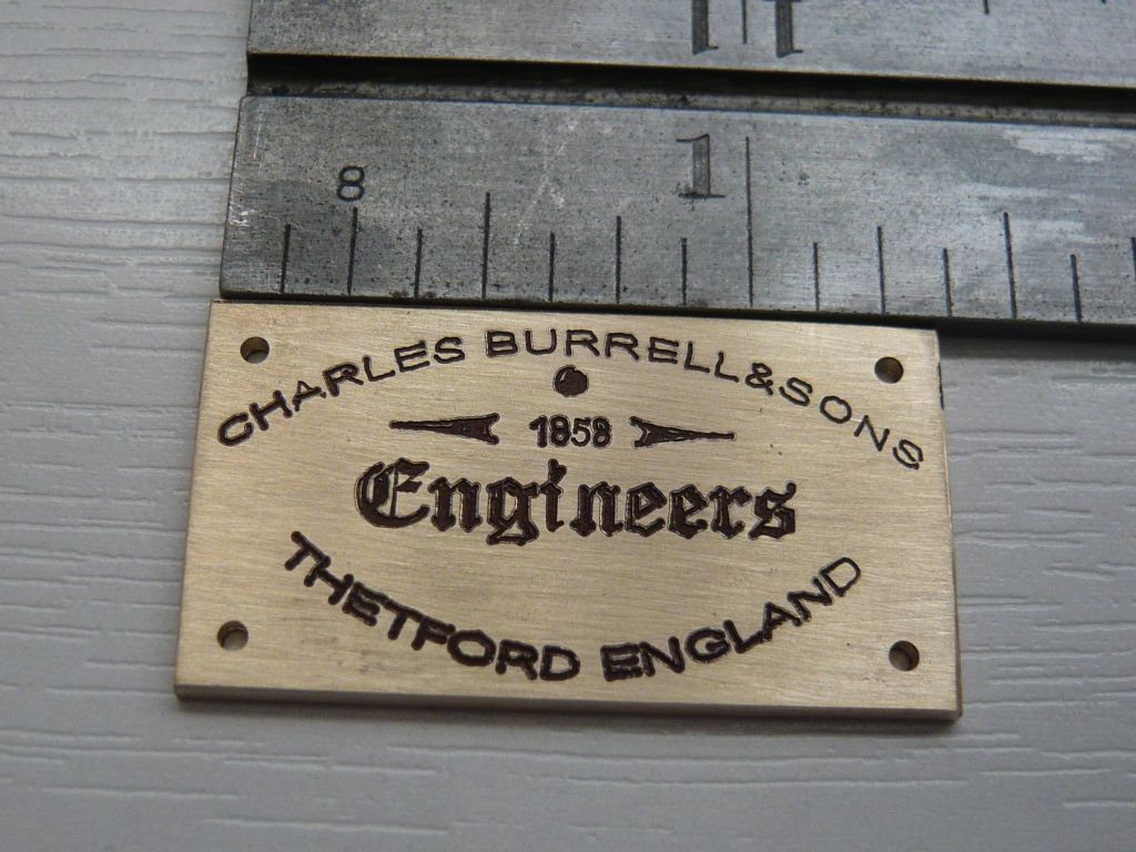

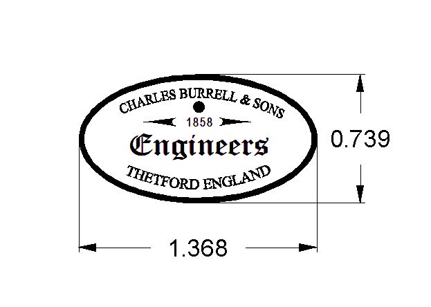

      I need to make a pair of brass nameplates for my Burrell-Boydel Engine. I've approached a company in Sheffield who said they could do them but they've admitted defeat after trying to photo etch a sample and they say they are too small for conventional engraving.
      I've tried a local sign company to make me a template so that I can do the engraving but it wouldn't be suitable.
      So, I've wondered about 3D printing?
      I need a template that could be A4 or, if that is too big, then A5. If the 3D printing could be done directly onto acrylic or plastic sheet and finish at about 1,5mm or 1/16" inches then I can use the stylus on my engraver to copy and reduce the image onto brass sheet.
      This is the nameplate that I need to end up with but need the template to be 8 or 4 times larger, any thoughts?
      If anyone can help, I can supply an image in a variety of file types and would, of couse be happy to reimburse any costs.
      Brian

                  Brian H
                    @brianh50089
                    Many thanks for the replies;
                    Dave, that sound like it might work, can you let me have more details?
                    Tom, I had a look at MDC but they state 'no lower case' so that creates a big problem.
                    Neil, I've had a go at engraving simply by following the lines on an enlarged drawing with this result;
                    Its far from perfect but I'm sure could be improved. The only problem is that I then discovered that the plate should be a cast oval!
                    Brian, I had a look at the 2 sites you suggested but the etching seems very shallow and I don't need the colour infill.
                    Brian
                    #370910
                      Brian,
                      Your lettering looks a very credible [and creditable] start:
                      … Presumably you have a pantograph engraver.
                      I see two related problems:
                      1. The plate should be a cast oval, and
                      2. The lettering should be raised, not inscribed
                      It should be possible to address both of these quite simply; by doing what Burrell would have done … make a mould.
                      You need a mirror image template [about 10x linear scale] and suitable cutters; but I think you are nearly there.
                      #370911
                        Posted by BDH on 08/09/2018 08:05:52:
                        … but still creditable!
                        So the letters are sunk, not raised? And you'll accept some changes to the font (e.g. making it a bit bolder).
                        In that case I suggest photo etching, as ecthing out thin letters is easier than ecthing around them! Although a 3D printed template should help you get things like serifs on the letters and more consistent widths.
                        #370916

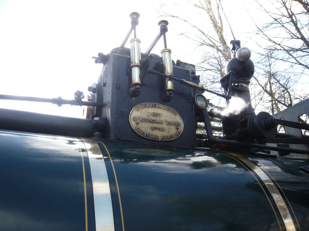

                          To add to the potential confusion:
                          Here you will find a plate 'not-dissimilar' to Brian's engraving **LINK**
                          http://www.wikiwand.com/en/Charles_Burrell_%26_Sons
                          But, I am pretty sure it's the Registered Office wall-plate, and not something which adorned an engine.
                          #370919
                          Martin Johnson 1
                            @martinjohnson1
                            "To add to the potential confusion:
                            Here you will find a plate 'not-dissimilar' to Brian's engraving **LINK**"
                            That plate is a valve chest cover on a (roughly) pre 1900 traction engine.
                            Martin
                            #370923
                              Posted by Michael Gilligan on 08/09/2018 08:55:05:
                              They had 2072 offices?
                              #370924
                                Posted by Martin Johnson 1 on 08/09/2018 09:08:30:
                                Martin
                                I stand corrected, Martin
                                Edited By Michael Gilligan on 08/09/2018 11:40:25

                                  Thanks for that Michael, yes, I have a pantograph engraver (Alexander).
                                  The inscribed plate was produced after seeing a similar plate on a Burrell Showmans engine but examining some pictures I had taken of the oldest Burrell (Century) I realised that the plate should probably be a cast oval as is Century's.
                                  I'll carry on researching.
                                  Brian
                                  #370943
                                  Brian H
                                    @brianh50089
                                    Here is a picture of Century's works plate. Century was built some 11 years after the engine I'm building but I doubt if works plates changed much; I'd be interested to hear from anyone who knows different!
                                    Century works plate
                                    Brian

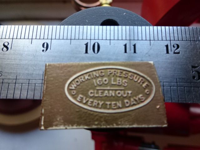

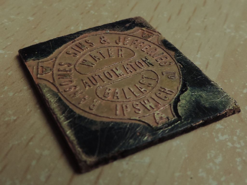

                                      Just to add to your misery, that's raised lettering… but I think you could do a decent facsimile of that with photo etching.
                                      #370966
                                        This little one is PE and letters 1/16" high or less, if Fowlers can do it then Burrell should be able to!
                                        Is there any reason why you can't use the pantagraph to machine away the areas around the letters rather than the letters themselves? That seems to be how our CNC owners do it and a pantagraph is the same basic thing moved by hand rather than stepper motors.
                                        Edited By JasonB on 08/09/2018 18:40:51

                                        Brian H
                                          @brianh50089
                                          Wouldn't you just know it! I've been trawling through some old pictures of Burrell-Boydell engines and found an engraving that shows a rectangular works plate!!
                                          It appears to show that the wording is still on an arc top& bottom so I think I will go with that design. Unfortunately, there is no information about what number this engine might be so I'm inclined to just leave the space blank.
                                          There is still the same issue of how to make it (them) though.
                                          Brian
