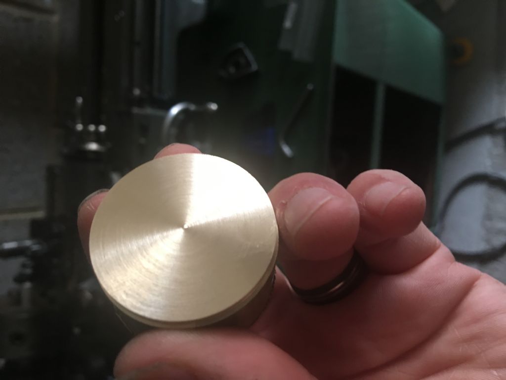

              Curtis
              Got your PM, thanks.
              Will call you in the next evening or two.
              In the meantime, what I would suggest is that rather than replace the brass with a piece of mild steel and trying the tangential tool on that as has been suggested; I would keep the piece of brass in the chuck, but replace the tangential tool with a conventional tool and holder, and try facing the brass off with that – and, as has been suggested, preferably with a round nosed tool.
              The reason for this is because it will then show up whether or not there is a problem with the tangential tool/holder, or an issue with the lathe, such as spindle or slide/gib wear.
              I am also assuming that the tool tip was centred on the brass?

                #291411
                Curtis Rutter
                  @curtisrutter61973
                  Sooooooooo…… Problem solved embarrassed
                  After trying a few different things, ordered a normal hss tool piece, tried other metals, mild steel, aluminium, and another piece of brass was still getting the same results so decided to change belt speeds. After changing the speed to the slower end it then dawned on me….. the competent electrician that wired up my lathe has wired the switch the wrong way round, I didn't notice at higher speed but I'd been using it in reverse, thankfully I was only taking light cuts. Flipped the switch and started again and voila! It's a pleasure to use, the tangential tool cuts the brass like a hot knife through butter as does the HSS tool bit I bought.
                  We all were beginners at some point embarrassed
                  Edited By Curtis Rutter on 31/03/2017 12:04:35
                  Edited By Curtis Rutter on 31/03/2017 12:05:28
                  Edited By Curtis Rutter on 31/03/2017 12:06:26
                  #291418
                    Well spotted Curtis!
                    I often run my flange spindled lathe in reverse for parting off, and occasionally leave it that way when I've finished. Next session taking a normal cut, I can immediately tell something's wrong. My blood-pressure goes through the roof until I eventually remember that pesky reverse switch…
                    I've always been a beginner and am likely to stay that way.

                      Thanks for coming back and sharing the solution. Bit tough to admit it, but even us experienced engineers make simple mistakes occasionally.

                        I think it serves as a testament to the durability of HSS that it will actually cut in the wrong direction smile p
