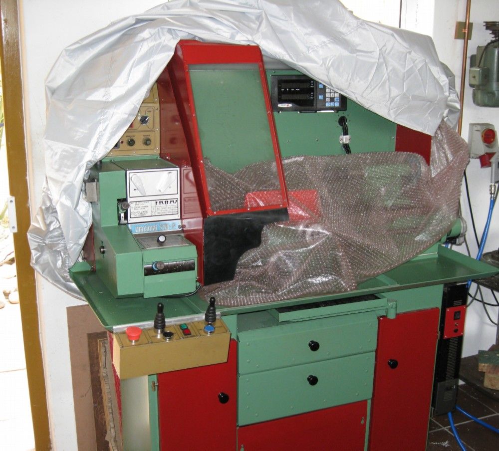

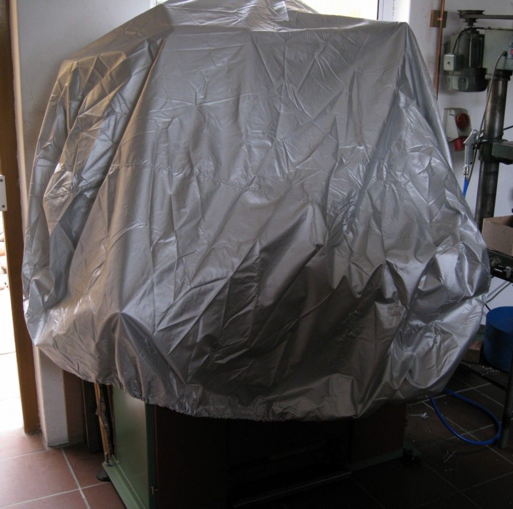

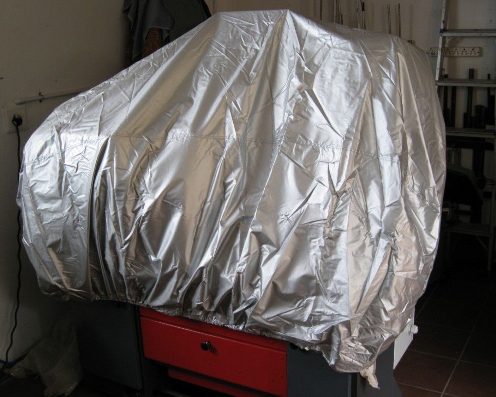

        Joseph Noci 1
          @josephnoci1
          Doug, I live 50 meters from the edge of the Atlantic, and have a very high , salty, humid environment.
          We have regular strong, wet westerly winds from the ocean, and sometimes dry wind from the east over the sandy desert, so I get sand and dust as well! I always covered my machines with heavy plastic and then a cotton cover, like an old bed sheet or similar. The I discovered these semi-waterproof Car 'shade' covers – they are made from a thin but very tough material coated/impregnated with a plastic or rubber coating, similar to a semi-waterproof raincoat. They also have an elastic around the periphery.
          I obtained a medium motorcycle size for the small lathe, and a mid size Quadbike one each for the big lathe and the two milling machines. They work a treat – quick to fit, do not tear easily, and form a nice skirt down to the base of the machine.
          Joe

          #389673
          peak4
            @peak4
            Joseph, yes, I used them on both motorbike and kit car when I needed to store them outside, before we moved house and I gained garage space.
            I can confirm they work well, and are also breathable to an extent.
