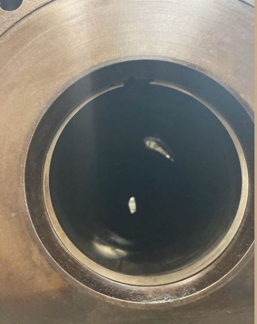

                                Interesting photo posted by Wayne Grenning on his FBpage showing a very worn ring from an early Crossly piano base engine. So worn that there is no more "spring" left in the ring yet the engine ran be it with some blow by. The cylinder bore has some matching wear!

                                  Since leakage is determined by pressure and time, often a worn engine might be difficult to start, but once running will perform reasonably well, (The better, the faster it goes ) because the time for leakage is decreased.
