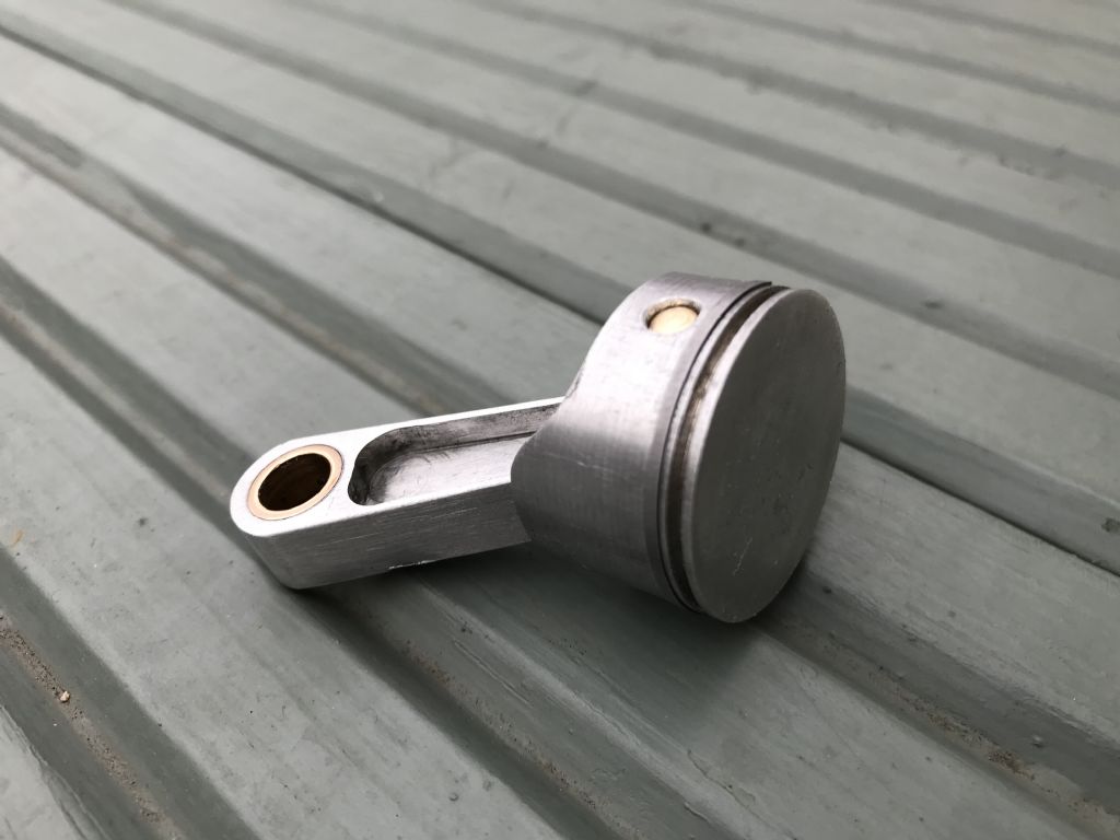

      Hi all,
      Looking for some suggestions please as to what I'm doing wrong. I'm trying to cut piston ring grooves in a piston and I keep getting a small taper on the right side of the groove.The left side is always good and perpendicular. The groove width is 1.3mm, and i'd guess the taper is around 0.1-0.2mm, certainly visible under the magnifying glass.
      I have ground the tool bit and have relief on all sides. I thought it might be one of the feeds creeping, but even holding all feeds steady it still happens.
      Any suggestions?
      Thanks Craig

          Is the tool flexing?
          #411785
          Craig Booth 1
            @craigbooth1
            possible. I'm using a 6mm tool bit and i've kept the cutting edge as short as possible. Tool bit is about 15mm out from the tool post.

                      Is the outer edge of the groove coming out wider than the 1.3mm tool and the bottom to size? if so then the tool could be flexing away on the tapered side and the side rubbing on the other which would make it straight. Close up photo of the tool from above would help.

                          Hi all,
                          Success, thanks for the suggestions. I reground the tool, and reduced the overhang. Not sure if it was one or both of those factors, but I have 2 nice ring grooves now with nice parallel sides.
                          Have tested the piston in the sleeve with one ring fitted and certainly feels like a good seal.
                          Thanks
                          Craig

                                the method I use on stationary engine pistons ,is on new pistons is to use a short stiff parting tool to rough out the ring groove to undersize on width and go in to full depth,then grind up very narrow left and right hand turning tools from HSS and machine each side of the groove (not at the same time) this gives dead square groove sides and good control over groove width.
