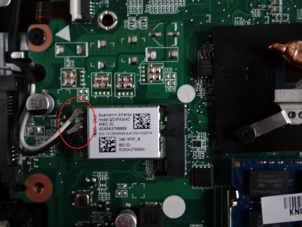

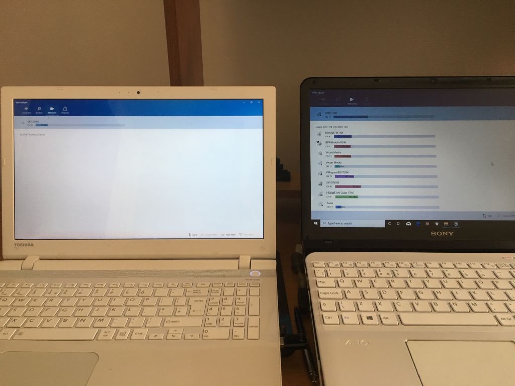

      My laptop a Toshiba despite receiving a strong Wifi signal is behaving as if the signal is weak, unless the laptop is inline of sight with the router it in most cases will not connect. I purchased a new Wifi card Intel AC3160 (not one of intel's best I'm told) fitted the new card only to find it was just the same,I do have a USB Wifi adaptor which works fine so anyone got any suggestions ?
      Thanks
      H

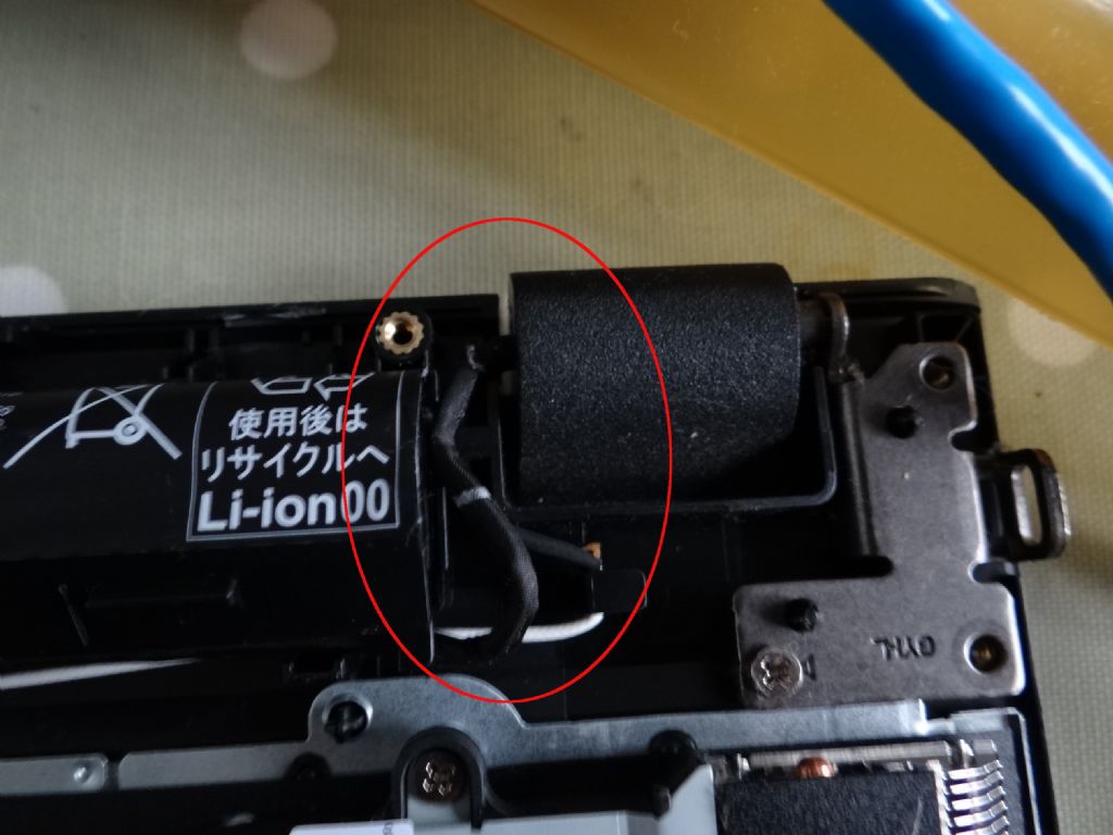

            At a wild guess, could it be the internal WiFi aerial or its the connection to the card.
            The aerial may be in the screen surround, and either the connection come loose, or the mylar flexible ribbon cable fractured.

                        I am considering a problem with the aerial but have not got the confidence to pull the screen apart , maybe I should add that the laptop worked fine for a number of year all around the house, I have done all the usual stuff updated drivers/firmware,communicated with Intel etc . I have thought of put a meter across the aerial connections of the wifi card but don't know if that would work ! The pic below show the problem laptop on left and the wife's Sony on the right both machines been of a similar spec
                        Normally speaking, it's not hard to get the bezel off the screen case, so you can see what's happening.
                        I'd do a search for an on-line service manual for your specific model.
                        If it's a common problem with that model, there's a good chance that there might even be a youtube walkthrough.
                        I normally keep a few old credit card, so I can thin the corner with a block plane, or sharp chisel. It works well as a gentle tool for releasing such bezels; If you know any guitar players, a worn out plectrum works well too.

                          If your laptop has worked ok up to now and your wife's laptop works ok, it is not likely to be adjacent networks or equipment that is the problem.
                          The easiest solution is to use a USB wifi adapter. Modern ones are very small and seem to work ok. This avoids the risk of damaging the laptop when taking it apart to try to fix the problem.

                            Your wife's laptop could easily have a more sensitive receiver, so comparisons are not always straightforward. I have about 8 laptops in use (some more so than others) in the house, not to mention Raspberry Pis and Amazon Echos, and I teach with up to 15 laptops in the same room. The individual differences, even between supposedly identical machines can be far greater than you might think.
                            Channel 1 is the default 2.4GHz WiFi channel and if a lot of neighbours have changed ISP or got new routers there could be a lot of people using the default channel. You need to look at what channels are being used near you and pick one that is not the same as everyone elses.
                            I use a tool a called inSSider to check for channel clashes which is very good and easy to use, however while it used to be free they charge for it now. WiFi Analyzer Tool from the Microsoft store is very cheap and sometimes on offer FOC. Both give a visual display of channels in use nearby so you can choose the least used.
                            Something else to check, but less likely to be the problem – When you switched the WiFi card did you reconnect the wires from the internal aerial and the same way round?

                                However, Nick's suggestion that the antennae are plugged in the wrong way round is a good one! The 2.4Ghz and 5Ghz antennas aren't interchangeable, but would still work poorly.
                                Are the coaxial plugs seated properly? They are fiddly to fit!
                                The other possibility is the coaxial cable is damaged where it enters the hinge to get behind the screen in which case the cable needs replacing.

                                  Dave I was careful with a aerial cables and I do not think i reversed them however on this model the back cover comes off very easily so when I get 5 I may swop them around to see if it makes any difference yes
                                  H
