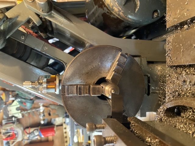

      3fe8d3cc-6d72-47a0-8682-c3f3a600ab61.jpeg0b765787-66df-451b-b938-47567170c02c.jpeg907c254c-41b6-4501-8ec5-cb081cd8b5f1.jpegHi all,

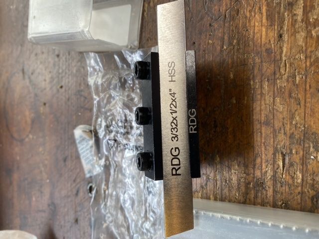

      as you can see in the pics, I bought this RDG parting tool that someone recommended and it looks a really good tool. The only trouble is, is that the cutting point is a little bit above the centre of the work, so it’s not cutting at all really, more like rubbing.
      my question is, is there anyway I can get this on center point or have I wasted my money. I don’t have a milling machine to reduce my toolpost holder.

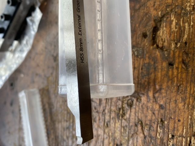

      I also bought the hss parting tool, this seems to struggle too, but as it says on the side of the tool, it’s more a grooving tool than a parting tool.
      any advice.

          Grind the top of the toolbit down until it is on centre height.

            Put the holder in the lathe and machine away an amount of metal that will drop the blade to centre height. Hacksaw or grinder will also do the job. Noel

              If it will not weaken the holder too much, mount that in the chuck and face off the lower side of the holder, enough to bring the tip down to centre height.
              IMO, don't grind top, rake on the blade, to reduce the risk of dig ins. But do lubricate when parting off

                The pictures show the blade tool is much too high. Three choices I think:
                1. Modify the holder, as per Howard. Easy with a milling machine, but a challenge on a lathe for a beginner. If the holder is soft I'd file it. (And curse every second wasted doing it.)
                2. Grind the tool down from the top, as per Andrew. Only objection to this is the need for a grinding wheel and the skill to use it. I'm prejudiced against grinding HSS because I'm not very good at it. After lots of practice I can just about manage, but it's never a happy experience.
                3. Buy the next size down so you can get on with learning how to part rather than stop to learn how to modify tools first! Modifying tools is well worth learning, but it often requires advanced techniques a new learner hasn't got to yet. I'd buy my way out of the immediate problem and come back to grinding and milling later. They both need to be tackled in due course, and fixing the tools as described by Howard and Andrew is a suitable project.

                  As well as Andrew's suggestion you could do as many older lathes did and not use the 4-way but clamp directly to the topslide with packing to bring it upto height.

                        Note that if the parting blade is tapered, then grinding from the top will reduce the cutting width. The tool can then be fed into the work, without risk of jamming, only to the extent of the ground length.
                        The "grooving tool" looks to be a poor shape, far too much rake on the top face. I'd grind it back and perhaps put on a much shallower rake of, say, 5 deg. or so.

                            Look back through my previous posts and you will find that I recommended the tool shown in your photos. However, I use the blade in the QCTP holder supplied by RDG and mounted on the QCTP, allowing height adjustment, which your 4way toolpost doesn't.

                                  Send your  tool and holder back to RDG and exchange it for a smaller one that that will fit your Myford. The RDG site says this one should but obviously it doesn't.
                                  But first, check that if the mounting block attaches to the main parting tool holder body with two cap screws, sometimes the holes are offset so if you flip the block over it will lower the tool height.
                                  If the other tool, labelled Grooving Tool, cuts an 8mm wide groove, it is way too big. 8mm tool height would work ok with packing though.

                                        Rather than modify the blade holder you have would it not be better to talk to RDG and exchange the holder for one of their smaller blade holders. A blade which is 10mm high will probably fit better than your current set-up.
                                        It needs to be remembered that Myford machines were designed around the use of 1/4" to 5/16" HSS tool blanks.
                                        The opening shot of the ground parting tool has far too much top rake. I do, and have always used zero top rake.

                                                  If the cutting edge of the blade is above centre height, even "A fraction" it will rub rather than cut, and you will have problems.
                                                  ANY tool mounted above centre height will not cut, it will rub.
                                                  Set the blade at centre height, with no top ,rake and life should be a lot simpler.
