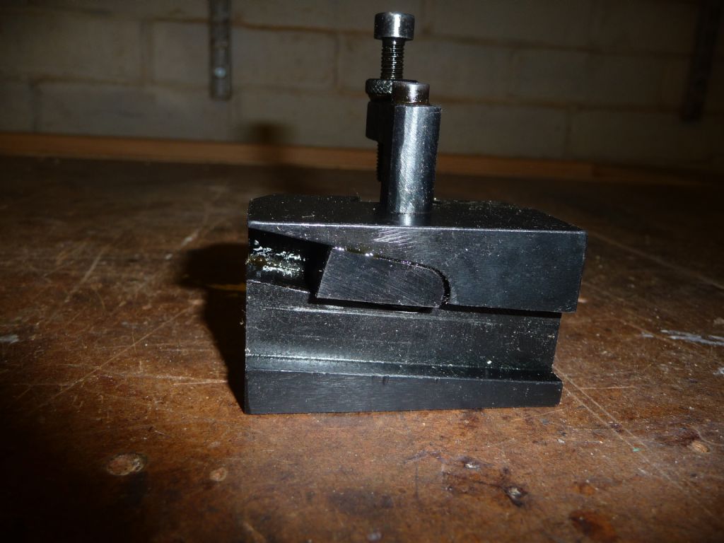

        This is my SIEG SC4 tool post parting off blade holder. I haven’t used this yet and am looking for a blade. The slot is 14.2mm and when the clamp is tightened it closes to 13.2mm. So it will not clamp a 1/2″ tool and a 5/8″ tool is too large?? I am assuming that the parting off blade fits directly into the holder? does it need to be packed to clamp a 1/2″ tool” Should I mill out the slot to fit a 5/8 blade? I would be interested to hear if anybody else has had this issue, and how you have resolved it.
        Thanks
        Bob..

                Hi Bob,
                Dont know about this holder.
                As we do not do the SC4 at present, I am presuming you have purchased this from Chester or Axminster? …What do they say?
                I dont think we do a blade which will meet your needs for this particular toolpost.
                Ketan at ARC.

                  Hi Guys,
                  If you are really stuck for a blade why not grind or mill down the next size up till it fits.It is perfectly possible to do the milling with a carbide end mill, as many of the members here now know.
                  A word of caution, because the edges are angled it is never quite the size you think. So check that you are measuring correctly.
                  chriStephens
                  PS. I was only milling a parting blade yesterday for the new design of parting holder. As I have said on other posts it does show great promise. I had great difficulty making it grab but once I did, all that happened was it slid the blade down out of harms way, instead of breaking it. Oh, and if you want to know how I got it to grab the answer was to not use any lubricant. The new, new version should help all the turners who think that the only way to part is with a rear tool post but do not have one. Further testing is required on a less than rigid lathe, unfortunately something I don’t have.
                  PPS the holder in the picture looks a reasonable design, just the right amount of top rake. Whether it is any good or not will show itself once a blade is obtained.
                  PPPS Before measuring the size of blade needed  I hope you are moving the clamping block fully to the left , as the picture has it in the tightened position, at least it is if it is of the design that I think it is.

                    Before I bought commercial tool steel for my AXA (Aloris type) parting tool holder (which seems to be the same design as yours) I made my own from an old TCT saw blade.
                    My circular saw blade had several damaged teeth as a result of meeting a masonry nail embedded in some used timber I was cutting, this left an almost new blade with still many good teeth left.
                    I’m not sure where I read it it might have been on this board or perhaps HSM someone had cut up a saw blade into the right size to fit thr “AXA” tool holder and used it as a parting blade.
                    I found it worked fine the only slight problem was the shape which had an angled end, five minutes on a diamond lap and I had a flat(er) profile which worked fine and is still in use today on hard materials.
                    It’s quite easy to cut the steel part of the blade with a good hacksaw.
                    I have a stock of these things now at “zero” cost as the blade was unusable and destined for the scrap bin.

                      Thanks for the advice all. The tool holder came from Axminster, and I believe is a SIEG product. I have e mailed both for their comments, and will update my post when I get a reply. Preference at present would be to look at modifying the holder. I think it will stand removing a couple of mm of the bottom of the tool slot. It will then hold a standard 5/8 blade.
                      Bob..

                        An update on my tool holder. After a couple of emails and a link to my forum post, Daisy from SIEG has identifed the tool holder as one of their’s, and advised me that a I need a 14mm x 2mm parting tool. They to not supply these, but she assures me that they they should be “easy to find in this country”.
                        I’ve had a bit of a google and can’t come up with one. Any suppler suggestions?
                        I’ve asked them for a uk supplier and part number.
                        Disappointingly, after a couple of emails I’ve not received any response at all from Axminster, where I bought it.

                          Hi Bob,
                          Why not grind/mill down a standard 5/8″ ,or get someone, to 14mm (9/16″ or thereabouts).
                          At this point I do take it that you plan not to be beaten by this minor set back (commercial ineptitude). Are you going to Ally-Pally, if so take some calipers and rummage on the used tool stands. Good quality new blades are horrendously priced but S.H. ones are much cheaper and can still have a lot of life left in them, once you learn how not to snap the ends off. Old blades are likely to be of better quality than some “far eastern imports”, where the “high speed” in HSS only refers the speed at which you throw them at the wall.

                            Last resort is to mill out the holder to take a standard 5/8″ tool. I’m not going to Ally-Pally. I’m new to this and have not been to a show. There is a show advertised at the Bath and West show ground in March. I plan to visit this and am looking forward to a rummage, and hopefully some show deals.

                              Bob hi, in the photo it looks like the thickness of the space for the blade is quite big so what is the maximum thickness blade that will fit, Ebay has heaps of cut off blades from engineering sites, that might fit, Another thought, was that Ramon Wilson made his own milling slot cutters, for his ED engine, out of guage plate, but old saw blades make cheap HSS tools.

                                              Thanks for the recent posts. I will admit I’n now very curious re. Chris’s
                                              tangential parting tool. I’ve added some photos that I’ve received from SIEG which seems to convert it into a 1/2″ square tool holder??

                                                  I finally resolved my parting tool holder query yesterday. The supplier replaced my SIEG tool post with a SOBA tool post. It seems a lot more solid. I had to bore the base out a bit to fit the SIEG spindle, which was the first time I used my face plate. I had to remove the safety guard to enable the face plate to rotate. I then had to remove it's mounting spindle to allow the bolt heads on the clamps to clear. I didn't need to bypass the shut down microswitch, whih allows the lathere to run with all this taken off. Guess I'll leave it all off now.
