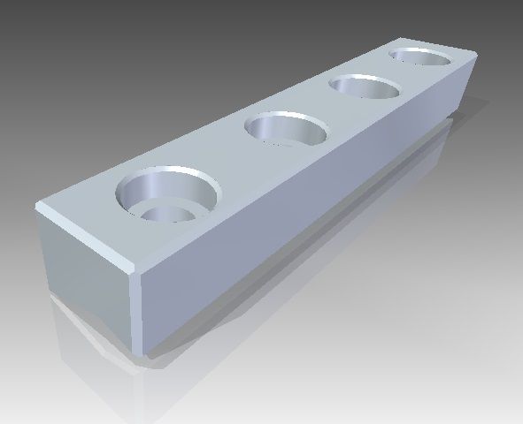

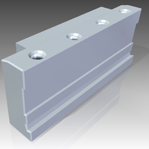

      I modelled the concept in 3D CAD using dimensions taken from my Bantam's Dickson QCTP and the published (minimal) information on the Korloy tool. I dimensioned my holder to take only the 2.4mm blade, thus avoiding unnecessary projection of the toolholder beyond the blade.
      CAD assembly
      Toolholder body
      Clamp bar

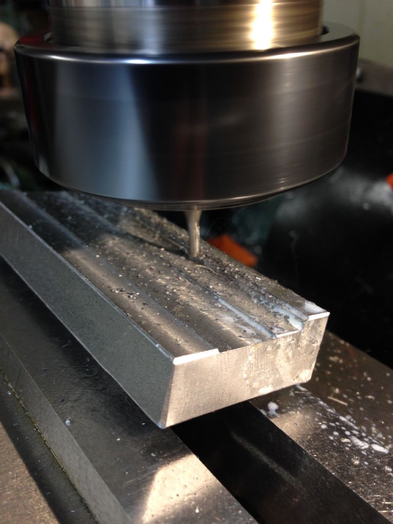

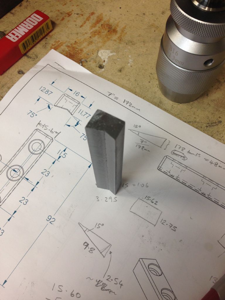

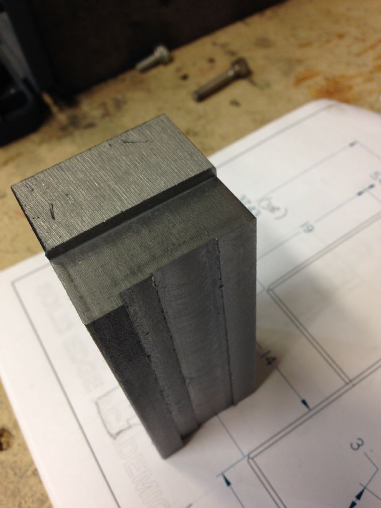

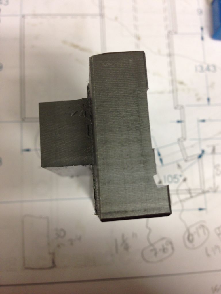

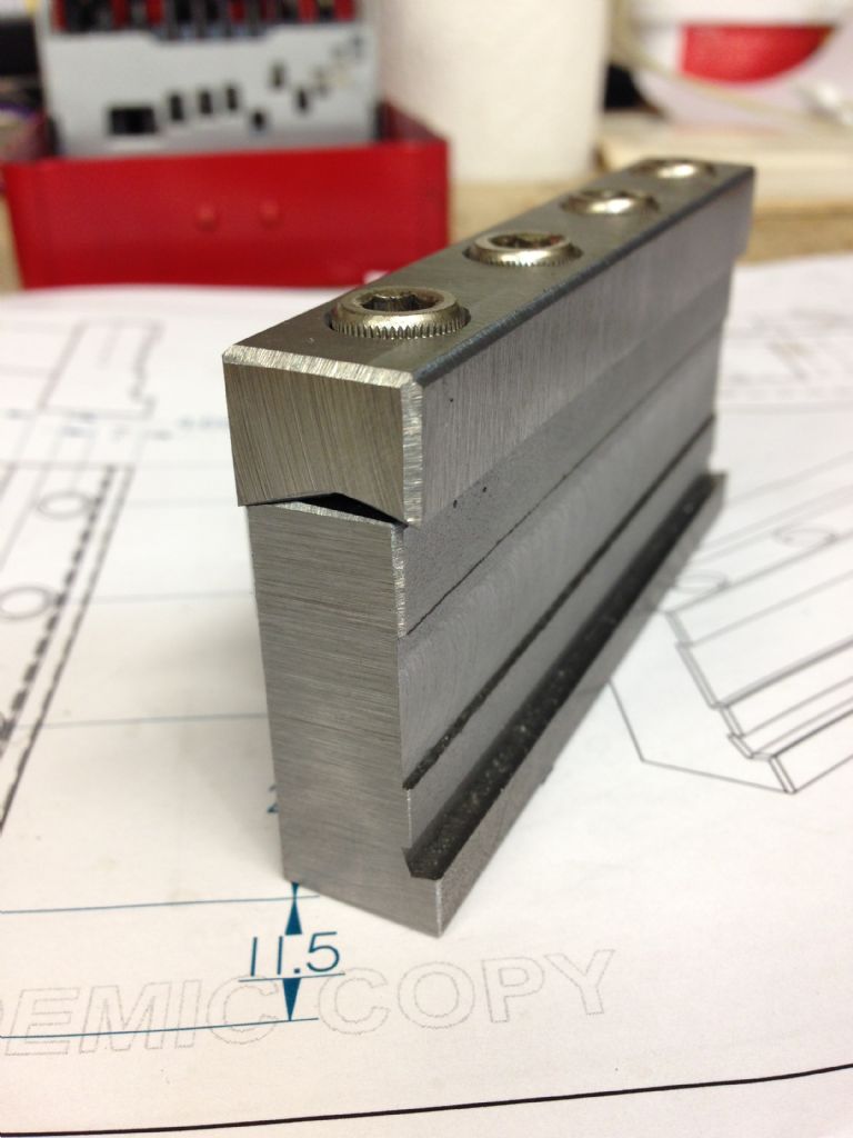

          The body was made from a piece of 1.5" square mild steel and the clamp bar from a piece of 3/4" round high carbon steel. I will harden and temper the clamp bar later – once I've been able to try it out with the real life blade and show it won`t need to change.
          Roughed out face
          Machining the slot
          Machined toolholder
          Clamp bar
          The machining seems to have gone well. Since fitting the DRO on the milling machine, the degree of human error has been reduced and maintained at previously unsurpassed levels and the time to machine parts has come down nicely too. I can also report that finishing and chamfering the parts on a belt sander is an improvement over files and sandpaper. Complete assemblyComplete assembly

            Nice looking CAD models, are you using some sort of shading effect? Oh, and the block looks pretty good too. laugh
            Regards,
            Andrew
            #136343
            Muzzer
              @muzzer
              Yes, you can set lighting position, shadows, definition etc, so I thought why not have a play! I could have done with changing the colour to get a bit more contrast but this is a CAD tool, not some fancy publishing software. It didn't make the machining any quicker or easier, mind.

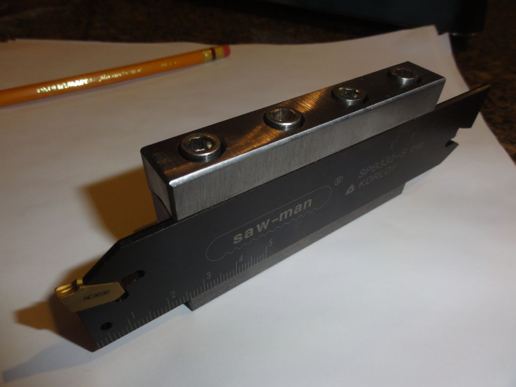

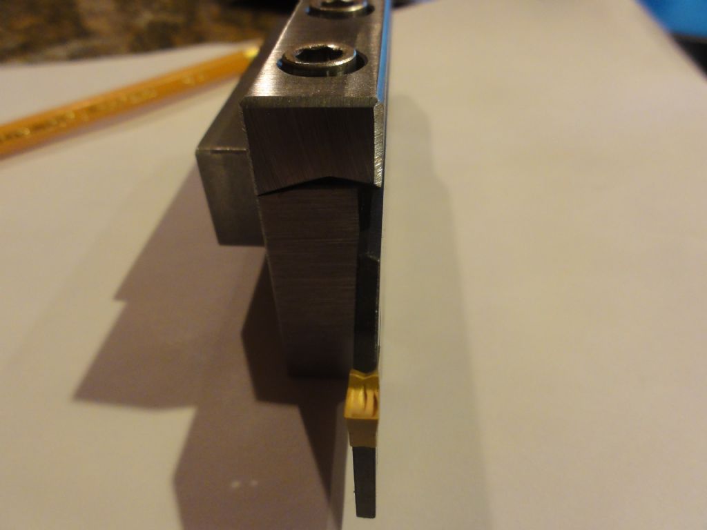

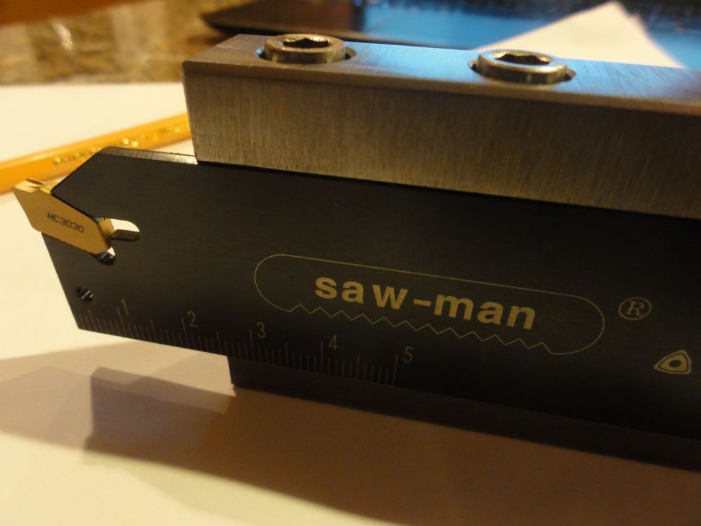

                Woohoo! The postman finally arrived, bearing goodies.
                Here's what I found when I assembled the blessed blade into the tool holder assembly:
                Assembled
                End view
                Side view
                End-on view
                I think I can probably declare myself fairly happy with the result. Seems to have come out pretty close to what I modelled, despite having minimal info to go on. It could almost have been planned!
                Obviously at some point this weekend I will need to actually attempt some form of parting off operation. But I need to gloat a bit first….

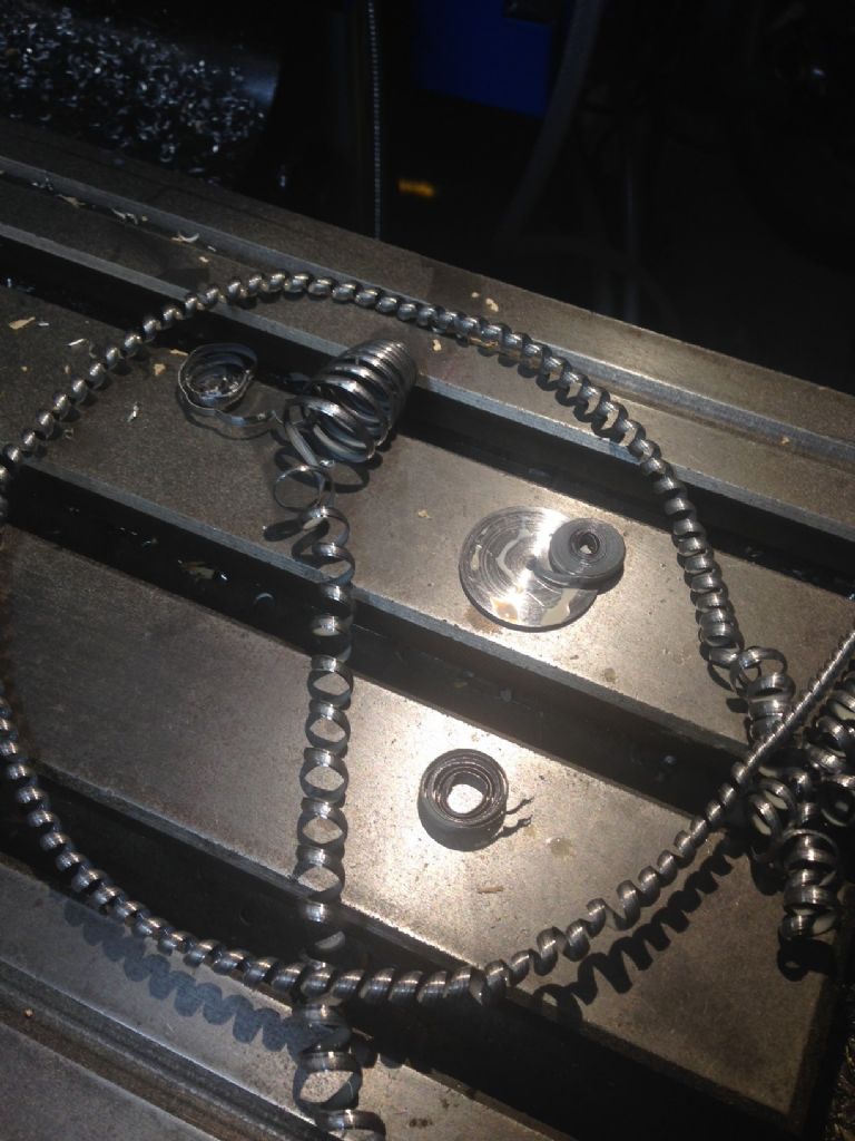

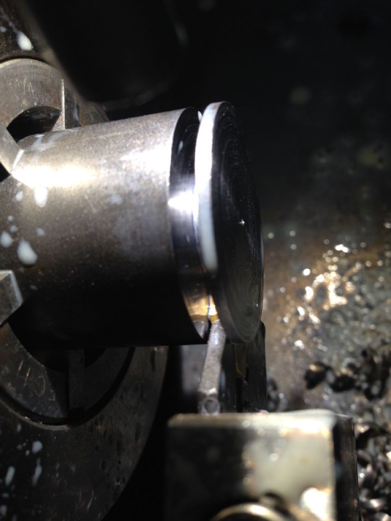

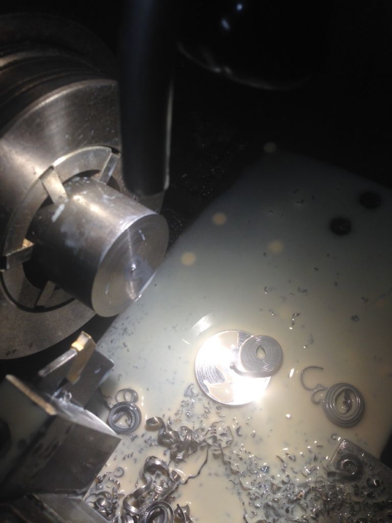

                        The moment of truth finally arrived, so I ventured out to the garage wearing my best rubber underpants. Who knew what could happen?
                        The first attempt wasn't entirely fulfilling. I pussyfooted about with what I calculated to be 2.3 thou per rev and about 400rpm with no coolant. I also discovered later that I was the best part of 10 thou below centre height. This resulted in several noisy but successful partings – but the surface finish was pretty nasty (little bits seemed to be welded to the bar surface) and there were some nasty grumbling noises going on. Not good. This didn't feel like the experience I'd been hoping for.
                        So after some researching and thinking and advice, I changed tactics. I checked everything was nicely nipped up, the tool was centred over the cross slide and a couple of thou above centre height and went for 5 thou per rev and 500rpm with flooded coolant, stopping half way in and upping the speed to 1000rpm (this was a 1" dia mild steel bar). Excellent result – no chatter or judder, nice clean surface finish, "approved" swarf and no nasty grumbling or snatching. Callooh, callay!
                        4 thou per rev, 500rpm
                        Finished at 5 thou per rev, 1000rpm
                        The swarf and the disk
                        The last photo shows a whole parting event in swarf. Started out as a long, tight spiral, then progressed to longer curls as the groove deepened, then ended up with a series of watch springs that were generated within the groove. A bit unnerving watching these build up before finally coming free but the swarf is narrower than the groove due to the design of the chip breaker so isn't likely(?!) to jam. I found the swarf to be typically about 7-8 thou narrower than the 3mm nominal tool insert.
                        Its probably a bit early to start believing this is the end of the story but it seems to vindicate the idea that you need to steel(!) yourself and go all in with the recommended feeds and speeds. In the interests of science and a more predictable outcome in future events, I should explore the limits of chatter-free operation. It seems that there are typically regions of instability where combinations of feed rate and cutting speed result in chatter. This will depend on my machine as well as the dimensions and material of the workpiece.
