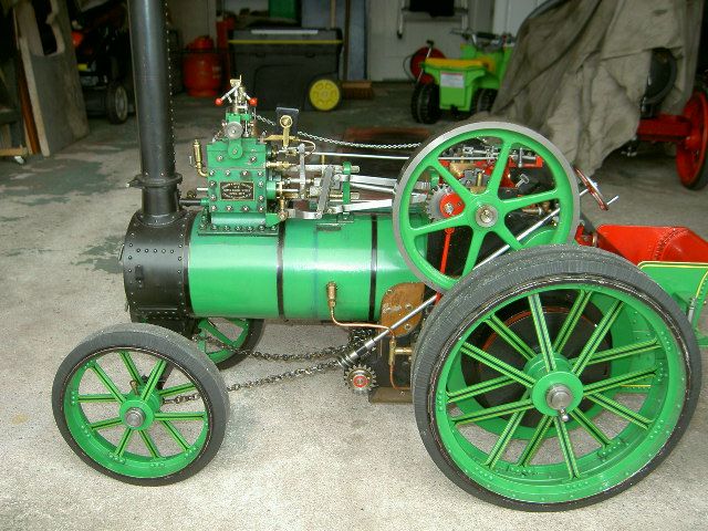

          MichaelR
            @michaelr
            I used Black Friar High Heat Resistant Matt Black paint on my D&NY smoke box which is good for 600C, the paint has stood up well over many years of steaming.
            MichaelR.

            S.D.L.
              @s-d-l
              Posted by MichaelR on 08/04/2020 14:31:34:
              MichaelR.
              Was that direct onto steel or with special primer?
              Nice Engine
              Steve

              MichaelR
                @michaelr
                Steve
                The paint was applied direct onto steel after cleaning bright with abrasive cloth.
                Link for application instructions.
                MichaelR
