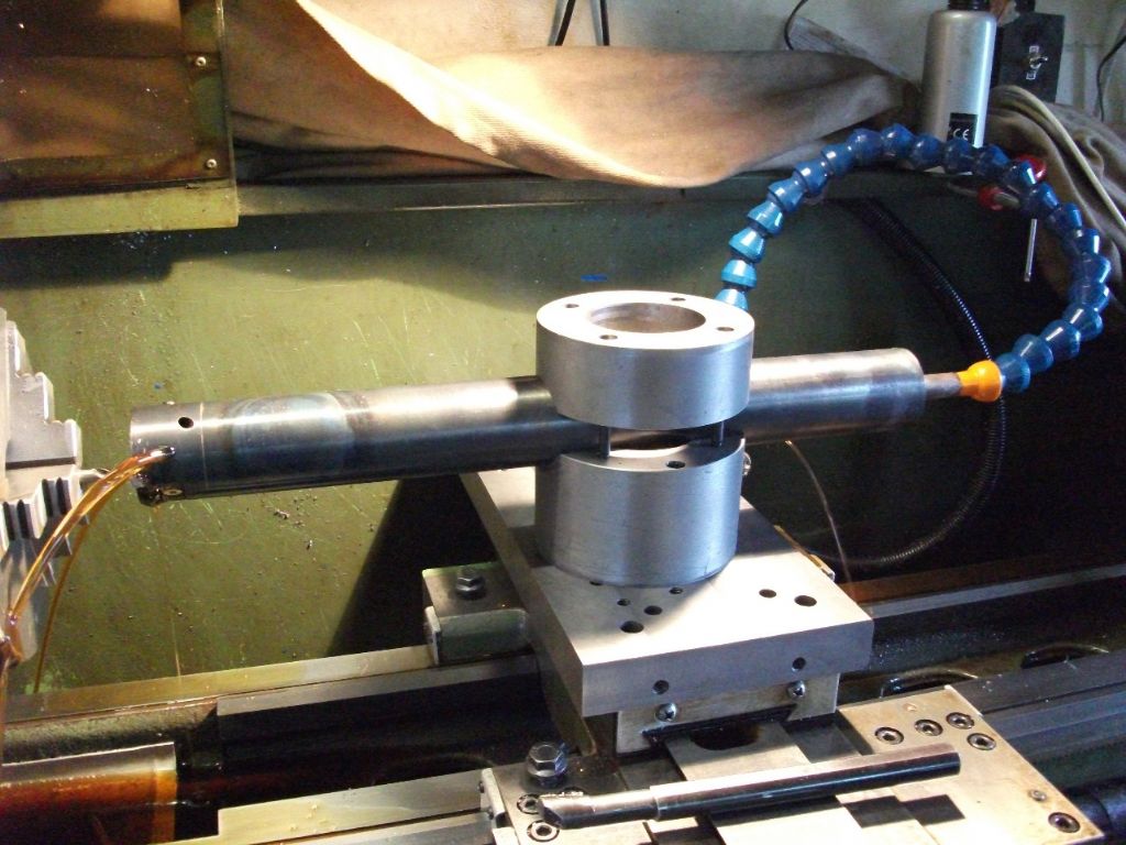

                                            oil1.jpgoil2.jpgHI choochoo baloo
                                            The coolant system that you have listed is unlikely to be able to
                                            pump neat cutting oil. I too bought from Axminster a coolant system
                                            20 years ago which was similar to the one you have indicated and
                                            tried to use with neat cutting oil , it failed and i sent it back .
                                            I bought from them a better system that uses the more commonly
                                            seen type of coolant pump seen here in the J&l advert and it worked.
                                            To improve the flow rate the pipework mush be large enough to
                                            place little restriction on the pump ,i use 15 mm copper tube and
                                            the same bore plastic tube ,placement of the pump relative to the
                                            work to keep the pipework of minimum length and keeping the
                                            pumping head low will increase the flow rate.
                                            I use neat cutting oil Excelcut 401 in 4 machines and Excelcut 433
                                            in the Universal grinding machine ,they all use the same type of pump.
                                            The J&L advantage adverts are from May last year but come around
                                            often.
                                            The sort of flow can be seen from this boring bar.
                                            Edited By John Pace on 27/06/2017 14:28:15
