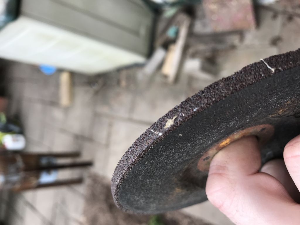

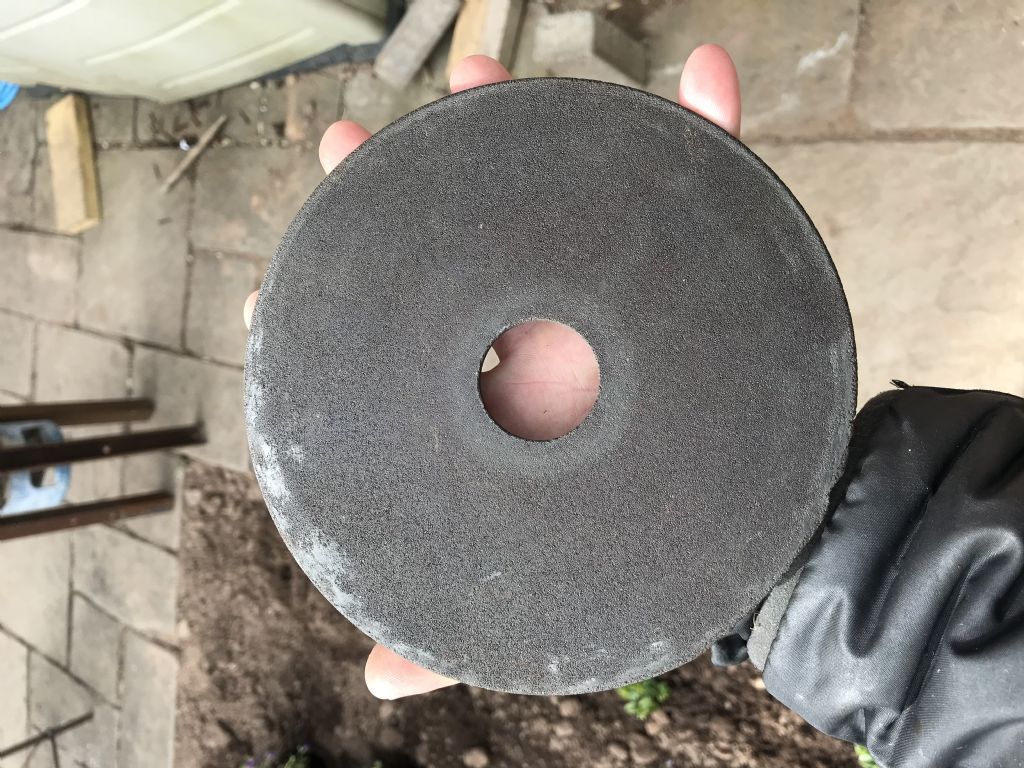

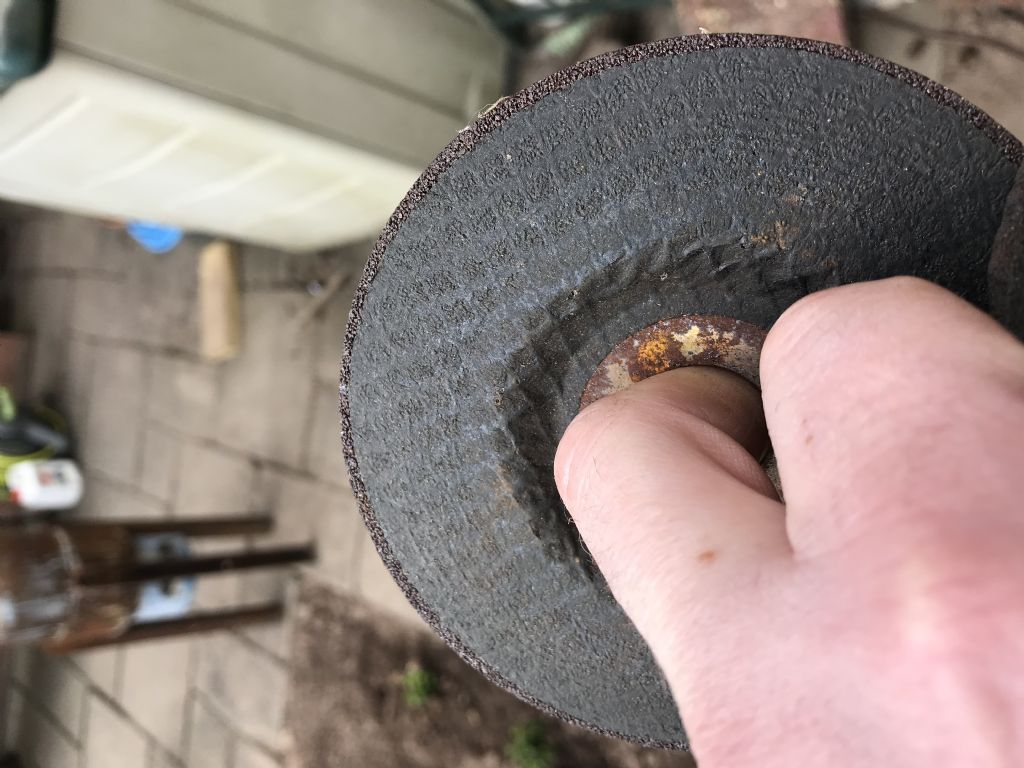

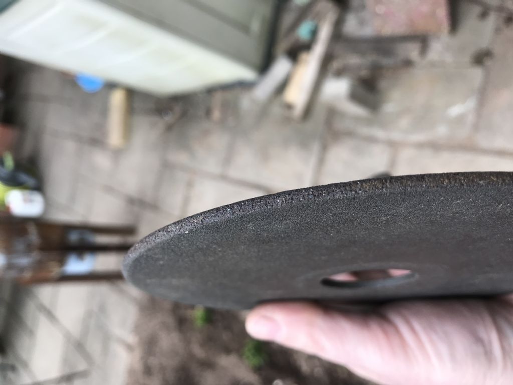

                          This:
                          is a cut off wheel for a surface grinder. I’m not going to run it because it has lost its speed markings, but compare with a 41/2” angle grinder wheel:
                          The surface grinder wheel is 3mm thick. I picked up a grinding rather than cutting disk for the angle grinder as it’s easier to photograph the edge, but essentially grinding and cutting disks for hand held use are pretty much the same (bar thickness).
                          Notice how the Surface grinder wheel looks the same in grit and such, but is missing the reinforcement mesh. That’s because a surface grinder operator is not likely to bump or twist the wheel in operation. No matter how careful the operator of a hand held grinder is their guiding ability is not the same. That reinforced wheel also has a higher speed capability- precisely because it is reinforced. That in turn means you can take a “bigger” cut with it because the number of teeth going past the cut per second are larger. A massive bonus for hand held work, as no one want to be holding the angle grinder for longer than required.
                          I have SG wheels which are basically worn (used) to the hub of the grinder so 4” or so. That they are used that far shows they still work ( most of them came second hand with my grinder).
