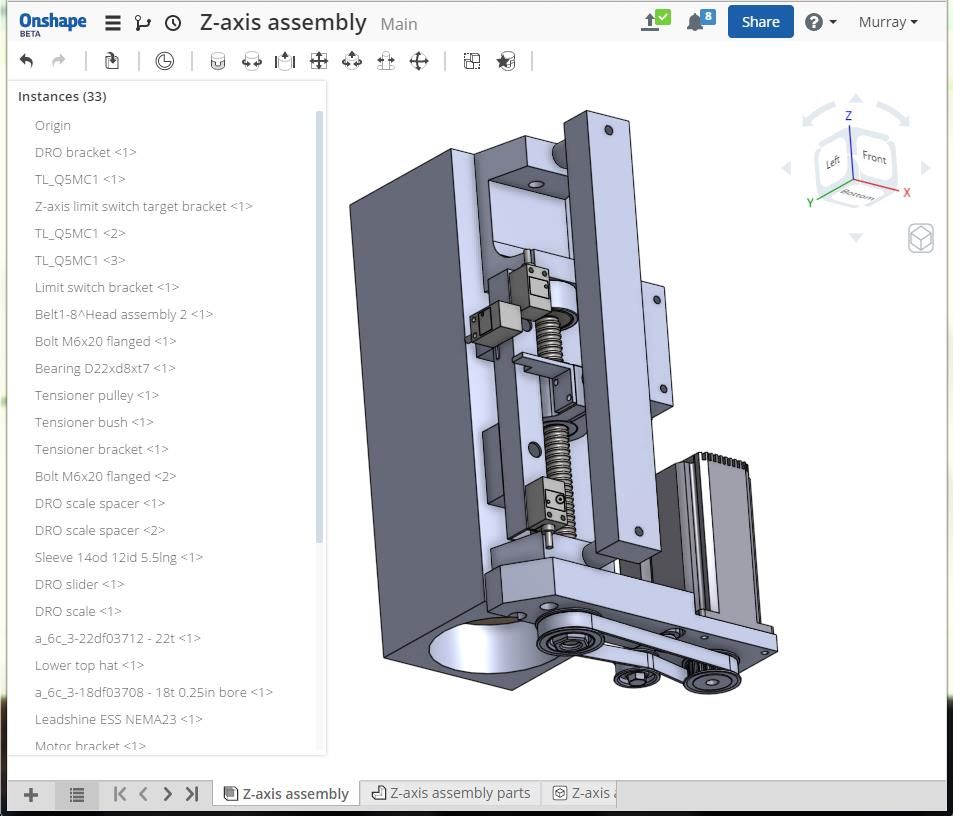

            Here's a couple of screenshots.
            This is an assembly I imported into OS from Solidworks (in Parasolid format). I didn't have time to make the parts in OS as I've been quite busy of late. They aren't actually mated yet – the mates can't be brought in when you import an assembly. You can see the various mates available on the toolbar under the title.
            Z-axis assembly

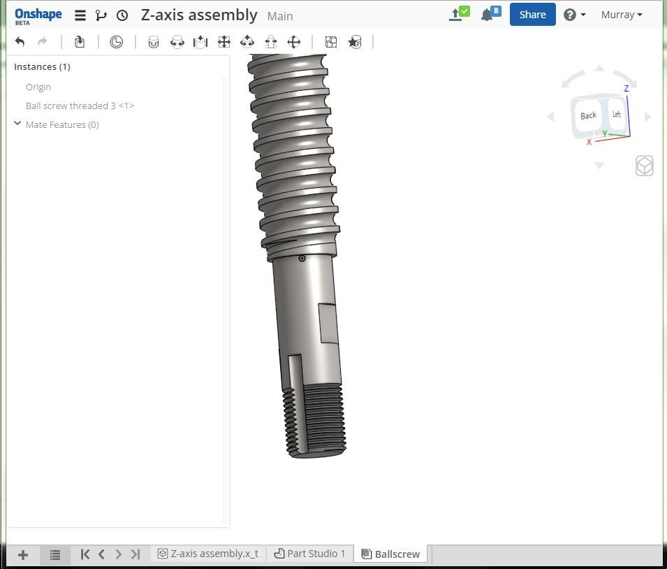

            This is a ballscrew, showing the rather fine rendering of the (cosmetic) thread.
            Ballscrew

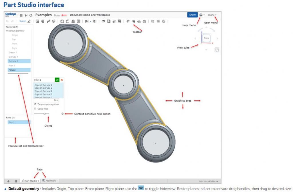

            Here are the various toolbars that you use.
            Toolbars
            And this is what the screen looks like when you are making a part.
            Interface
            One of the biggest issues I found was the current lack of support for the 3D mouse I'm used to. The other programs (SE, SW, Inventor etc) support them but OS hasn't implemented it yet. The right button and control button do rotate and pan.
            I'm planning on adding all the mates back in to the assembly next.
