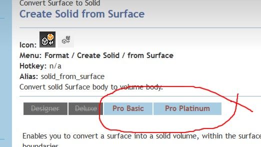

                    Create Solid from Surface ?
                    **LINK**

                        #273809
                          Posted by Ed Duffner on 26/12/2016 17:07:58:
                          **LINK**
                          That's where I discovered it only works in Pro and Pro Platinum

                                TC Deluxe cannot create solids. All 3D models are hollow surfaces.
                                The Pro versions create solids by default.

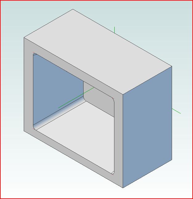

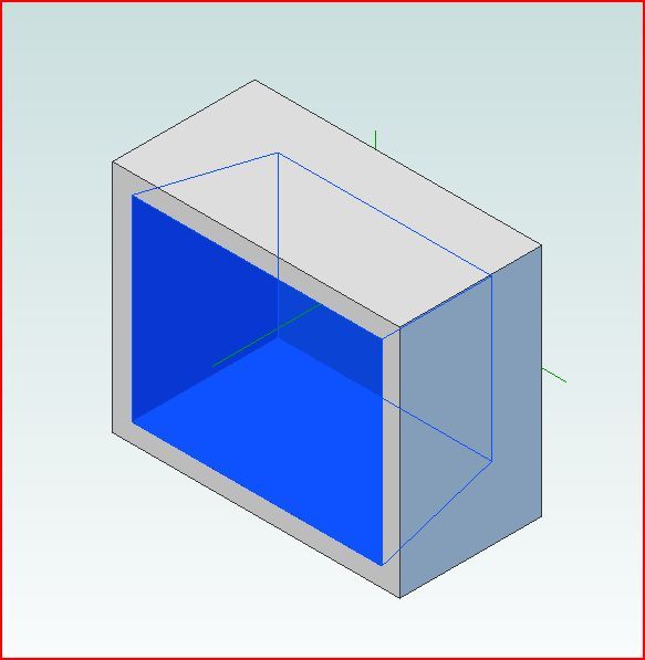

                                                #273892
                                                  It's version 9.
                                                  As pointed out all TC deluxe 3D shapes are 'surfaces' which doesn't seem to upset a 3D printer.
                                                  This makes the problem (solved by another approach) curious:
                                                  If I place a cube to go through one side of a larger cube, then subtract it, I get a shape a bit like a Belfast sink. But i want a tapered shape more like a bath tub.
                                                  If instead the two shapes are lofted with a taper, rather than extruded squares, then a hole is cut in the intersected side of the larger shape and no surface is created for the 'inside' of the bath i.e. it isn't a 'closed' surface any more.
                                                  Weird.
                                                  I solved it by subtracting an extruded rectangle with rounded corners from a larger one, then moving the points at the narrow end of the taper towards the mid-line. This kept the radius of the corners constant bit anglesd teh edges, which looks fine.
                                                  #273896

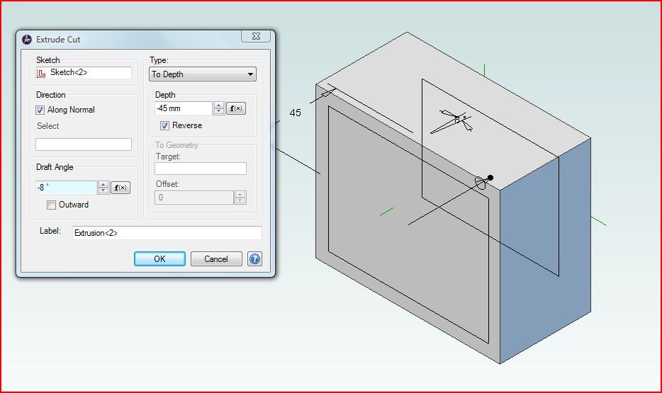

                                                    Neil, can't you extrude cut with a draft angle? Alibre allows that not sure about your TC.
                                                    Edited By JasonB on 27/12/2016 13:32:36
                                                    #273901
                                                      Not in deluxe.
                                                      I did get there in the end, any guesses what this is?
