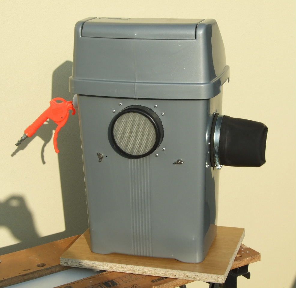

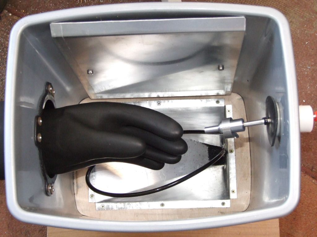

        A little something I knocked up to make sand blasting the odd brass fabrication easier. Given the high air supply demands of commercial cabinets, I decided to make something a little less bulky and that would work off my shop compressor.
        Regards
        Gray,
        view from the rear showing rubber glove attachment and filtered air exit.jpg
        inside the top of the bin, note battery operated led light with protection screen.jpg
        all the workings, sump pan directs media to suction pipe. filter protection baffle at the rear also reflects light from the led.jpg

          Graham, have you got a few more details of teh actual "gun" part that looks like it is powered by a standard blower nozzle?

              You covering the screen with plastic, like you get from cracker boxes?

                      What a great idea! Would love to know more, particularly about the 'gun' part.

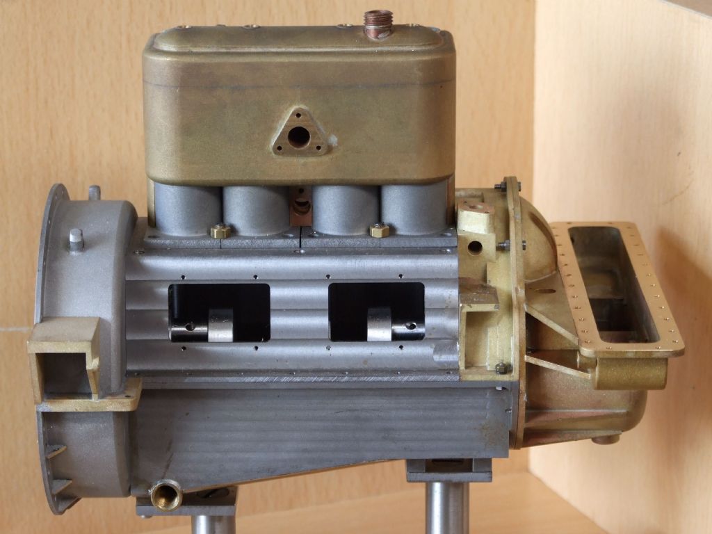

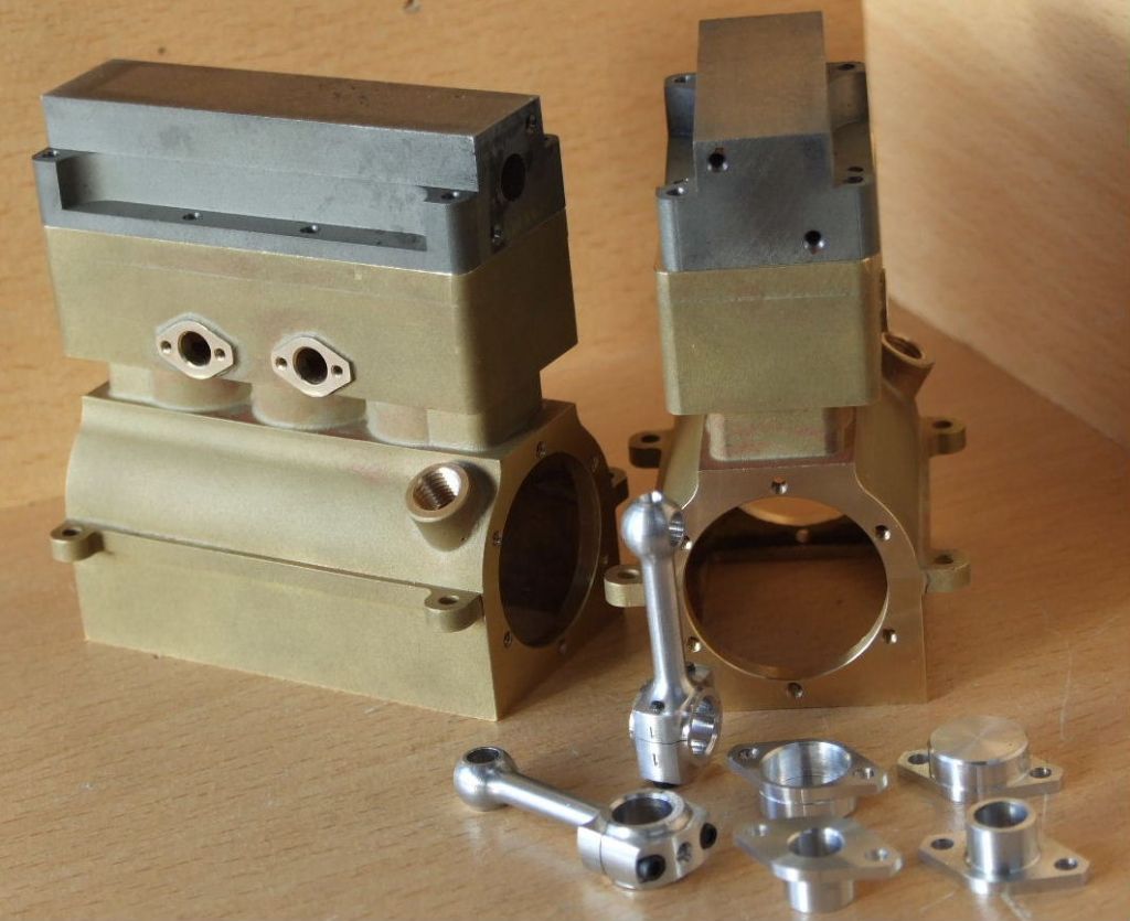

                        Here are a couple of examples of the work done with the unit.
                        The nozzle is the heart of the matter and if Neil would like a write-up on how I went about making this unit I will oblige.
                        fig crankases, embryo cylinder heads, con-rods and rotary valve endplates.jpg
                        Regards

                            There is a drawing of the commercial gun here:
                            **LINK**
                            Both the Air nozzle (brass) and Abrasive nozzle (ceramic) are replaceable as they wear away with use.

                              Is the viewing panel sheet acrylic?

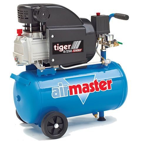

                                My compressor is not 3hp, Not sure what it is, it came from the tip. Can it work in short bursts from a smaller one with a reservoir

                                      This is the size of compressor that I use. Okay if you use it sensibly.
                                      Regards
                                      Gray,

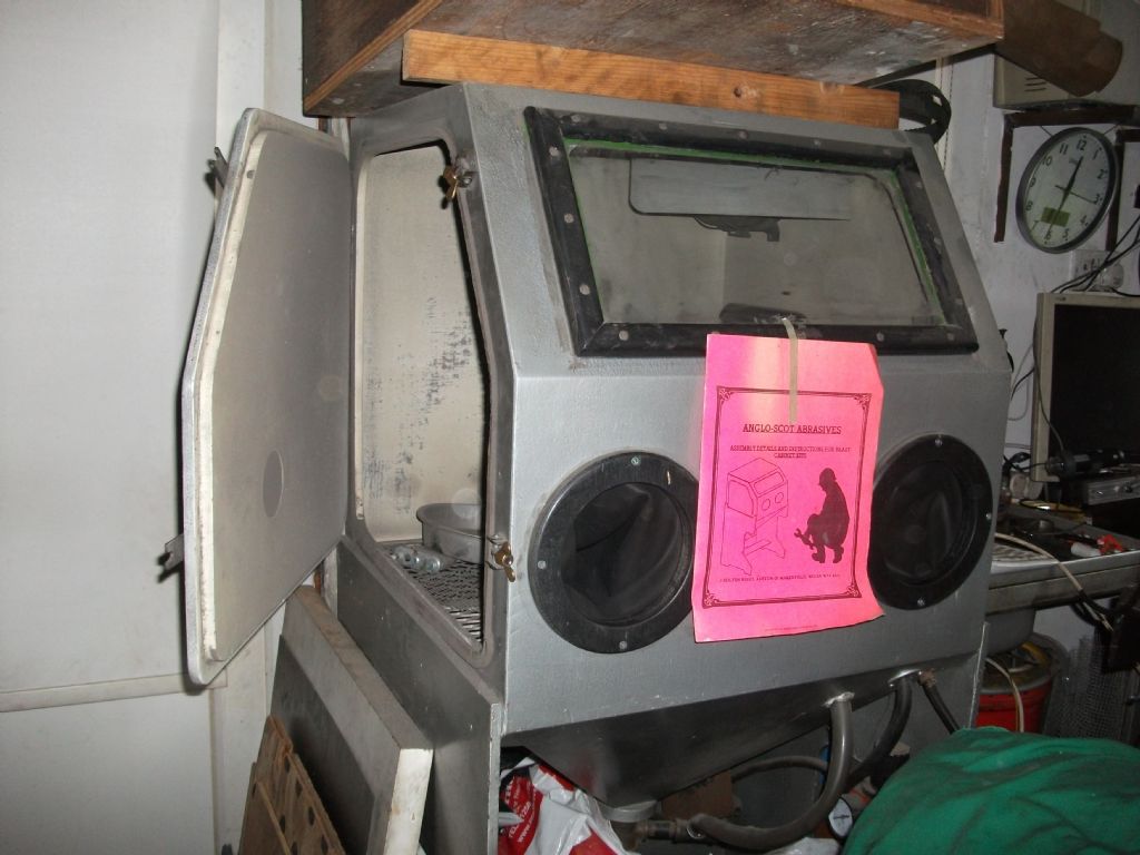

                                          I built one of these sandblast cabinets 20 + years ago from
                                          a kit of hardware parts and the drawings for the cabinet
                                          made from plywood,it will run all day on the same size
                                          of compressor.
                                          It looks as if the vent on the back of the bin blaster has a
                                          filter in it these are worse than useless as they block up very
                                          quickly so the dust finds the next easy route out.I doubt
                                          that it would be wise to use this inside the workshop you
                                          would find out why the next time you use your lathe.
                                          My own cabinet is sealed and vented externally.
                                          Rubber gloves 24 inch in length are avalable from J&L
                                          Pt no GLV-90082E.

                                            I keep my unit in an annex, it does not take up any real-estate in the workshop proper, (I cannot afford to waste the space) and is used mainly in this location. As regards costs, this unit cost no more than £20. Some of the items were ex-stores stock, others were salvage items.
                                            My first lash-up for the "blast box", a wooden box with a perspex lid, had no ventilation to the outside as such, but instead had a connection to the shop vacuum. In this design the need for the vacuum was felt unnecessary, but builders can fit one if they wish, using many of the domestic waste fittings. Two years on of occasional usage the filter is still clean. No doubt my internal baffle allows the heavier particles to fall before the air exits the filter.
