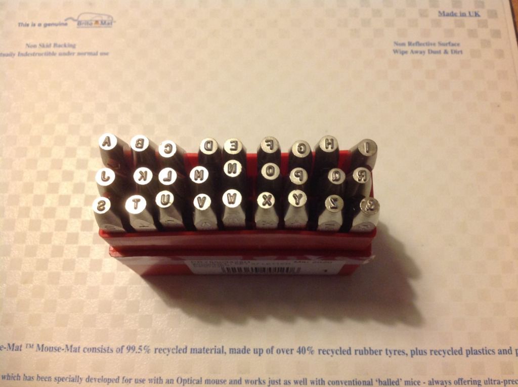

                            An update [kind of] to this thread.
                            The Impresart ones were unsatisfactory, with some letters upside down in relation to the shank orientation marks and some letters with defective or missing serifs. They were returned.
                            So I settled for one of Zoro's Kennedy sans-serif sets. These were fine until last week when a piece broke off the most used letter [used about a dozen times on brass and mild steel only].
                            I bought a replacement for the damaged letter and a back-up for another letter, allegedly compatible with the original set, except they aren't, being in a markedly different font.
                            At the same time I bought a Pryor set of sans-serif, 2mm in height. The problem with these is visible in the attached photo. Several of the letters are eccentric on the punch body, meaning that when I use them in my improvised jig [my milling vice and a hex head side screw for "indexing"] I cannot get equal spacing with some of the letters except with a lot of trial and error. In contrast the Kennedy set are all perfectly centred and with my jig I'm able to punch quite long strings of letters very evenly.
                            A question that arises is does anyone here have a recently or not so recently purchased set of Pryor punches in which one or more of the letters is conspicuously displaced from the centre of the body? You can see that the worst offenders in my set are the E,I,U,V,X.

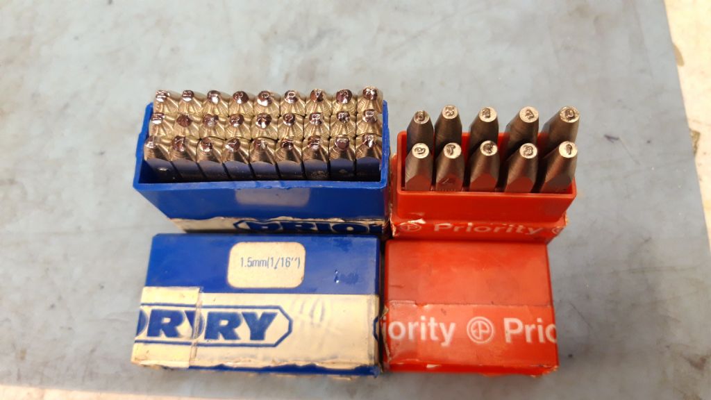

                              I thought I had a set of Pryor letter punches but it turns out I haven't! My 1/16" punches are made by Priority (made in England) and Priory (don't know where they were made)
                              But anyway they seem to be aligned okay.
                              Is Pryor the same as Priority the same as Priory????

                                I can't really make out the faces of your 1.5mm letters. In the number set to the right the 7 looks decidedly off-centre. Is it just perspective?
                                Off-centre characters are obviously not a problem for casual marking, especially with single letters, but spacing them evenly in a row using your own jig or one of the off-the-peg multi-character typeholders is going to make alignment difficult if not impossible in practice.
                                Those typeholders do not have accompanying spacers, so either punches/type with off-centre characters are assumed by the manufacturers not to exist or their existence is tacitly acknowledged but the misalignment problems they cause is assumed to be a matter the end user should easily be able to get around or be indifferent to.
                                I'm sorry but I don't know what connection if any there is between Pryor, Priority and Priory.

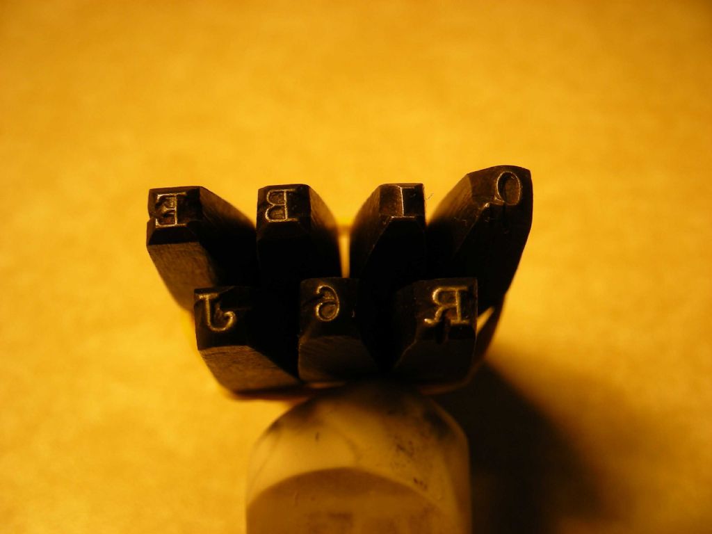

                                  These old punches look hand made; if so, I marvel at the maker's skill:

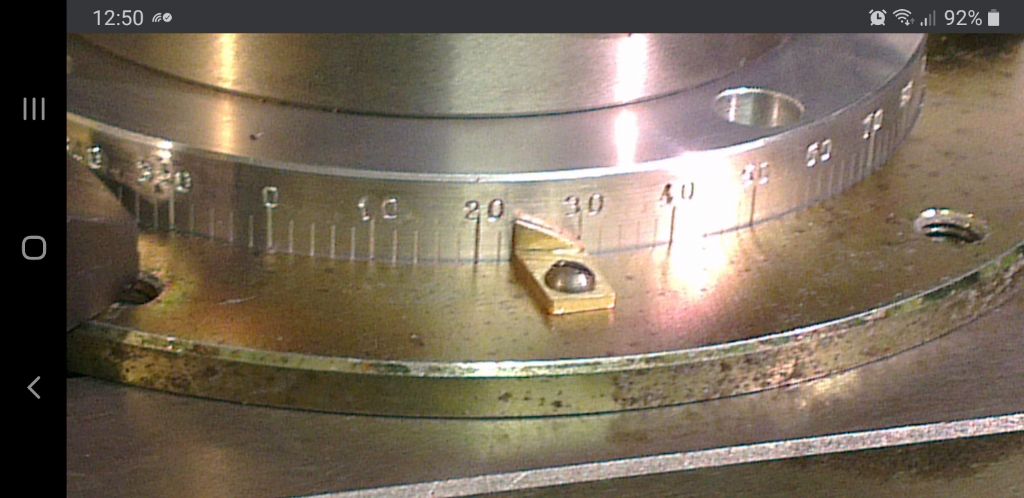

                                    I think it's just the camera angle Bill, here is a photo of a simple dividing head I made a while back, the graduation numbering was done with the same 1/16" punches with a rubbish jig to hold them but they came out okayscreenshot_20201218-125030_chrome.jpg

                                      Pryor and Priority appear to be connected. They both use the Pryor trademark EP in a circular shape. Don't know about Priory.

                                          I have recently bought 1 mm sets from Pryor and use them in a jig and they are all perfectly aligned. When I bought them I asked about alignment and they assured me they were perfect and they were.

                                            Bernard, just to clarify, are your 1mm sets punches or are they type [intended only to be used in a typeholder, or jig of your own devising, unlike punches, which can be used freehand as well as in a jig]?
                                            The reason I ask is that Pryor seem to make greater claims of accuracy/uniformity for the type than they do for the punches. Even so, the present set of punches is too inaccurately made to be anything other than a nuisance to work with.
                                            For the record I think I should point out that a character that is visibly off-centre on the face won't necessarily be off-centre on the body, because it may be that the table the character sits on is itself off-centre the other way in relation to the body. The acid test is how the punched marks align when the shanks are evenly spaced using your jig. Unfortunately in my case the visible off-centredness is actual off-centredness as well.

                                                  Just to update, I'm pleased to say that Pryor, who were very responsive to my inquiry, have replaced the whole set of letter punches free of charge.
