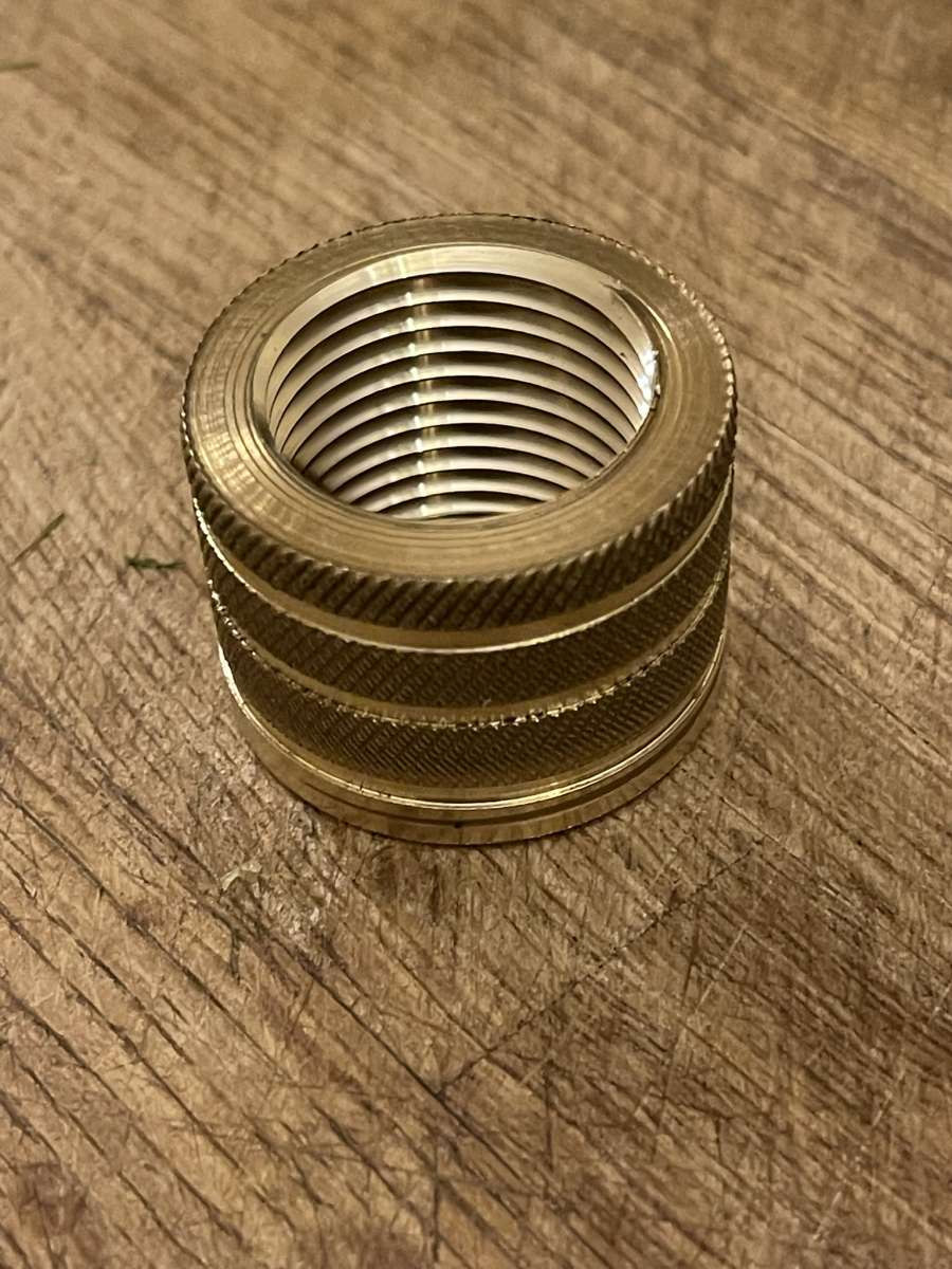

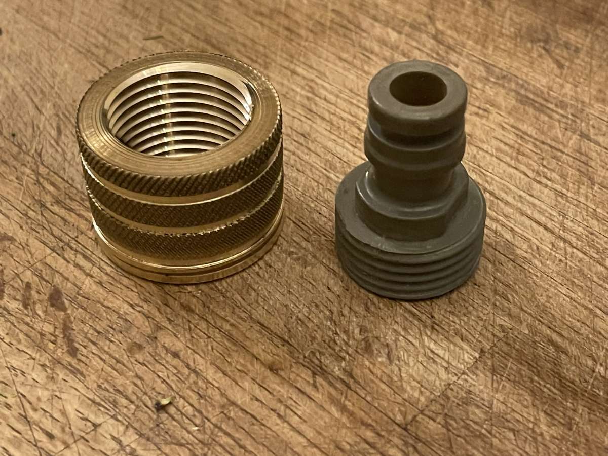

      Another one for collectors and aficionados of obscure threads….I bring you “Garden Hose Thread, or GHT.
      (And I am well aware that that sort of comment will produce a deluge of messages telling me that it is not at all obscure, however it is to me.)
      My wife purchased two lengths of “sprinkler hose”, flat section hose with 3 channels and pierced on both sides for watering a specific area. She was dismayed to find that they didn’t just ‘connect’ and that she had to pay yet another £15 or so for the adapter. I agreed to ‘sort something’ assuming that the end cap on one hose was simply a 3/4 BSP, as most things are around here. Actually the diameter seemed ok – but not the thread. On closer examination, the thread didn’t fall into any of the imperial thread gauge options (11, 12,13 or 14TPI), nor the metric alternatives (1.75, 2 or 2.5mm).
      A manual count and measure suggested around 2.25mm……which is suspiciously close to 11.5TPI. Further communication with Mr. Google revealed Garden Hose Thread, 1 1/8 by 11.5TPI….

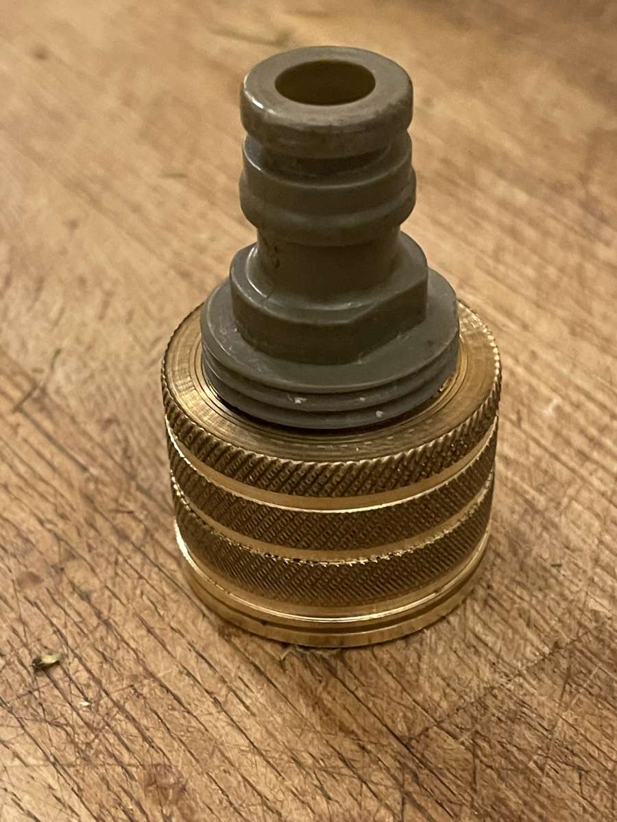

      One lump of brass and the ELS later (thankfully it had 11.5TPI as an option) and we have an adapter – as below.
      IMG_8208
      IMG_8209
      IMG_8210
      So now you know…..

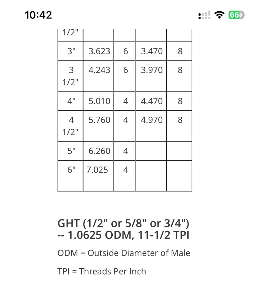

      #811374
        11.5 is NPT The American pipe thread. Just like BSP it is based on the bore and not the OD
        #811377
        Nicholas Farr
          @nicholasfarr14254
          Hi, yep, it’s 1″ American National Pipe thread. Straight is N.P.S, taper is N.P.T., both of which taps and dies can be had from Tracy Tools and others in the UK.
          Regards Nick.

                simondavies3
                  @simondavies3
                  Thanks Jason et al, no clue why it didn’t immediately come up as US NPT – too quick to accept the info from my phone I guess:

                    Simon, how do each side of your adapter seal?
                    Ian P

                          #811440
                          simondavies3
                            @simondavies3
                            Ian P
                            There is a rubber-like sheet washer that the end of the connector either buts up to inside the fitting – or in my case, buts up against the end of the corresponding hose adaptor.
                            Exactly the same as the flat rubber washers in tap adapters.
