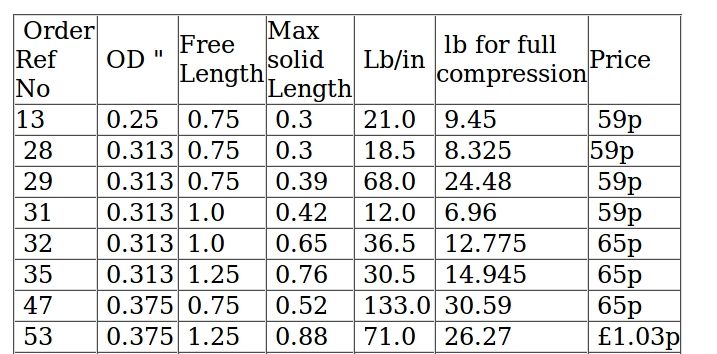

                        YES, I did think about question 3 quite alot , but my reasearch did not give me an answer that I understood.!
                        As follows
                        If using compression springs for suspension on locos, bogies, etc we recommend you decide what weight you need that item to be able to carry (or its resting weight in the case of locos) then double it for the lb at full compression. If you then put a spring (or multiple if need be) on each axlebox to meet that maximum compression then when on the track the axleboxes will sit halfway up in their slots/ on the spring meaning they have movement both up and down to follow the track.
                        springs
                        so if my loco weighs say 100 – 120 lb doubled gives 240 lb = eight springs at 30 lb ?
                        So ref. no. 47 springs needing 0.75 inches in th hornblock?
                        The above description was not very clear to me, have I now got my understanding correct?
                        I still do not understand max solid length or lb / Lb
                        With Thanks
                        Pete

                          Pete the data in the spring table gives you the following.
                          OD – simply the outside diameter of the wound spring, the Free Length is the overall length (or height if it's vertical) of the wound spring just sitting there with no load on it. The Max solid length is the length of the fully compressed spring with all it coils touching – "coli bound". It won't get any shorter and it won't fit into a smaller space. The Lb/in is the "spring rate" ie how much load you'd have to apply to shorten the spring by 1 inch. So the "load for full compression" is the maximum load that any of those springs will support when JUST fully compressed. Taking the first line the difference between the free length and the max solid length is 0.75-0.3 inch or 0.45 inch. Now the spring rate in 21 lbs/in so 0.45 x 21lbs give you the 9.45 lbs that the spring will need for full compression – and still be a spring. If you loaded that particular spring up beyond 9.45lbs it would still support that load but would in effect be a solid tube with no spring in it until the load dropped below the 9.45lbs at which point it would start to extend again.
                          From that table you can work out what length any of those springs would be at a given load and then you can see which of them will fit your application or conversely how much room you need to allow in order to be able to fit springs.
                          Another point to bear in mind is that for springs used in parallel (side by side) you add the individual spring rates to get the overall rate, for springs used in series (end to end) things get more complicated and you have to use
                          (R1 x R2)/(R1+R2) to get the effective rate where R1 and R2 are the spring rates of the separate springs. The overall effect of springs in series is that the net spring rate is lower than that of either of the individual springs

                            Thank you Keith for that detailed explanation, I understand the table now.
                            What I am seeing is that with say the short 0.75 springs there is not much difference between free and solid length. In the case of type 47 on 0.23.
                            So what I think I was originally trying to find out, in hind sight, was how much suspension travel is a reason amount to design for.
                            I am working from drawing form 5g drawings in M.E. which show horn brackets at 2 inches and as I said with bearings at 26-28mm only leaves 19 ish mm for the springs to live in. This is not exactly my area of expertise but understand that "proper" loco builder do use ball bearing?
                            With Thanks
                            Pete
