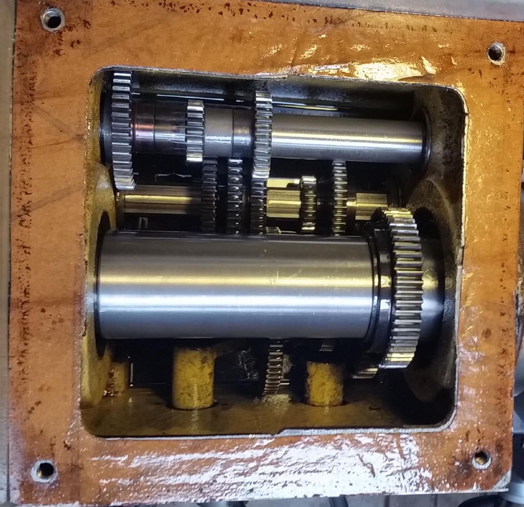

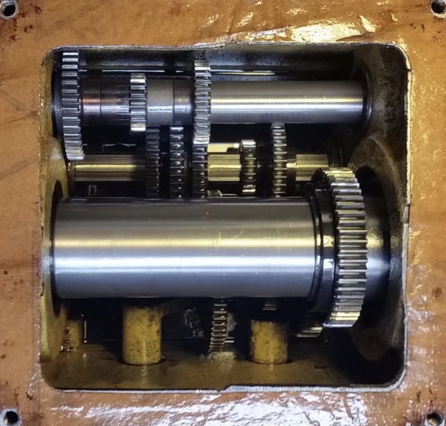

                        #451514
                        Geoff Causon
                          @geoffcauson89285
                          gearbox gasket.jpgDave, you are correct. That's the reason I over-filled it, in an attempt to get that gearset to pick up.
                          I made a clear acrylic lid (as suggested by Nigel B) & filled it a bit more to get those gears lubed.
                          The groove around the housing is sealed by the gasket, so is not draining onto the main bearings.
                          It's hard to get a decent photo, but the spindle gear & it's driver are misaligned by about 3mm. The spindle gear shows damage, but it's not as bad as it looks in the photo. I just wonder what the mating gear looks like.
                          I investigated spare parts, the big one is listed but not the small one. I'm not brave enough yet to ask prices, no use just replacing one anyway.
                          Regards, Geoff.
                          Edited By Geoff Causon on 10/02/2020 05:26:43

                              #451523
                                Posted by Geoff Causon on 10/02/2020 05:26:07:
                                I hope you don’t mind, Geoff … I have straightened your photo a little, and cropped it to reduce the distractions:
                                It may be an illusion, but … the gear at top centre of the image looks to have damaged/worn teeth
                                Edited By Michael Gilligan on 10/02/2020 07:26:58
                                #451543
                                Dave Halford
                                  @davehalford22513
                                  Regards, Geoff.
                                  Geoff,
                                  Is that groove covered fully by the top plate?
                                  The groove has to be there to either help prevent oil leaks (and be covered by the plate) or aid bearing lube as well if not covered by the plate (which means the gasket may be wrong.)
                                  How far above the window is the oil level now? Hopefully below the lowest shaft bearing or it will leak quite a bit.
                                  Have you tried a magnet in the oil?

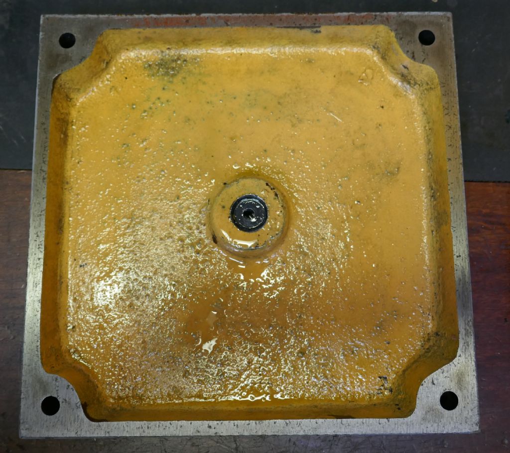

                                  #451556
                                  Russ B
                                    @russb
                                    One of the Lathe headstocks I'd worked on had a broke ridge line in the lid above the spindle which allowed oil to run off and drip on the gears below, the last of the ridges dripped into a reservoir cast above the nose bearing providing lube.
                                    Another one of them (Colchester) had a steel fabricated reservoir on top that directed oil to the various parts, including the clutches hidden away at the back of the box.
                                    It's for this reason that I don't use the Newton Tesla drive on my Myford 280 below 50%, as reducing the speed of the whole gearbox any further stops oil being thrown up from the bottom of the box to reach the necessary parts. I keep meaning to pop the case open and reprogram the pot to range from 50-150%

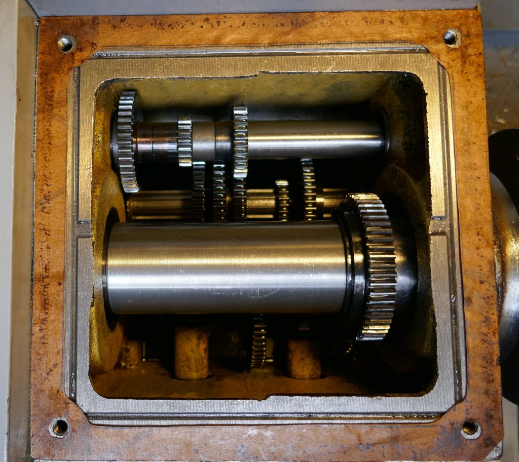

                                      #451651
                                      Geoff Causon
                                        @geoffcauson89285
                                        gearbox lid.jpg Nigel, the gasket may be wrong. It's hand made & much wider than the lip on the lid. Strange, I bought the lathe new & have not replaced the gasket. A proper factory one would be die cut. I can't see clearly enough through my perspex lid to check if the modified one drains, but it can't hurt.
                                        Like you, I suspect the sight glass is too low. The absence of any clever oil management features on the underside of the lid suggests the design /testing process was short. Also, the drain plug is too high, I had to make a vacuum sucker to drain the last half. It's all starting to add up.
                                        Dave, The new oil level is 18mm above the middle of the sight glass, & the lowest shaft is about 15mm below the sight glass. That's well below the new level, but I'm not at all worried about leaks. Every drop of oil I put on the ways & cross slide ends up swimming with the swarf. I wouldn't notice a weep from the gearbox.
                                        I like the idea of a catcher to direct more oil splash to the problem gears. There's plenty of room & the 2 center gear trains throw up lots of oil.gearbox gasket2.jpg
                                        #451659
                                        Hopper
                                          @hopper
                                          Your gasket mod looks like the way to go. The wide originsl gasket may have been handmade at the fsctory due to a shortage of ptoper parts etc. Chinese assembly methods have been known to be highly variable at times.
                                          #451665
