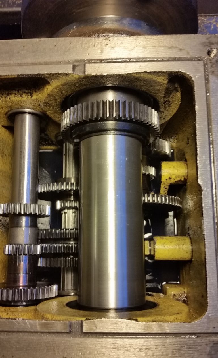

      gearbox.jpgMy lathe gearbox has (over a few years) become increasingly noisy. It's bad enough that it has to doing some damage.
      I have periodically changed the oil & carefully filled it to halfway up the little window.
      In desperation, I over-filled it with EP90 car diff oil & it now sounds "not too bad" ( Very scientific)
      It got warm after approx. 1 hours intermittent use, so heat may not be a problem. (car diffs get very hot).
      I filled it so the gear that drives the main spindle gear was just picking up oil. It is the highest pickup gear in the box.
      Is there a problem with too much oil?

          Not particularly comparable with a car differential – power transmitted is far higher for most cars, and also via a crown-wheel & pinion and differential gears – and they should not get particularly hot even though much smaller in comparison.
          With a gearbox, such as this, there should be plenty of splash lubrication and possible pumped supply to bearings.
          Over-filling will increase drag and therefore generate more heat, but also likely to leak from otherwise sufficiently sealed orifices.
          Gear oils with ‘hypoid’ (extreme pressure) additives should not be used in the presence of yellow metals.
          The manufacturers provide lubrication levels for a good reason.  Best to comply with those requirements.

            A bit more info on the make, model and age of your lathe would be very helpful.
            It it's an old lathe, it could be bearings worn out.
            If it's a Chinese lathe, some of them have been known to come complete with casting sand inside the gearbox cavity that eventually chews the bearings out. And the bearings are not the world's best quality either.
            Either way, adjusting the pre-load on the main spindle bearing may help. Or replacing the bearings with good quality such as SKF or Timken may help too.
            The other thing with some Chinese lathes is the poorly made steel gears tend to wear and also tend to "ring" more than cast iron gears used on older lathes. Generally speaking, a lot of the Chinese lathes run very noisy in the gears for this reason. Some of the larger ones I have seen are almost painful to stand next to in operation. Yet some others seem to run reasonably quietly
            It's unlikely overfilling the gearbox will do any harm other than a mess where it leaks out. It's a basic splash lube system, in accordance with the low speeds and loads involved (compared with say a 100hp car gearbox) so as long as the oil is up to the lowest rotating gear in the box, that should fling it all over the place and lube the bearings (which being rollers I presume, don't need a lot of oil) and gear teeth.

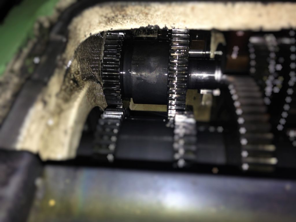

                      I bought a Myford 280 with a noisy gearbox, one of the interference fit gears had come loose and could slide left and right (correction, it could slide left, it shouldve been up against a shoulder on its right), I rebuilt the gearbox and there wasn't anything else wrong I could see (correction, something else was wrong, I don't recall what but you could "rub" gears together by pushing the selectors in certain directions, something wasn't aligned or secured or something). I used dab of special Loctite for very close fitting parts requiring a high bond while immersed in oil. It's smooth and has been whispering along for years now.
                      (The gear top left should have been against that shoulder)
                      I also recall the spindle bearings (Gamet Super Precision) required an end float of a 10th of thou off the top of my head (2um ish) and it was probably 5 times that although I couldn't see or feel anything moving! it was such a small number I'm sure even the 1000lbs of casting could flex that much if I pulled and pushed them!!
                      I think we need to know what lathe you've got, and if the noise is related to the input or output speed of the machine. I can see from that photo you have 3 ratios that you can transmit from the input shaft the layshaft under it but It's unclear to me what happens after that, I'm guessing another 3 position selector and perhaps a seperate backgear but I don't count enough gears or envisage enough throw on the selector for that to work, more info needed.

                            Thanks for all the advice. It's a typical Chinese lathe, 38mm spindle bore with huge taper roller bearings. No back gear, 6 speed gearbox & 2 speed pulleys. Overall, I am very happy with value for money & don't regret my purchase.
                            I hadn't considered EP oil attacking bronze bushes. The only bronze would be in the selector pivot bushes. (although they may just run in the cast iron casing)
                            I will investigate a 90 weight manual trans oil, which I don't think has the EP additives. The noise reduction is so good I would sacrifice any pivot bushes.
