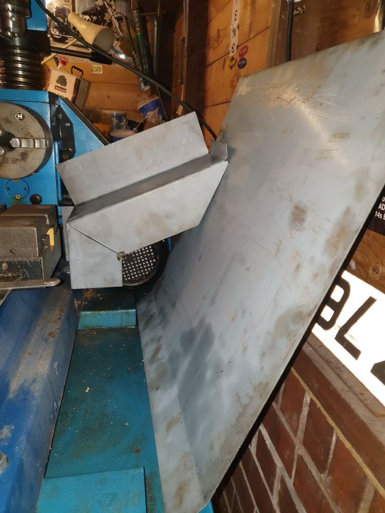

                          #544976
                          Danni Burns
                            @danniburns84841
                            Quick start
                            I'll cut that large lip of and will add a sheet at the chuck (to top of adjacent back piece) to hold it all together.

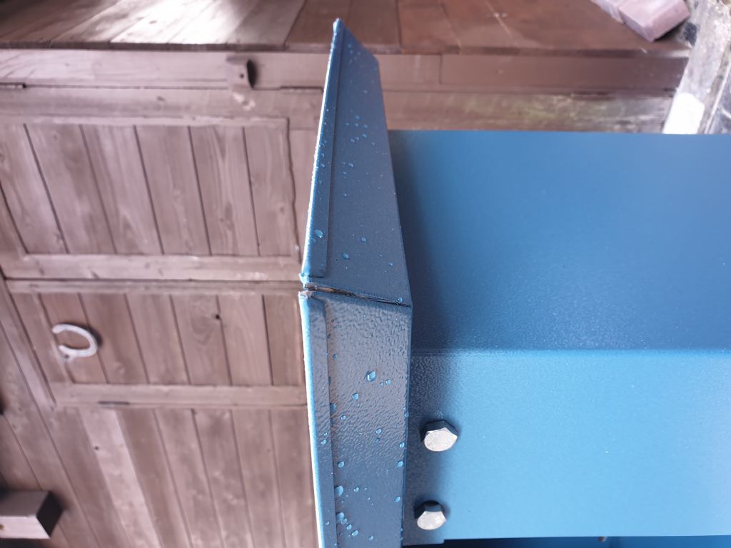

                            #544978
                            Danni Burns
                              @danniburns84841
                              BTW – below is a pic of a NEW Stand from Sitebox
                              Which is still in my shed awaiting collection 1 week later. Lets hope the machine is better quality than this shite
