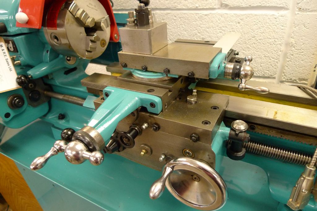

      Hi
      I am about to put a Newall DRO on my myford super7. I got the kit from Newall for the Myford, I get the feeling that the sadle lock is going to be in the way and feel that its probably best putting the lock at the front of the saddle. Can anyone point me in the direction of what's going to be involved into doing this before I start dismantling ??? or any information articles on moving the lock .
      Thanks Bob

                This is where Myford put the saddle lock when they installed a Newall DRO…

                  Andrew thanks for the picture very helpful not far from kwil's position I think Im going to try and copy this do you know id they used the same parts just re positioned.

                    Bob – as far as I can tell using a torch and mirror, it's the same arrangement as was on the back of the saddle of my previous ML7. That is, a thick disc of mild steel overlapping the underside of the shear with an off set tapped hole for the bolt. Presumably it sits in a counterbored hole to suit.

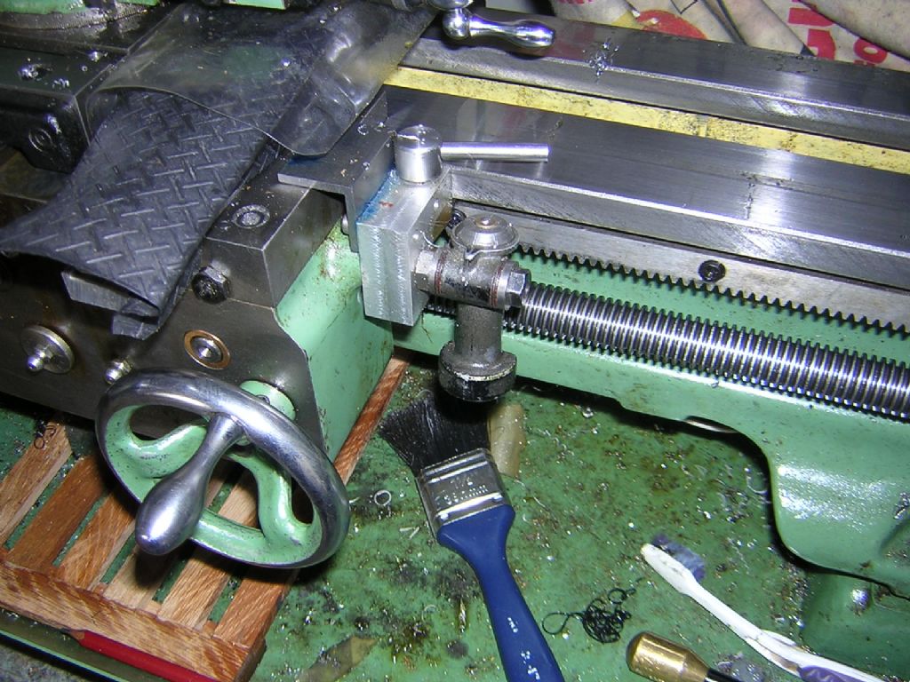

                        @terryd72465
                        Posted by Bogstandard2 on 11/03/2012 09:51:55:
                        For those who own the more popular far eastern machines and come across the same problem, here is my way for fixing the problem.
                        http://www.atfreeforum.com/chesteruk/viewtopic.php?t=389&mforum=chesteruk
                        Hi John,
                        The provider at your link appears to have gone offline, do you have another source for your mod?
                        Best regards
                        Terry
