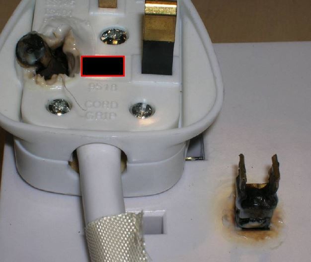

              Here is example of a melted 13A plug taken from this report by the Electrical Safety Council:
              **LINK**

                After all that clever redaction … They forgot to do the barcode on the bag.
                ROFL
                Praise where it’s due though …
                That’s a nice thorough report, and should be a warning to us all.

                  Interestingly the report linked to by Roger B used a load current of 20A on leads clearly marked as 13A maximum load. This is an abuse load and seems to have been carefully chosen to be as high as possible without causing a 13A fuse to fail quickly. While a 20A load could clearly be applied to these leads, its a very specifc case. What is clear is that you should not allow plugs to be covered by anything flammable like paper or cloth.
                  It;s also clear that the hard thermoset plastic bodied plugs are safer. They also end to give off a distinctive smell if they are overloaded.
                  Robert G8RPI.

                    I have always used a well known UK brand, moulded from a very hard thermoplastic, Multi Kontact. I am surprised that the test refered to did not examine the internals of those cheap 4 way boards, the use of flimsy metal is an understatement.

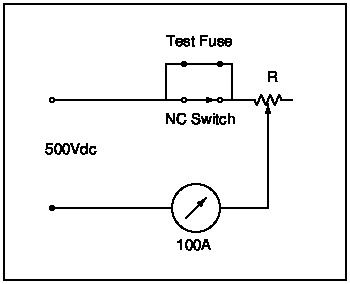

                      I came across this exciting circuit for testing fuses in one of my old books:
                      With the switch closed so current bypasses the fuse, rheostat R is adjusted until the ammeter reads 100 Amps. Then the fuse is tested by opening the switch.
                      As 500V × 100A = 50kW, the test fuse is likely to explode and arc. The purpose of this extreme test is to confirm fuse designs can deal a gross overload without the fuse itself causing a fire.
                      Don't try this at home folks!

                              Posted by SillyOldDuffer on 01/04/2020 09:33:06:
                              What was the book? That is not a practical test. The 50kW is dissipated in the variable resistor, not the fuse. All the fuse sees is 100A and 500V, either of which could be applied indendently. The critical test for fuse explosions is maximum breaking current which can be thousands of amps even in domestic situations. Typically applied by a capacitor bank, fixed resistance and a large spark gap (or possibly a solid state switch given capability of modern devices). The diagram looks like something thought up by somone with no practical experience, or a gross simplification. You would not use a DC supply unless specfically testing DC fuses. If it does arc you can't stop it easily. With AC in a test like this, any arcing stops at the zero crossing. With a capacitor bank (DC by definition you have a controlled energy limit.
                              50kW variable resistors do exist, I've used one for testng aircraft ground power units years ago (it was old even then). It was a trailer filled with what looked like slates, but were carbon plates, ther were 6 rows (3 phase, two rows per phase) 6 leaf springs, and a big acme thread pressing on the centre of the springs. you adjusted the resistance by varing he pressure, an effect unique to carbon afik.

                                            The book is from the Electrical Engineer's Data Books series. It's Vol 2 of 'Manufacture, Design and Laboratory Work' by D.V.Onslow A.M.I.E.E
                                            Not claiming it to be industry best practice today – it was published in 1925! Onslow is quoting an E.R.A specification and it's in the section dealing with the electrical properties of Asbestos.
                                            Although it contains bygone advice, and is built on long gone standards like the 'Home Office Regulations on the Use of Electricity in Factories and Workshops' much of the book still makes sense. It reveals a world in which huge progress had been made, but still had many quaint hangovers, like DC mains. Another colour code example:
