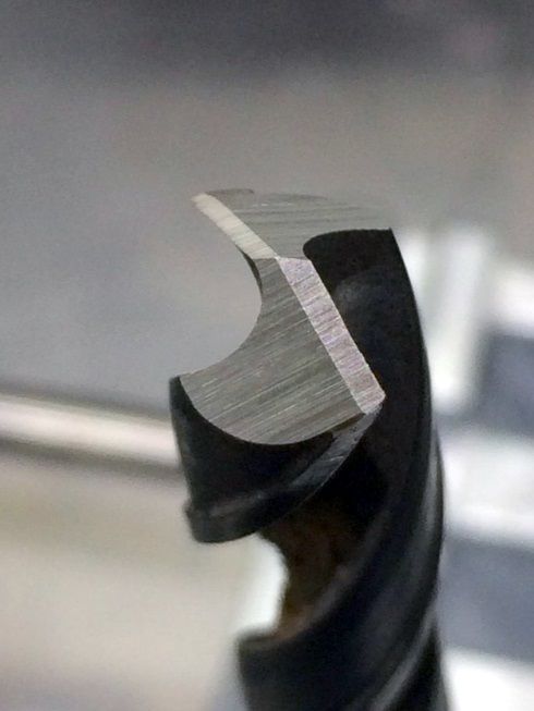

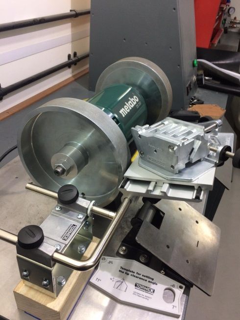

      Fitted CBN wheels to my grinder. They are fantastic!
      Vid link. https://http://www.youtube.com/watch?v=E52tFkpVt5k
      Also bought a Tormek drill sharpener.. another great bit of kit too.
      My first attempt at a 4 facet cut on a 10mm bit.
      Dave.

          That sharpened drill looks very good Dave, how does it cut when drilling a hole?

            Haven't used that one yet but I did an 8 mm one and that cut perfect.
            Lots of equal cone swarf either side etc. It is very easy to use.
            Dave.

                Drill sharpening an art which as always alluded me ! Yours look good.

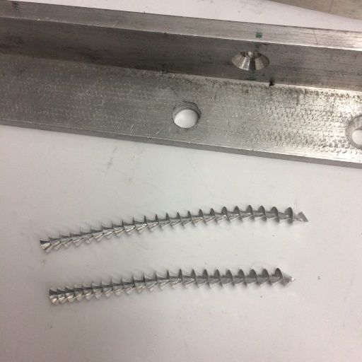

                          Don't know what happened to my drill pic so here it is again.
                          Also..
                          Ground a 9.5 mm cobalt drill to 135 deg + 7 deg primary and 20 deg secondary.
                          Went through 6mm alloy angle like it was plastic. No pilot hole just a centre punch and some cutting oil.

                            I have a home-made tool grinding platform, with multiple angles, etc. that I use for lathe and other tooling. I am also nearly there with a milling tool holder to do the tips.
                            But I have never sorted out a jig for drill grinding and I tend to just buy in more Dormer A002 four facet drills, which are the best for all sorts of work. So this Tormek DBS-22 interests me as it produces the four facet finish. It costs £184 from Tyzak. Hmm, that is about 30-40 new drills of typical sizes. At my current wear-out/damage rate that is perhaps ten year's worth.
                            I was never keen to follow up on the many improvements on the 'sweep tool' for a conical grind that have been in many editions of ME/MEW. However, I cannot recall any magazine article describing the construction of an attachment to do exactly what the Tormek DBS-22 does. I seems straight forward to make and just needs the angles described for the facets. Did Harold Hall describe something? or has anyone seen it elsewhere?
