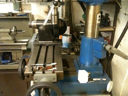

              Thank you very much for replies.Duncan just to verify was your machine identical to the one in the picture and if you moved it up or down with handle it lost alignment?Do you know were I could get more info?img_1070.jpg

                The one pictured, with the handle on the right and fixed in the base, with the rack fixed to the column, should not loose its register when raised/lowered. It requires a hole in the bench underneath it for the column to drop through when it is lowered.  The head is fixed on the column and they move up and down together.
                It is those with the handle on the left of the head casting and the rotatable rack that wobble about when the head is moved.   On these the column is fixed and the head rides up and down on the column.

                    The head desn't move much when you raise and lower, but more than would be acceptable if you wanted to carry on machining something without re-establishing the datums. The laser pointer idea has been around for some time, according to a friend of mine it works well but it not as good as a proper knee type setup. Be aware that when dowfeeding with the quill you need to take up the backlash. I used to just use thumb and finger to keep the quill pushed up as I wound it down. There was an article many years ago about fitting a tensator spring to achieve the same effect, no idea where ot when

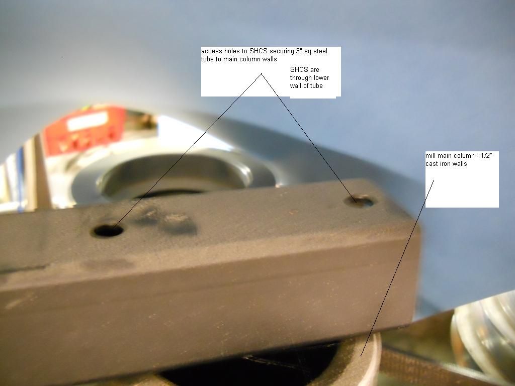

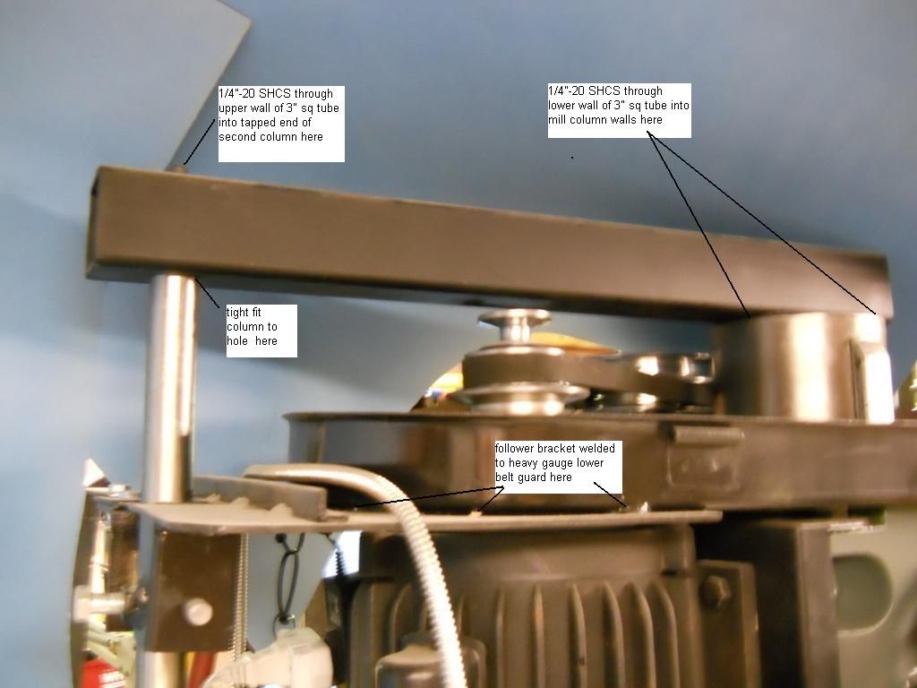

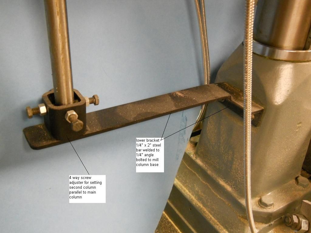

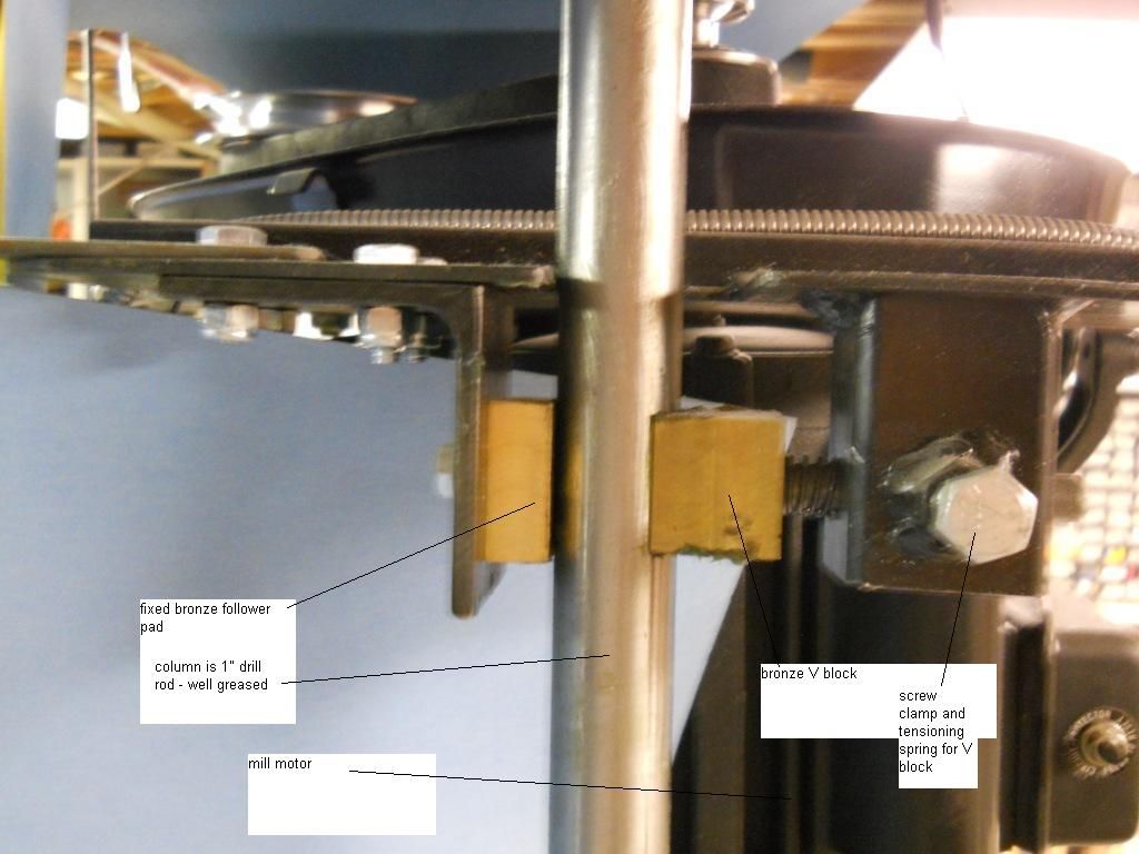

                        On my round column Rong Fu 9×20 Taiwan-built mill I added a second column to prevent head rotation during head lift/lower. If anyone is interested I can take some photos.
                        The second column itself is a piece of 1" drill rod. It is supported by screw-fastened brackets top and bottom with a four way adjuster screw at bottom to set the second column parallel to the main one, behind the motor. A carriage bracket with bronze V block and screw-adjusted bronze follower pad was welded to the upper guard sheetmetal (heavy gauge) to steer the head. The V block and follower ride on the second column. Simple to build and use, not in the way of anything, can be easily dismantled/reassembled should I need to swing the head to some angle for an unusual setup. Construction does not need to be overly heavy as the second column is only an alignment device and does not see cutting loads. I unclamp the head from main column, move it, then re-clamp before cutting. No clamping is done on the second column. For getting it parallel I used a machine tool setup theodolite borrowed from a toolmaking firm I do work for. With care, a scale and plumb bob wire could probably be used to get the second column parallel enough to main column, My second column setup has worked fine for over 15 years, did not cost much to build, and is space-efficient. No dependency on stability of nearby walls, wall markings, battery life and diode life, problems that can happen with laser pointer based systems. JD

                          I'd like to see a picture Jeff if you get a minute.

                                  Hi Vic, here's a few photos of my second column, Top photo should be last but I can't figure out how to move the photos in the post. Oh well, you can get the gist…. JDdscn1550.jpgdscn1549.jpgdscn1547.jpgdscn1545.jpg
